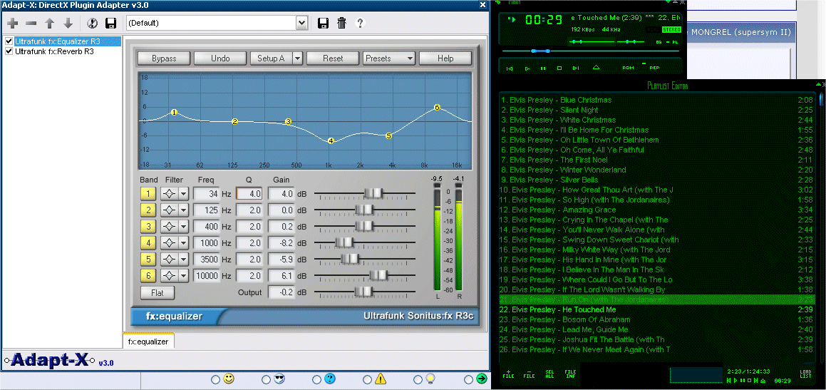

Now this is surprising , also brings up a great debate. Do we want something added to our music by the amp ?? On the AX "blameless " I listen to now , I can add just a little bass to make it sound like carlo's "ES" (pix 1).
I did a little "blind test" today. I took me screwdriver and adjusted my tail current (ltp) to where i thought it sounded best. I then measured across my 2.2k tail resistor to find 8.8v 8.8/2200 = exactly 4ma !! I then did a LT FFT with stepped tail currents at 1k/10k , especially at 10k , the H3 dropped by 15db with increasing tail current. Best was 2- 2.2 ma (4- 4.4ma total). How did this happen ?? I just turned the trimmer and heard it sound better and stopped. Could I actually hear this? 😱 And I thought amps all sound the same. 🙄 Both the scope and LT show perfect linearity and ppm THD across the whole range of the "CCS adjust" (2ma - 5ma) , but 4ma sounds best.

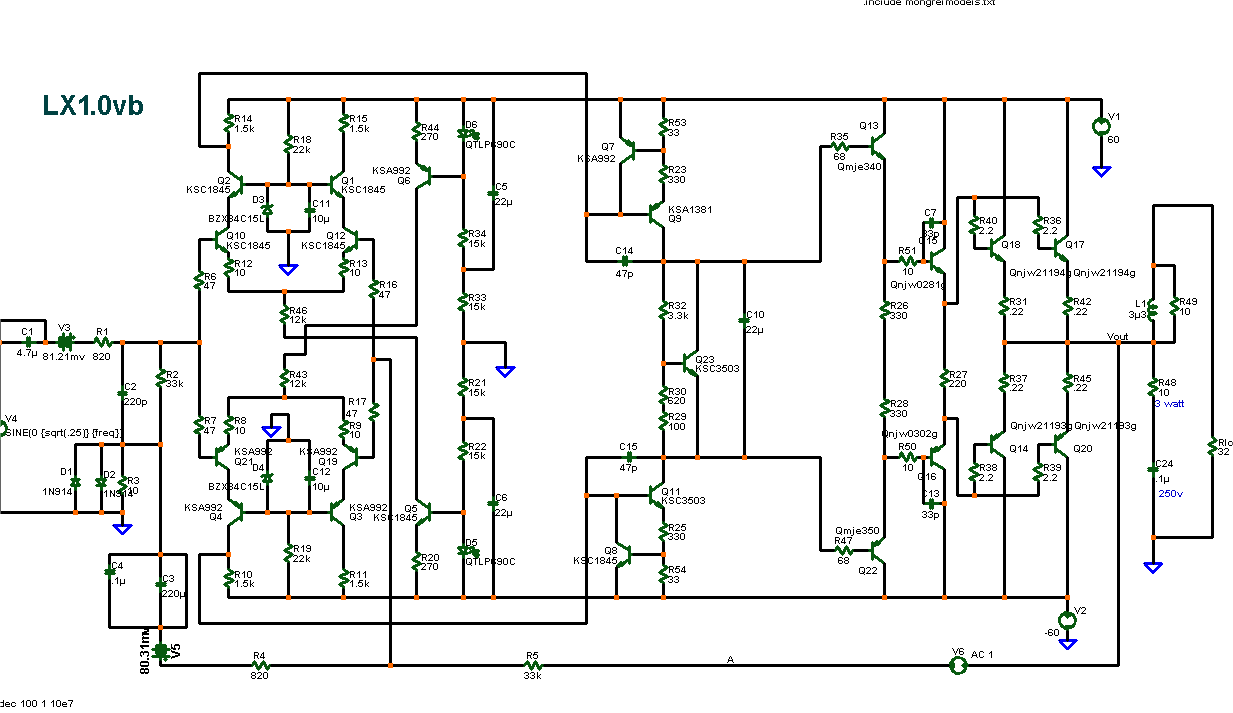

My preamp is still in the imaginary mode. That can change rapidly around here If I get in one of those "building frenzies" . I'm going to do the strait "leech" (below 1)topology first before that "halcro thingy" I posted. To go with that , the PS50 (50kuf - smaller power supply) and my new stereo OP board are being designed/built now. 😎
I worked on carlos's ES/ (BX) that I have. Changed a few degeneration resistors , fine tuned the currents in the input stage and VAS. It really sounds nice now , so close to the AX. Better bass with the BX , better highs and slightly better imaging with the AX , STILL , almost too close to call as to which is "better" :hypno2: .. even with "mountain ears". The BX with the 200w Op stage is SO loud , but clear... even with complex source material.
Does anyone know the best way to implement an DC offset adjustment on the below "leech" topology ?? please do comment...

Pete,
I'd work on the CCSs supplying the input stage. Simply disconnect junction of R21 and R33 from ground, connect to an integrating, inverting opamp with 15V rails. That should do it. You should have a reasonable variation of reference voltage off the LEDs in the CCSs, but if you don't you can always add a 15R resistor in series with each LED.
Nice and remote from the signal path.....
Hugh

So , just a simple adjustable ground reference for the 2 CCS's ?? I want a IC free design that will be easily integrated to the capacitance multipliers of the mongrel pb250/120. You were right about "character" .. the bootstrap is becoming my favorite of the 2 blameless varients. I also have found another "secret" in how to deploy nested feedback to a bootstrapped topology. It's all about the sound... 🙂 , isn't it. The journey continues.. even as some say there are no differences , I say B_$.
OS
The best way is what Hugh suggests, driving the bootstrap IS A BAD IDEA (many commercial manufactures use this INCORRECT way, messing the sound at low spectrum), you will inject a spurious signal in the input path. It could be even more worse if the biasing signal is inside de audio BW (it could make your amplifier a subsonic oscillator). It is a MUCH better way to bias the current at the input CS's. You could manage to do a transistorized integrator but it will not have the precision (nor thermal stability) of a fast IC ie: LM318 that will set the DC offset below 1mV, without messing audio.

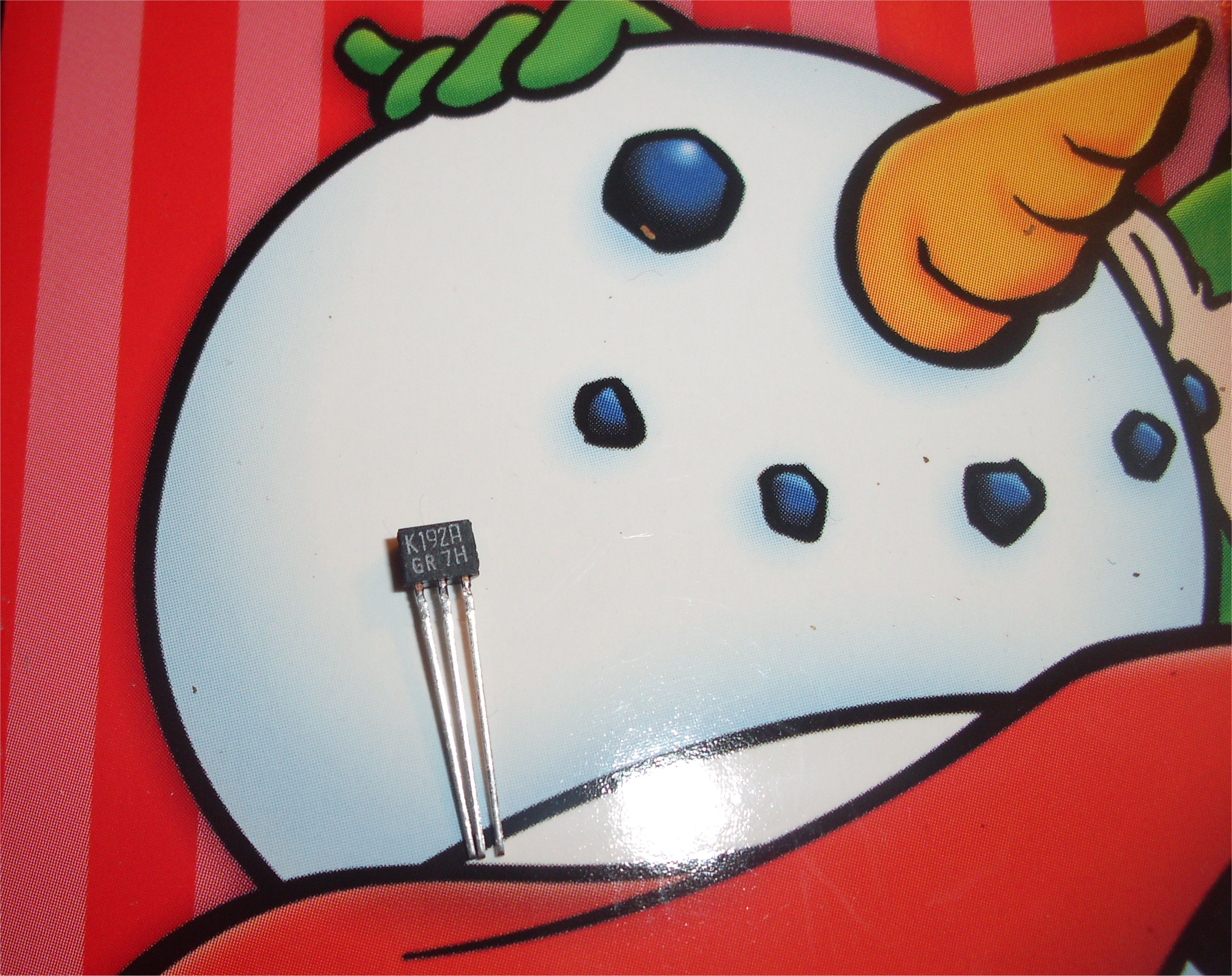

BJT's are cheaper , easier to source , and are just as good as the JFET. I tried the K192A's I have (below) and they needed 22r degeneration to match the Bjt ,sounded exactly the same and were more of a pain to match. They worked very well , but at 30-40c apiece, why bother ??
I am still educating myself .. if any of it enriches others , cool !!
BTW , I am using MPSA18's and SS9014's , both are VERY quiet .. much more than 2sc1845's or BC556's. SO , my BX is at least 6-10db quieter than an ES , the only drawback is the need for a cascode (2 more devices + 1cap / 2 resistors) ... but that also allows for very high rails as well (70-90V is BX's max). 😎

Pete,
You can dispense with the IC if you wish, but the servo adjustment, using a single transistor, will act on one CCS only. Run a 15V zener supply off the negative rail to handle about 10mA. Then place a 4K7 resistor in series with a 5K trimpot from the zener anode (the -15V supply) to the emitter of a 2N5551 npn device. The collector of this device is connected via one 15K resistor to the positive supply CCS LED, and the existing cap to the positive rail. Now the base of the device is connected to output via a 47K resistor, and to a 47uF cap to ground. This is the integrator. Adjust the trimpot for correct offset and you are away....
Hugh

Could you draw it , hugh ? Or show an example ??
