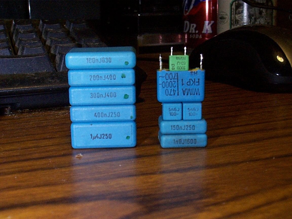

how did X2 appear in the link?
The datasheet makes no mention of X2 rating and goes on to state <=250Vac rating. This is not X2.
Neither of the pics shows an X2 rating on any of the caps.
where does it claim snubber duty?Those are snubber capacitors! No way those could be good coupling caps, right!? haha lol
On the contrary, design for high-frequency pulse operation at hundreds of volts should make these caps excellent.
With a maximum of 200V/us these can be bettered by many others for good pulse operation.
OS, I just switched in one of those 5n6 snubbers for compensation in my headphone amp, it sounds much cleaner and natural, with a better soundstage. This is a change I'd definitely recommend.
The type used is a Rifa Evox PFR, non-metallized polypropylene film.

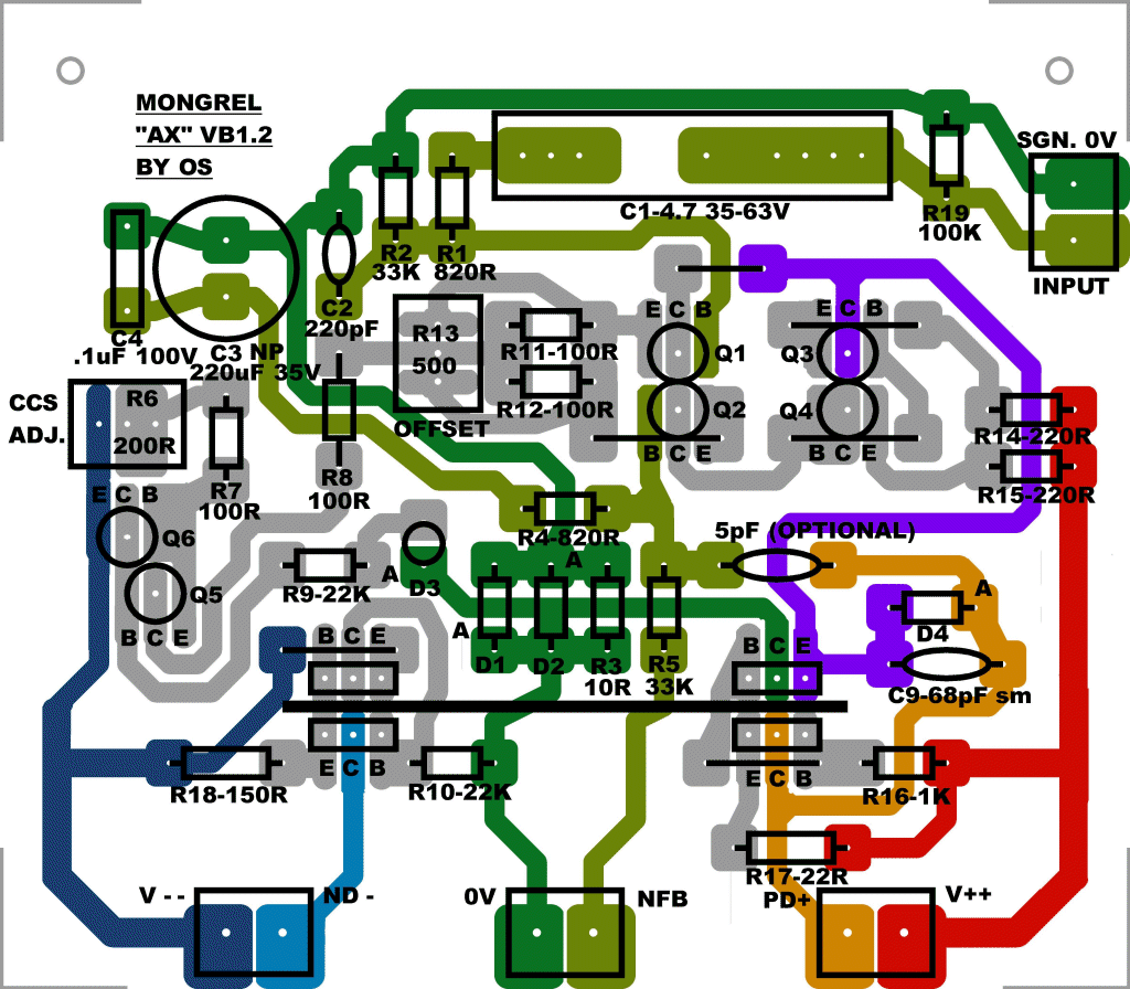

I've looking at a 6/12 output Mongrel so looking at the easy ways to do this, we have both OS's and Alex MM PB250 to look at.
One question on Alex's design, there looksto be no diodes between the rails and NFB (D98, D99 from OS's PB250) and the 22uf caps have been added what affect would these two changes have?
Is there any benefit in adding these caps to OS's design?
Alex would you be OK if I take your board layout as a starting point for a 6/12 output version and post the layout?
Rob
Hey , rob ... The PB250 is VERY good , I was running 2 pair 8R loudspeakers ALL day at very high SPL without the board even breaking a "sweat" . With a 600VA trafo and 70-0-70VDC supply the dynamic range of this amp is breathtaking , even scary !! The D98/99 are flyback protection diodes for the OPS. I fried one of them when I killed my left channel , it saved a few trannies before it went.
Adding those little 22uF caps near the OP devices would have very little effect in relation to the big 4700uF devices on the 12mm thick power rail traces of the PB250.

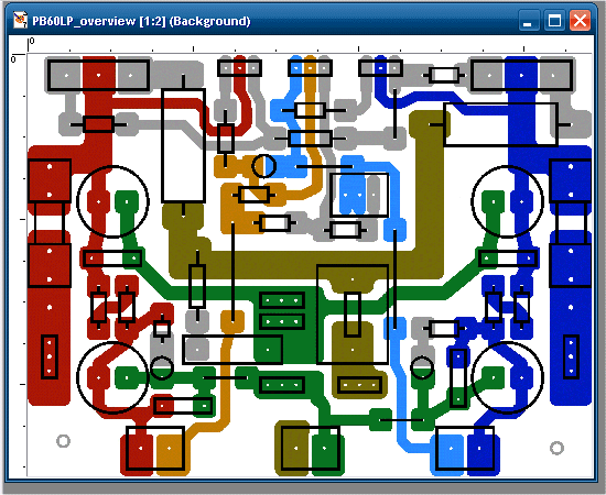

Keen , (below) is a preview of the NEW PB60 board you will get with the 2 AX's I will mail you. For me I also "remodeled" the AX (BELOW 2) ... same circuit , better layout , ALL mongrel boards are now 102 X 87 mm (3 1/2" X 4") with room for VERY large input caps. I am making the Mouser order now for 6 PB60's and my new PS100 CLC power supply .. I need a recap badly.. (below3).

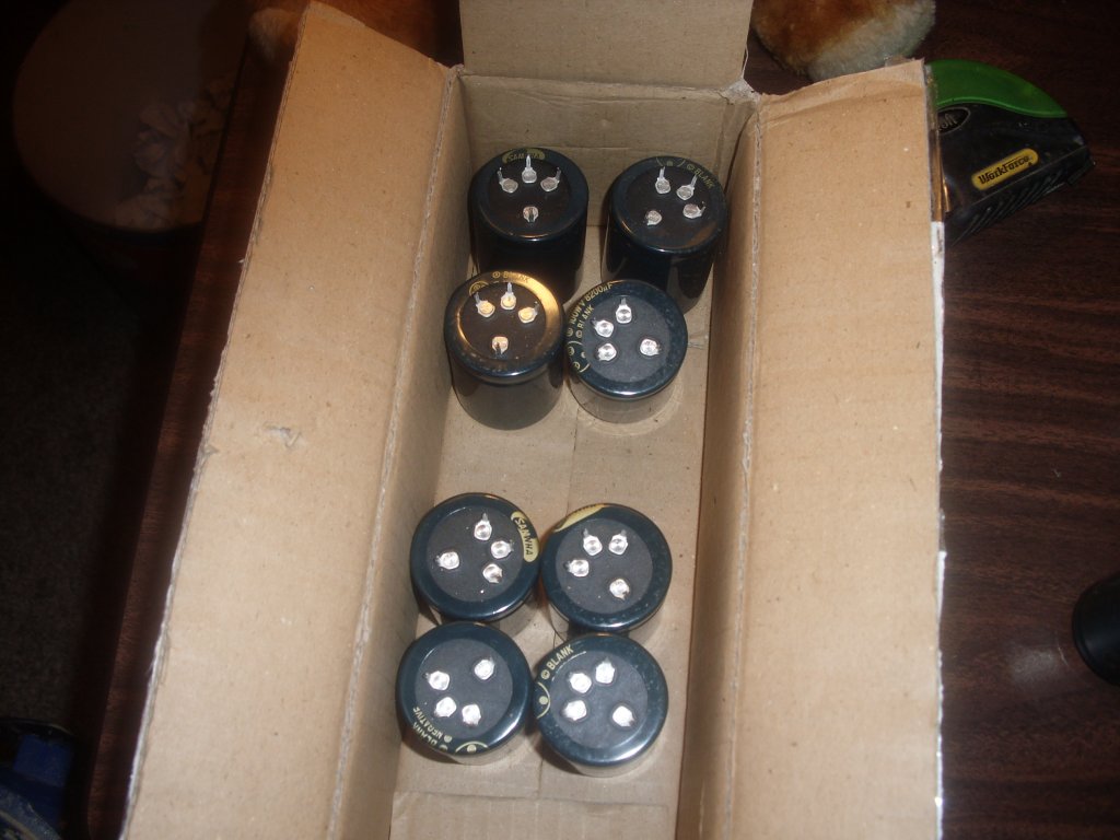

"in your universe" Actually, the trafo is 54-0-54VAC which gives no load 78v rails. My present caps , which came with the trafo , are not derated at all (80v) Commercial offerings suck. The new ones are SANWHA 100v 8200uF ,much better for the job.
OS

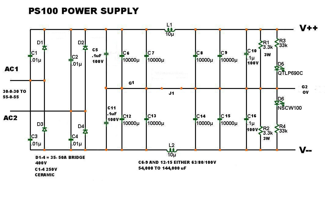

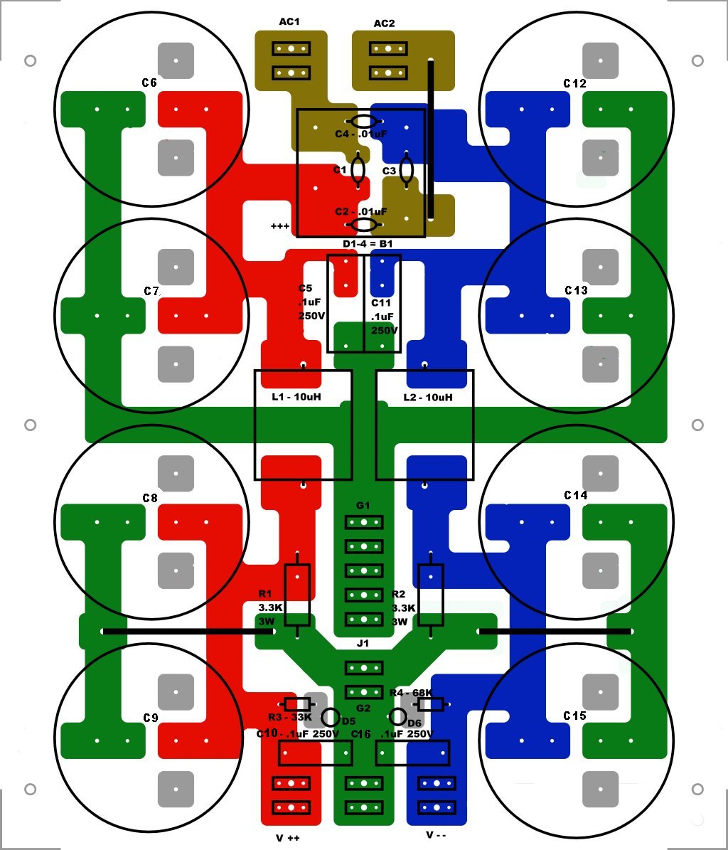

Those Sanwha capacitors were not only bigger ,but had a 22mm lead spacing/4 pin "footprint" , made me totally redesign the PS100 . The power supply board can now accept 10mm , 18mm , 22mm , even 22mm/4-pin capacitors. 40mm is the max diameter supported ...(mine). I suppose I had to "pay the price" for caps that were almost free (swap-meet). Total size is 6" X 7" (150 X 175+ mm) , more room for the inductors , more fastons , and you might be able to do 100kuf @ 100V if you have a load of money $$$$ (12k@100v = 25-30usd apiece.)
"PS100V1.2_complete.zip" is in the Mongrel folder , (below1/2) is the schema and new layout .. please inform of any errors.
OS
OS
Thank you, this is what I was asking for.Actually, the trafo is 54-0-54VAC
