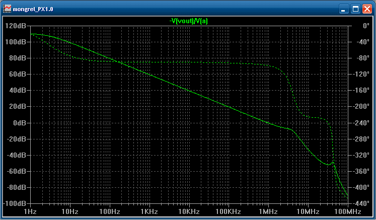

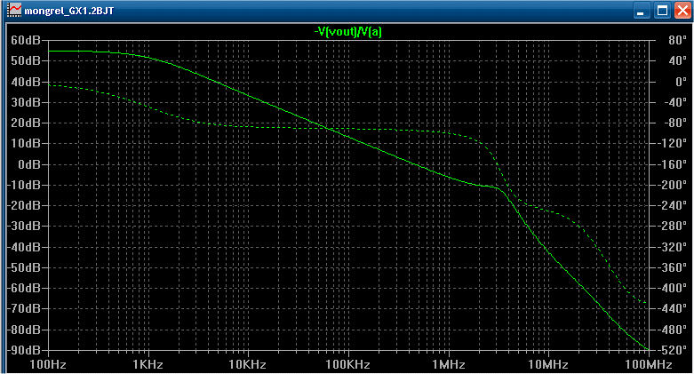

you mean the double hump ?? I usually just go out to 10e6 , at 10e7 I see. Is this even valid ??, the NJW OP's don't even have an Ft of 40 mhz. I might be worried if I was using IRF MOSFETS. As B. Cordell explained, they can oscillate above the freq. our cheap 20mhz scopes can even show.
BTW, the 40mhz "bump" is at -50DB AFTER the UG point. The 180 degree danger zone (oscillation) would not occur till 4mhz/180 degrees which is at
-10DB.
plot 1 is the PX.. plot 2 is the GX (it does not have this "artifact"). Maybe I should compensate globally (the 5pF) or even reduce the gain a tad (degenerate LTP2).

Anyways, without base stoppers there is a resonance spike above 0db on the OLG plot, and thus oscillation. This is why I go to at least several hundred MHz by default. Perhaps not guaranteed in the "real world", but it still matters... Even if in real life it's not the same, at least you will know what to do if you run into problems, after correcting them in the simulator.
-10DB.
OS
Okay, let me slobber over this bone for a bit...
The "bump" is caused by the Cob of the outputs (doesn't matter how fast the transistor is, slower is worse!!!). The problem is that the outputs are fed by a pure current source, just collectors. As such, the accumulated charge of the output Cob has nowhere to go, and builds up before the NFB can react. This why having pure current source-type VAS can be a bad thing. Resistors to ground at the OPS input helps, as in the GX. The 47pF miller caps on the GX also automatically control this charge by giving the OPS as low-impedance source at HF. Phase lead compensation also helps when referenced to the VAS output.
This isn't normally a problem for slower amps, especially those using miller compensation. But if we want to tweak OLG, it becomes important. It will ruin an amp with great specs. This phenomenon is not the same as that which requires the "charge-suckout" cap. The suckout cap corrects transverse charge shock between output bases, we need to correct for capacitive shock appearing between input and output of the OPS.
The best solution I've found is to hang a capacitor from the VAS output to ground. This cap absorbs the shock from the OPS, giving the NFB loop time to react. If a large cap is needed, it will destroy the amp's HF characteristics. The very low impedance of said cap can also cause it's own phase anomalies. For this reason I usually put a small resistor in series with it. 330p in series with 5 ohms is a good starting point I think.
It doesn't look like this is a problem with the amp right now.

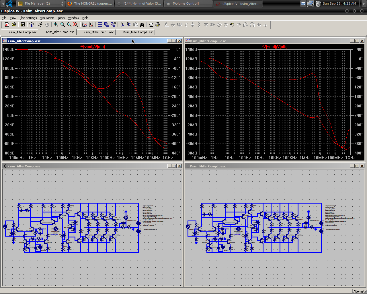

Here are two simulations. One uses your compensation and the other uses mine. Run the simulations as they are and compare FFT's, with mine high order harmonics are lower. I believe the reason for this is C7 (in attached schematics), which injects switching trash into the feedback loop.
Low order harmonics and THD increase, but higher order harmonics decrease.
In any case, if any connection between compensation and VAS output can be avoided, the same general thing will happen.

The next thing to notice is the distortion at 100Hz. for my compensation scheme, 100Hz distortion is nearly nonexistant, because of the higher OLG BW. However, distortion for the traditional scheme is .00043%, nearly the same as for 1KHz. The OLG plots below will explain why.
