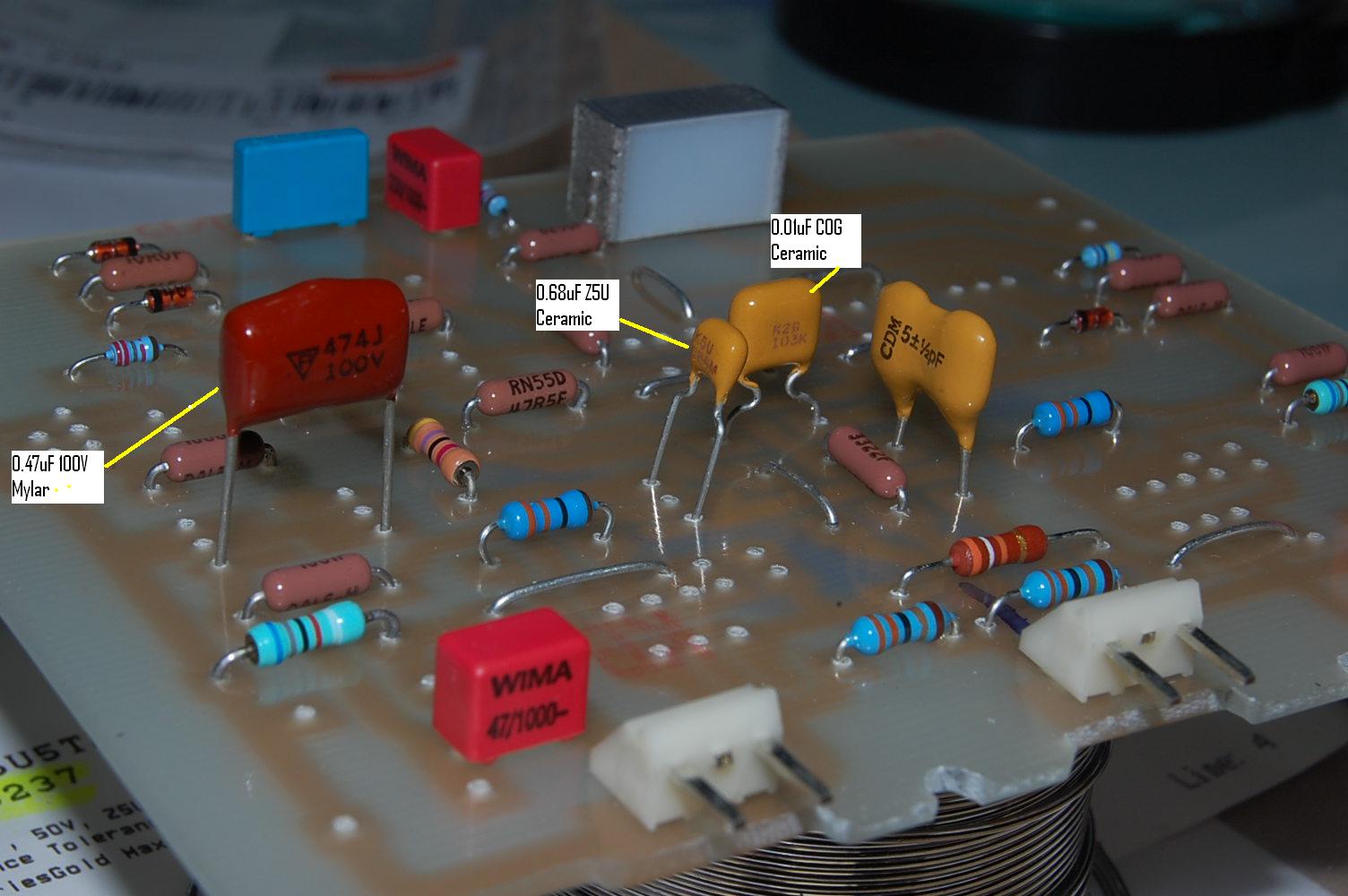

I finally received my parts from Farnell today. I found one problem with the 0.68uF ceramic capacitor that I ordered for C8 & C10.
Manufacturer: KEMET
Order Code: 1168237
Manufacturer Part No: C330C684M5U5TA
Description CAPACITOR CERAMIC 0.68UF, 50V, Z5U, RADIAL
Dielectric Characteristic:Z5U
Capacitance:0.68µF
Capacitance Tolerance:± 20%
Voltage Rating:50V
Temperature Coefficient:+22%, -56%
Series:Gold Max
The .68uF Z5U cap is smaller than 0.01uF COG and it look like a monolithic ceramic cap.
My question are:
(1) What is the part number for your 0.68uF ceramic cap?
(2) Is it critical to use multilayer ceramic in this position?
(3) Is the value critical for C8 & C10?
I found a few 0.47uF 100V mylar caps in my parts bin, I may give them a try if they are suitable.
Attached is a picture showing the relative size of 0.68uF & 0.01uF.
Cheers, Stanley

Hi, sng. I used the .68uf's as this dropped the HF distortion of the GX from .01% to .002% as the bypass of the hawksford's emitter resistors. Their value is not truly critical as the effect (lower distortion) "kicks in" after .1uF. Your .47's should do nicely. I used this mouser part... DME1P68K-F Cornell Dubilier Polyester Film Capacitors .
Voltage wise you could even use a 25v device as there is only a volt max across the Re of the hawksford.
I still plan further GX development (swapping parts or changing values) mainly playing with the "magic resistor" values (R20/24) maybe even jumpering them to see what the audible effects are. When I have 2 low power PB60's in the "lab" , I can go crazy with the mods. This will be better as I will not be experimenting on a 250w unit (PB250- scary power and voltages) , I feel much more comfortable with 45-0-45VDC and only 1 pair OP'S !! 😱
Don't worry , the gx is as predictable as a simple bootstrap amp , and as reliable. I have successfully tested it with .9 - 1.7ma tail current , 3- 12ma VAS current (using the trimmers). the powerboard Vbias has enough range to accommodate these conditions but always start with the ops underbiased. The absolute best way to fire these up for the first time is to run the driver pair with 2 -33R temporary resistors tacked to the out/NFB point , adjust vbias for + - .5V ... then install OP's.
BTW your .47uF is in the wrong place .. it is where the trimmer should go!!

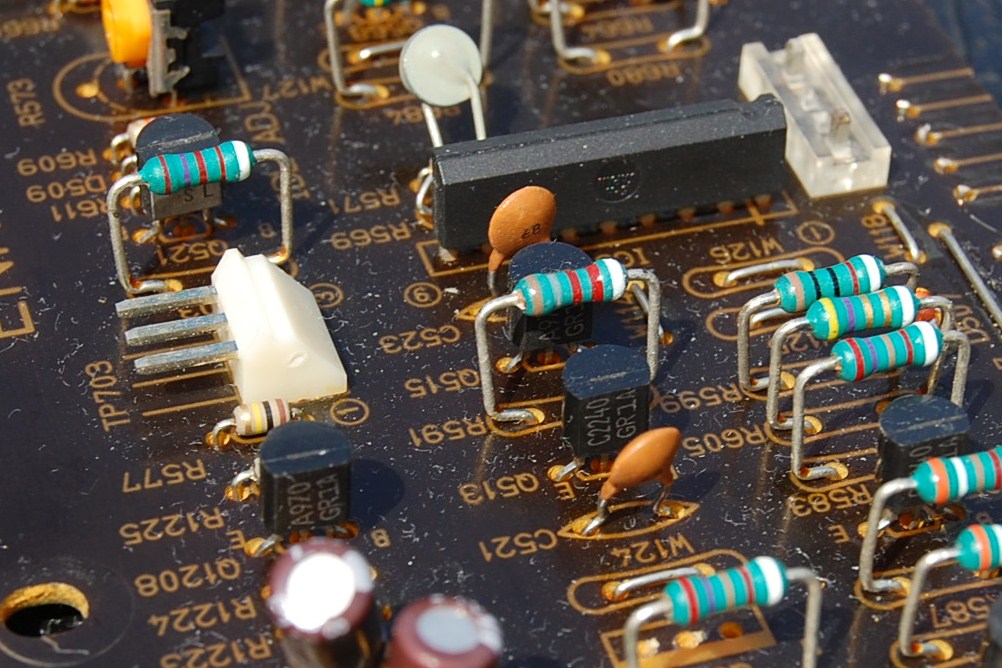

Thanks for the reply. I googled the Kemet part number, it is a multilayer ceramic (Z5U is less stable than C0G).
I salvaged the right-angle edge connector from the JVC amp. It was a 3-pin 0.1inch-pitch, I converted to 2-pin 0.2inch-pitch:-;
The closest replacement is molex 10-06-1025, which is still available on Farnell. MOLEX|10-06-1025|HEADER, R/A, SQUARE PIN, 0.2" | Farnell Australia , but Mouser does not stock this part.
The Molex 90121-0763 (Headers & Wire Housings 2.54MM CGRIDIII HDR 3P R/A SR SEL AU ), Mouser part number 538-90121-0763 may also be modified to fit.
I attached a picture of the JVC amp board, it was labeled as TP703 (Test Point), which fit for our purpose exactly.

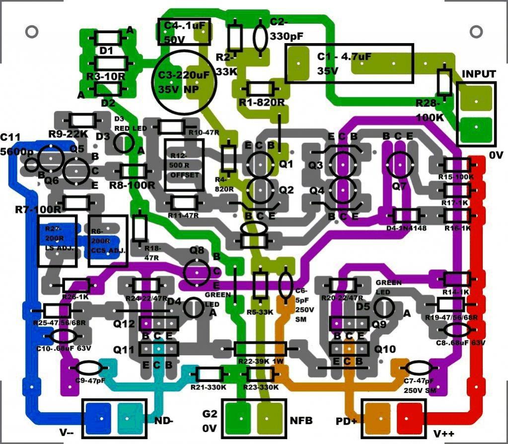

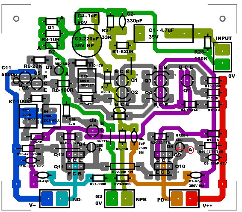

I found one error in the GX-VB overview. The polarity of LED (D5) is wrong, the anode of D5 should be connected to base of Q10. I found that out after power on the GX board, the D5 did not lit and that did not cause any disaster.

Using a + instead of "A" for Anode would be less confusing to some of us, who never learned the difference between Anode and Cathode.

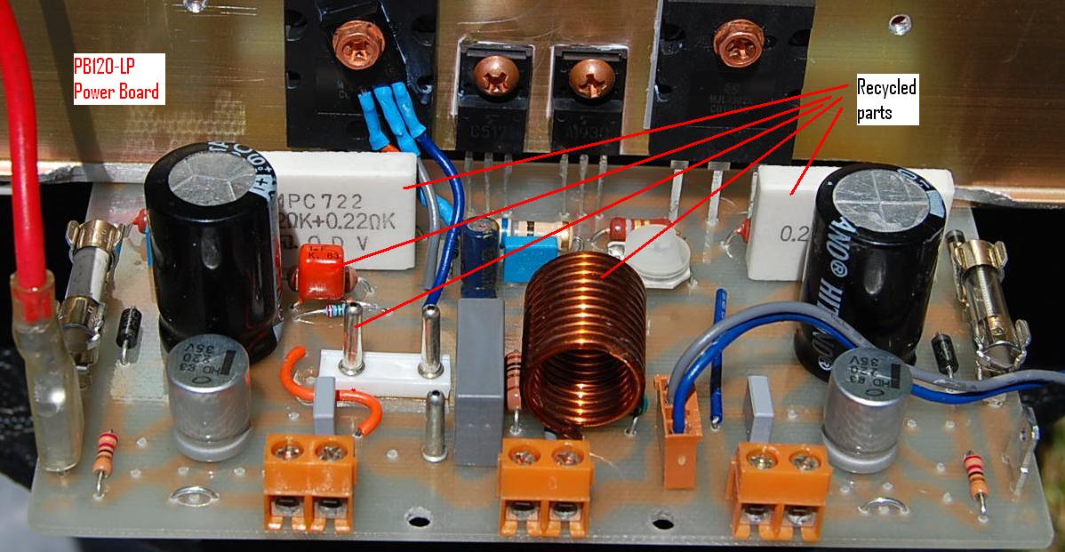

Recycle parts for GX & PB120LP

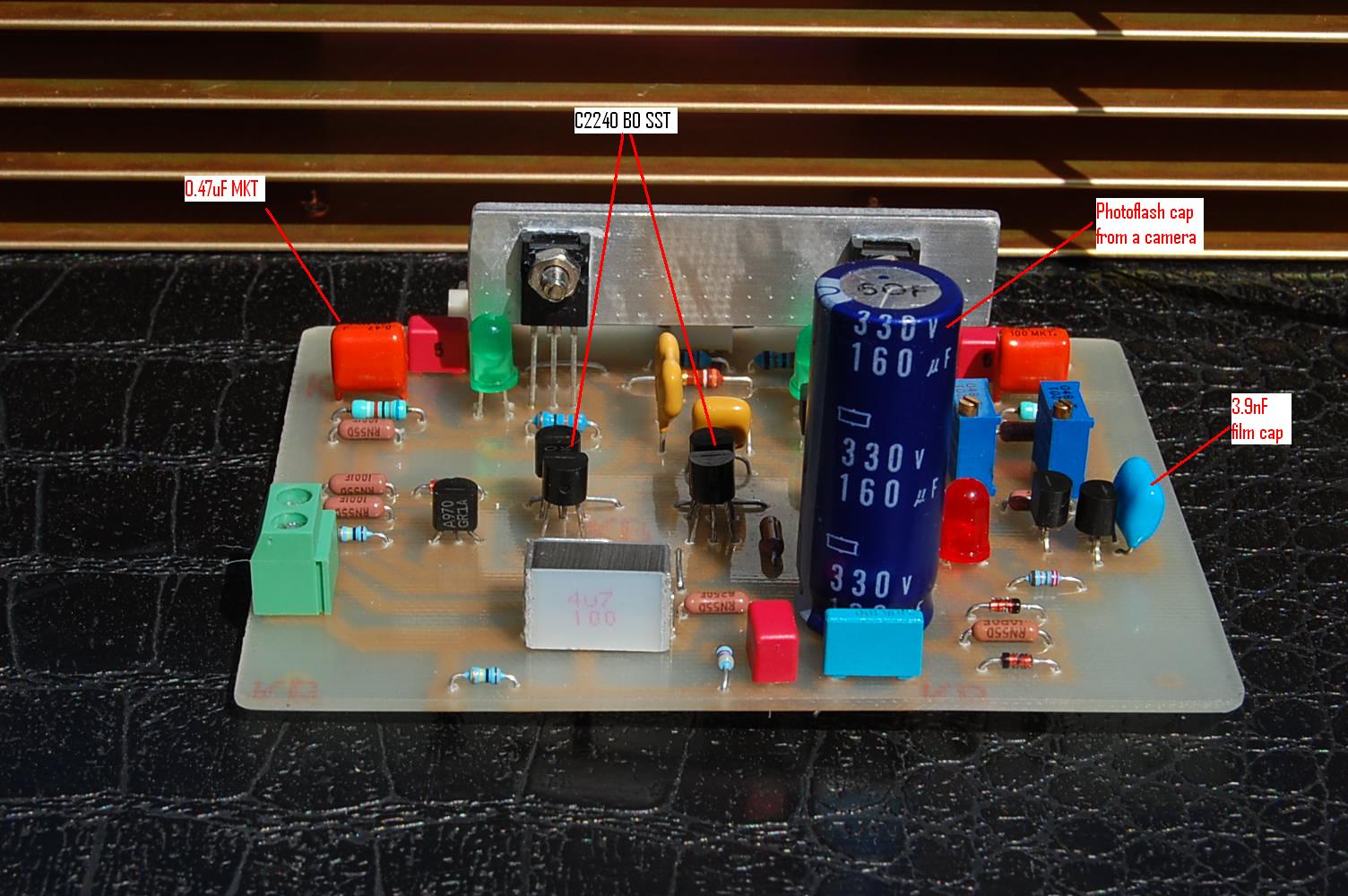

Hi Holger,
I used "recycled" 2SA970 & 2SC2240 transistors on the GX-VB. Four of 2SC2240s are B0 grade & they were Hfe matched at the factory.
I also recycled the output coil & the MPC722 resistors on the PB120, the MPC722 resistors are compact & non-inductive.
I used the money saved to buy some premium resisters;-)
Cheers, Stanley

Attached is the overview so we speak of the same adjustments.
OS

Hi OS,
You are a champion, the problem is now solved. I used the R27 (the one closest to the edge) to adjust the CCS and of course that did not work - stupid me.
I have done the proper CCS adjustment and I am listening to the GX amp.
The VAS current does not follow your prediction.
Voltage across R8 = 0.255V (1.275mA per tail)
Voltage across R20 = 0.200V (VAS current = 6.06mA)
I am now running the following settings:
Voltage across R8 = 0.290V (1.45mA per tail)
Voltage across R20 = 0.213V (VAS current = 6.42mA)
So I am running the recommended VAS current but with a slightly higher tail current.
Cheers, Stanley
Consider , with 3ma total tail current = 1.25 /q1 and 1.25ma/q2 + about .5ma to power the cascode Q3/4.
Also , VAS current 6.5ma through the main emitter resistors(r19/25) equates to about 4ma through the transistors (Q9-12) and 2.5ma through the LED's.
OS

I've looking at a 6/12 output Mongrel so looking at the easy ways to do this, we have both OS's and Alex MM PB250 to look at.
One question on Alex's design, there looksto be no diodes between the rails and NFB (D98, D99 from OS's PB250) and the 22uf caps have been added what affect would these two changes have?
Is there any benefit in adding these caps to OS's design?
Alex would you be OK if I take your board layout as a starting point for a 6/12 output version and post the layout?
Rob
Rob

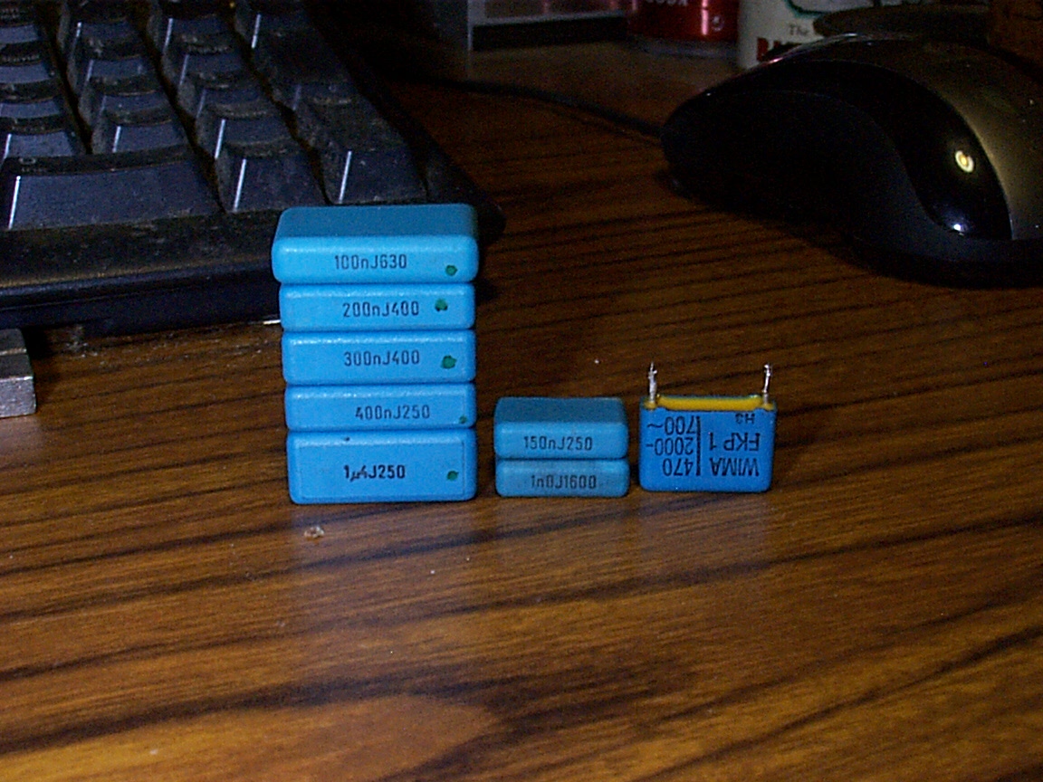

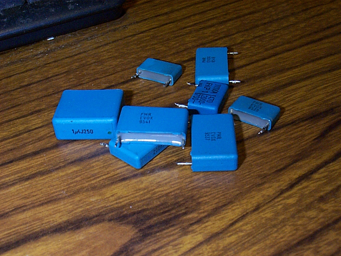

PMR is another acronym for Metallized polypropylene.
Got a bunch of these out of an old Apple computer monitor.
1PMR-100nF/630VAC EVOX RIFA Class X2 Case Capacitor
What!? Those are snubber capacitors! No way those could be good coupling caps, right!? haha lol
On the contrary, design for high-frequency pulse operation at hundreds of volts should make these caps excellent.
- keantoken
- keantoken
