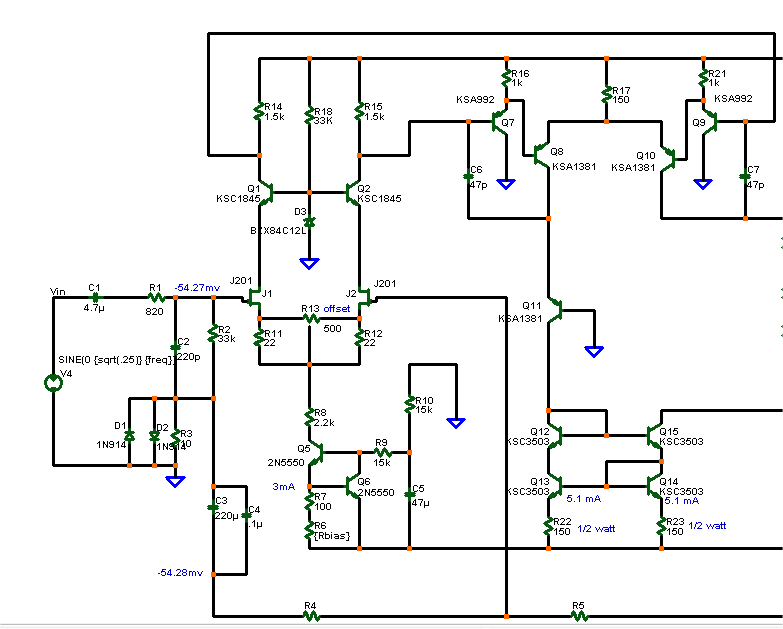

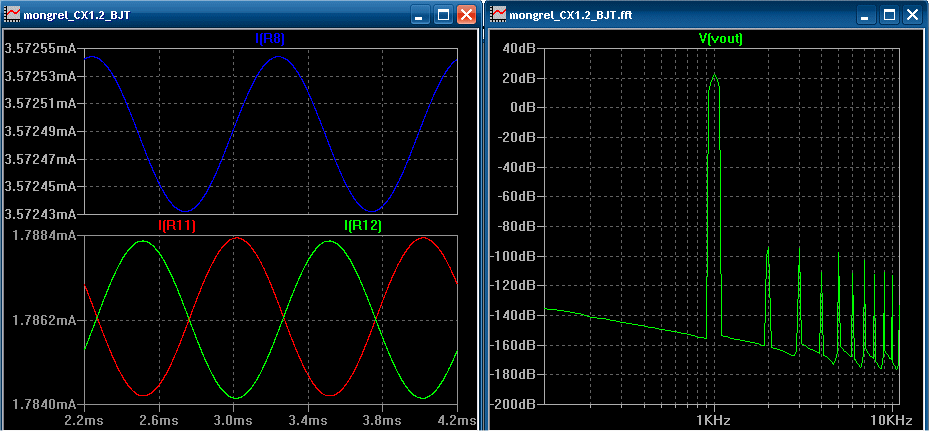

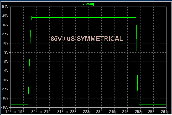

Been a workin' on the 2 best designs I have run into lately. That is , designs that are affordable and approach PPM levels (almost - hundreds???). I must thank Nico Ras .. his "ELD" and the two crazy "goldmund" threads for "triggering" this.

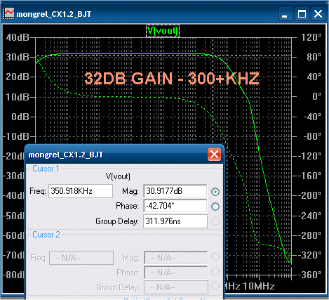

Now , down to business. My goals for the CX's were to :
#1 - have 60+V symmetrical slew rate ,#2 - Have a high bandwidth as well (200k+ / -1db) , #3 - use the goldmund front end but not have it cost an arm and a leg , and finally , my favorite .. #4 - THD as low as it will go... plus dominant H2 for what distortion is left.

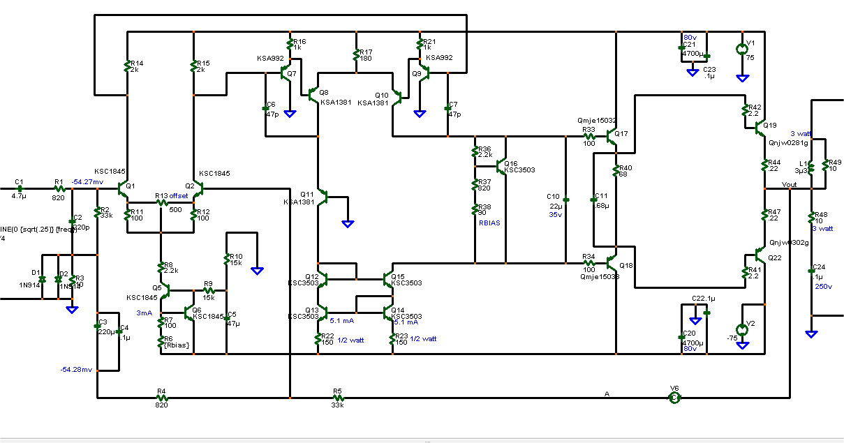

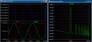

What I have come up with to address these design needs is relatively simple. (Picture 1 and 2 are the CX1.2BJT / FET).
I was going to use the current mirror AND the beta enhanced VAS but could not degenerate the stages enough to keep my loop gain under 125DB !!! 😱
The "core" amp, (the CX/ BJT) works with a typical input differential, heavily degenerated,feeding the beta enhanced balanced VAS which uses a high gain full wilson current mirror at it's "bottom end".

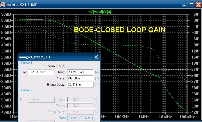

Even without the input stage current mirror I get 300ppm THD / 1k , 80db loop gain and a sweet -110db - -125+db FFT (very low high order harmonics)
(PICTURES 3/4 bode and FFT) All in all ... a VERY "transparent" amp. 🙂 PS - I did run the FFT with a single pair BJT NJW0281/0302 pair @ 75mA !! Still VERY good.
We love the very fast slew , with a 4 V square wave input I could swing the whole 150 volts of my rails in 1.2uS ! (120v/us) This was with 33pF miller compensation. The amp still has over 85 degrees margin at this speed , so it would most likely be very stable ( same as my slower GX). (PICTURES 5/6) are of the slew (about 70V/uS with 47pF millers) , and the bandwidth while leaving the input filter in place ... it would be higher.
COST $$$$$$$$ .... this amp, parts wise... is very low cost .The J201 Jfet is currently $0.41usd at mouser , the 1845/992's are a hefty $0.20/0.08 usd and the 1381/3503's are a WHOPPING $0.29 apiece. In otherwords , a pair of CX's can be made for a whole $20... oohhhhh!
Before I forget , the CX voltage boards will operate with 40-80v rails and can be used with BJT , V mosfet , or lateral mosfets. If somebody could help me design a lateral board with split supplies , a goldmund "killer" could be quite easy to pull off. 😀

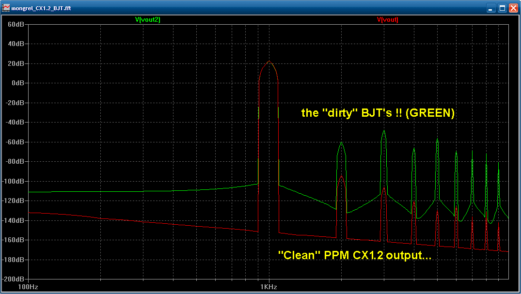

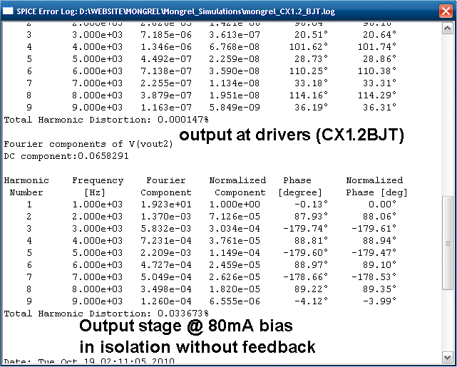

Let me show you.....
(Picture 1 ) shows the CX output (.0001%) with it's cool -120db+ harmonics and how the OPS lacking any global feedback bring this up to .03% with a lot more H3. 🙁
(picture 2) is the actual comparison (overlay) of the 2 outputs (drivers / OPS).
Now , the genesis 50W class A does not do this and has just .0004% distortion with no feedback. Laterals are also more benign in their odd harmonic "contributions" to the mix. I would lean in their direction for a no GNF output stage.
OS
I don't want to operate ClassA.
Even the CX without global feedback looks pretty good at only 0.03%. How readily do you think this would be achievable ? The front end can address the relative balance between H2/H3 for those who care about such things.
Why do you feel BJTs are worse than MOSFETs - is this beta droop that drives H3 ?
you got it , the lateral's large capacitance has a different interaction on the driver pair than the pure transconductance of the NJW's. I have tried the IRFP240/9240 on these creations , much less H3.
Achievable ???... already there , man. I listen to the GX/(or CX) without the OPS through headphones , breathtaking!! the NJW's WILL do .02-.05% without feedback , no question there. That is why they are so easy to to coax to .0005% or below in a GNFB setup.
This is why I need a MOSFET "testbed". 🙂
The CX should be flawless , almost no THD (ppm) in isolation("flirts" with the noise floor). a perfect driver/voltage stage for a ppm class A power stage or low THD AB creation.

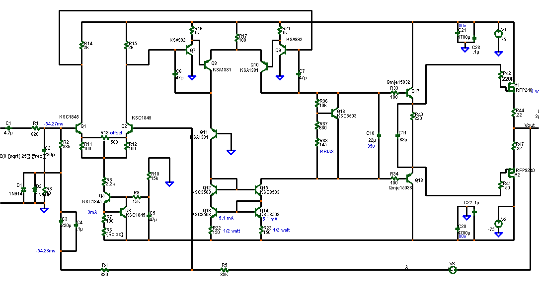

Hi OS,
At what currents are suggesting biasing the 240's and 9240's and will you be using drivers?

The IRFP240/9240 are "hardcore" V mosfets , bias them at 200ma ... they don't care.
I did take a pair of the original genesis IRFP's and power them with the original "supersym" voltage stage.... worked well!! (below) pay attention to driver Re (220r - R40) and Vbe ratio (10k/680-145R ..R36-38).
I got 350 PPM @ 1k 40v p-p with this one.!!🙂
