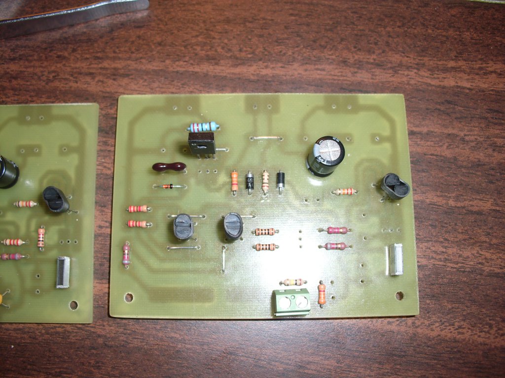

PCB file for the PB120LP v2.0
Hi OS,
I have incorporated all the improvements that you suggested earlier. I put together the PDF file for the PB120LP.
Can you please put the attached file onto your web site as this version is an improved version of the PB120LP-45V.
Cheers, Stanley

VERY nice. It's on my site. I DL'ed KICAD. All you do is draw out schema and it makes the board?? how do you import new components into the library. I have a lot to learn.

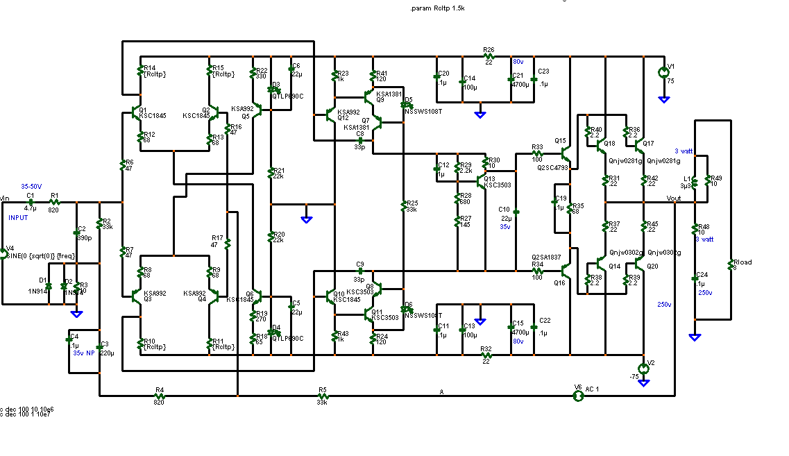

I HAVE decided , my november amp will be a fully complimentary design. The EX (attachment 1) has the FASTEST slew of them all (way above 120 V/us). That might not matter .. but what the hell !!! I am using a modified Hawksford similar to my GX but it has a beta enhancement feature like was discussed in the goldmund threads. It can be thought of as 2 very fast "BLAMELESS" amplifiers symmetrically opposed. It is very linear , LOW THD ... .0005% 1k / .008% THD20 @40v p-p.
It is below in LT form , too. Not too many leech type projects around here , why not create one.. a BETTER one.

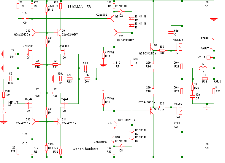

My PB250 has the resistor pads for a passive EF3 , so I can still do that. The EF2 is flawless in a high negative feedback power amp. The only 2 situations where a triple or CFP would be needed would be for many outputs or a non-switching AB setup. I experimented and implemented a EF 3 in my "trouble with triples" thread to augment the performance of the triple.
The sound quality I hear now with the luxman/hawksford is close to absolute perfection. My only purpose to build the EX is that it is the "better"luxman (more expensive and is a lateral OPS amp. My EX could do almost 200v/us , so I'm curious ... and it's just going to cost me another $20 , thats all. The CSS EF's do sound a little "tighter" with drums but this can be compensated witha better faster voltage stage.

OS,
You could replace the differentials with a comp, pair and take the feedback to the sources and have a decent gain in bandwith.
Something like I designed here but I would keep the VAS cascoged like you have
Jam
Jam

Where are the transistors ?? I want to try some fet's , but not ALL of them !!! Paralleled/single Jfets in a cascoded original would be the next logical step forward. (EX + cascode + 8 Jfets) The original's hawksford VAS LOVES to run at 12mA + as well , making it a better candidate to drive laterals direct ... at least 2 pair. Another benefit is the EX also is high loop gain 70db ... it would also do well fet'ed. Thus is born the "FX".
EX- 75 X 100mm and FX- 100 X 100mm board.
OS

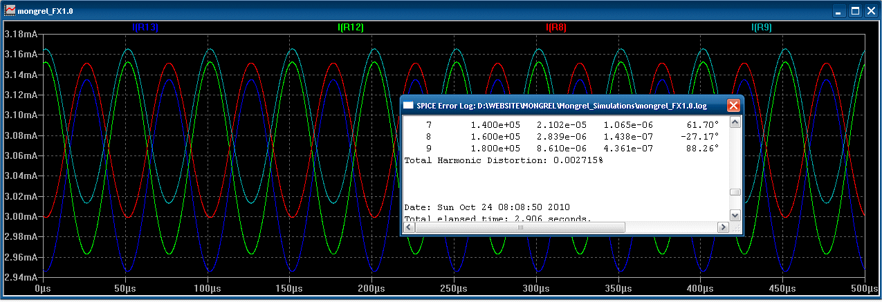

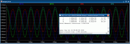

OH ...yeahhh. FX it is. .003% THD20 in all it's "fet glory".. (below) FET's at 3.05ma each...
PS - I notice it takes a lot less current swing for the N-channel FET's than the P- channels , BJT p-n pairs are MUCH closer (ksa/c's)
(attachment 2)
OS
(attachment 2)
OS
they are CCS's , they feed D3/4 (RED led CCS's) !!Looking good OS......so much for the simple approach.
How about replacing R20 and R21 with current sources for good measure.
Jam
Yes, but when you replace R20 and R21 with current sources you improve the performance of of the original current sources by about 20dB, I believe. Something to do with better rejection of the rails.....
Jam
But my rails are "squeaky clean" , either cap multipliers or full blown shunted separates , so this would not matter. A simple improvement would be the 2 device style CCS for those without these "enhancements". In reality , I get about 5-10mv ripple when slamming my current GX w/multipliers. Sounds like a dual monoblock.
