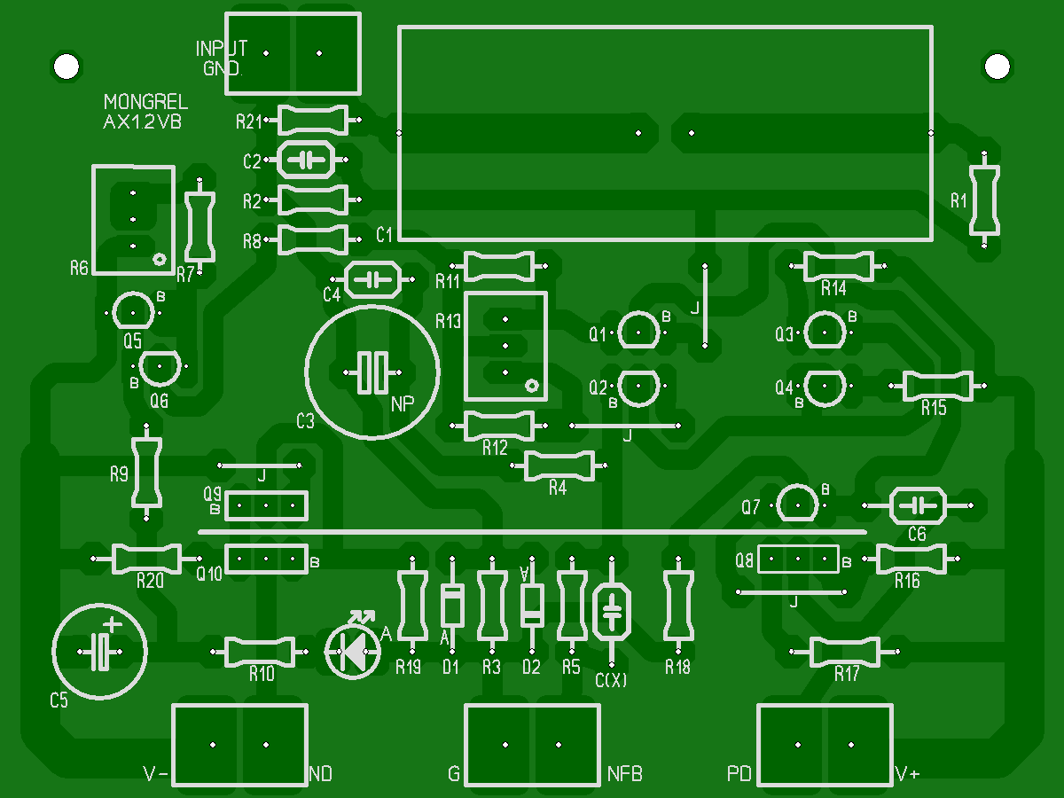

The KSA/C 1220 and 2690's are better. Since they are cascoded by the hawksford , their superior speed will improve performance. The 1381/3503 pair still work well. If you can hold on a few days a more concise , professional package will be submitted. I am now armed with the better tools (see PCB's below).
For a higher bias and the MJW21193/4 , you might want to use FJP1943/5200 "o"grade , these bad boys are the "beefiest" TO-220's out there with 120+ Hfe and over 1A SOA@70V.
NEW STUFF COMING SOON... ALL THE MONGRELS... (AX ,BX ,CXbjt/fet ,EX,GX).... REDESIGNED.
OS

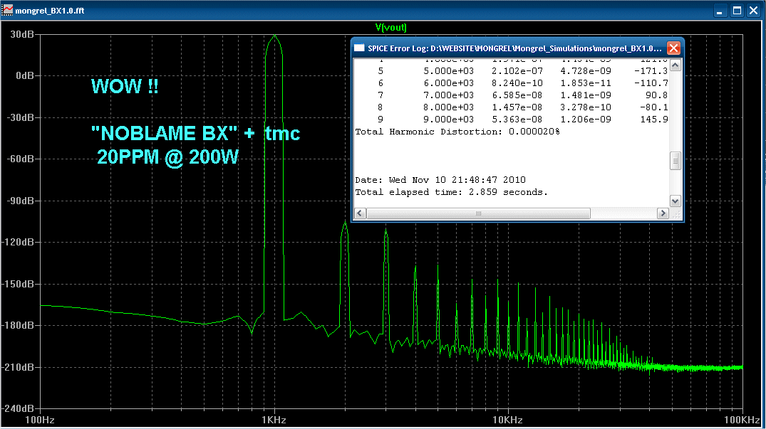

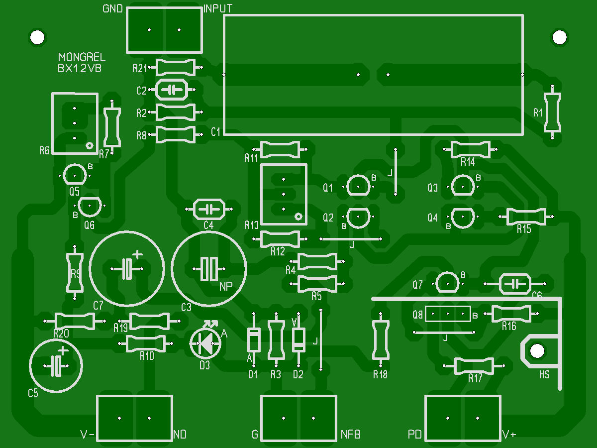

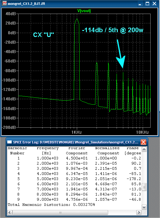

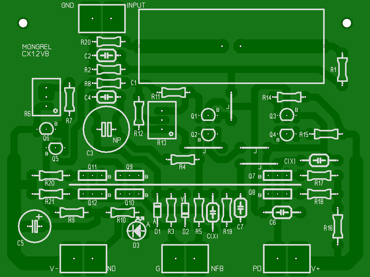

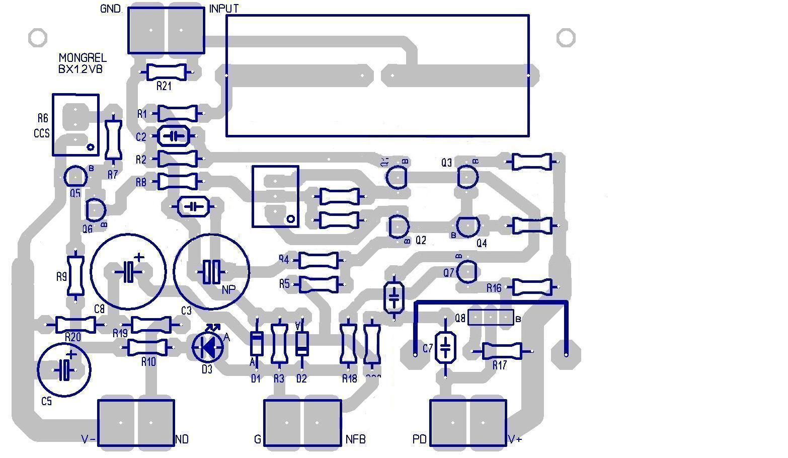

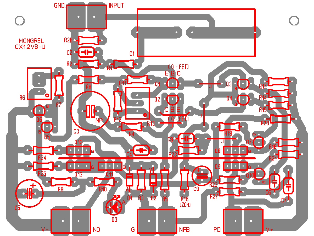

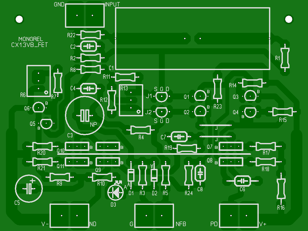

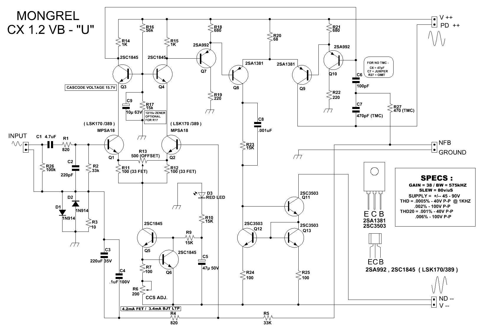

My CX "U" (goldmund killer) is DONE !
I have MY answer to all the fluster and fussin' on the 2 crazy goldmund threads. NO groupbuys , no B__S , just good old country cookin' 😀.
The PCB package is for just the voltage board , it can be used with all the current power boards (PB60/120/250). It can be used with MPSA18 OR LSK170/389 input pairs and will accept conventional miller compensation OR transitional miller comp. :devily:
I will make a MOSFET board to go with it this coming weekend for you goldmund fans. This amp sounds GREAT !! , is very stable and economical to make. The package includes the sprint layout (gerbers , drilling) , a JPG for the toner people, and overview/schematic , and a sprint generated BOM. BX is totally done as well (with TMC option) all in the "mongrel" site or attached ( 😎 it fits). On these, I mean business .. top quality..(thanx Alex MM) 🙂
The BX voltage board is being enjoyed WITH TMC right now !! Awesome. With some of the lowest simulated THD and the BEST FFT , the BX is almost to good to be true for such a simple DIY creation. Carlos and friends surely must be in heaven with this topology. The CX is comparable .. but with 3X the parts. (below FFT for CX and BX - last 2 plots)
OS

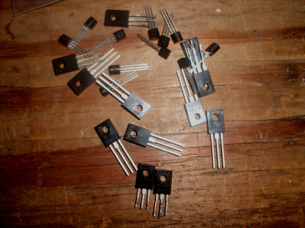

The Fairchild KSC versions work ok compared to the 2SC versions, right? I order about every other month from Mouser, so I hope these give a good bang for the buck.
Thats all I buy (lots of 100) KSC3503/KSA1381 -gain group "E" , Ksc1845/Ksa992 - gain group "F". For the CX , use MPSA18 (low noise) ... it will match a Jfet input pair. Both amps have a soft , non-fatiguing character with the dominant H2 as the only distortion component.
OS

Hi OS,
CX is good for MOSFET OPS, but not so for BJT OPS.
How to keep bias stable as there is no CCS and CM is not any kind of a constant current source. For MOSFET OPS it is not critical, but for BJT a variation of the bias current is not wanted (B class).
dado
Hi OS,
dado
BX and CX attach to a power board that HAS a full Vbe bias shunt which bolts to heatsink. Bx,Cx are just the modular voltage stages.

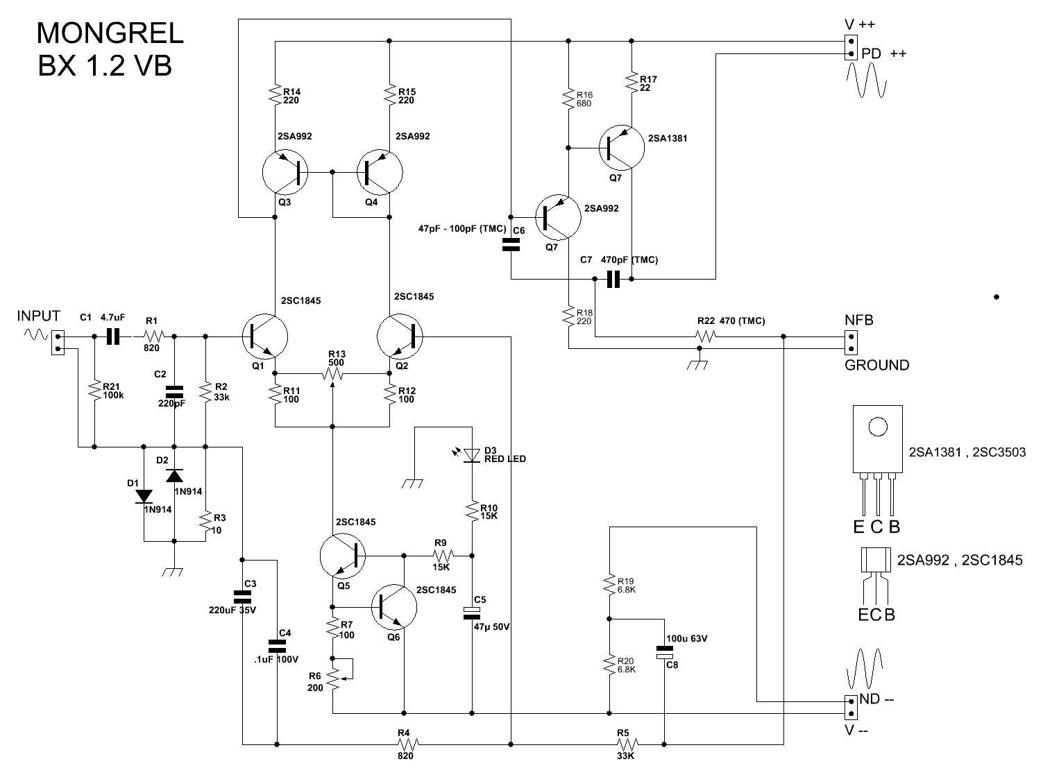

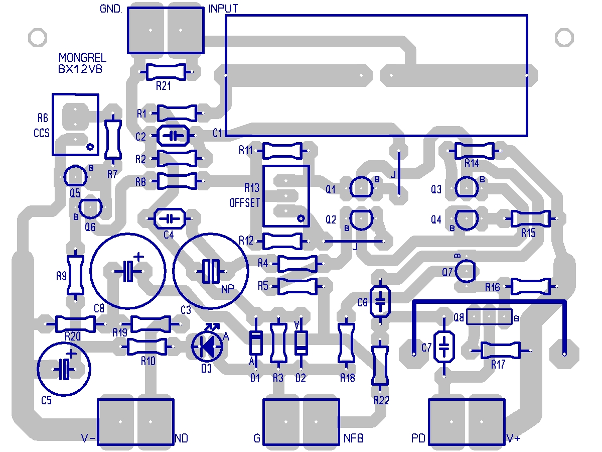

hey OS
I couldnt help it, my usual foolishness, I had to try
I rearranged Q1,2,3,4 just a small bit
and a bit around Q6
and some ....
btw, OS has allowed me to do it
but better check for errors
as I said to ossie, Im not saying its better, but maybe only easier to DIY it
