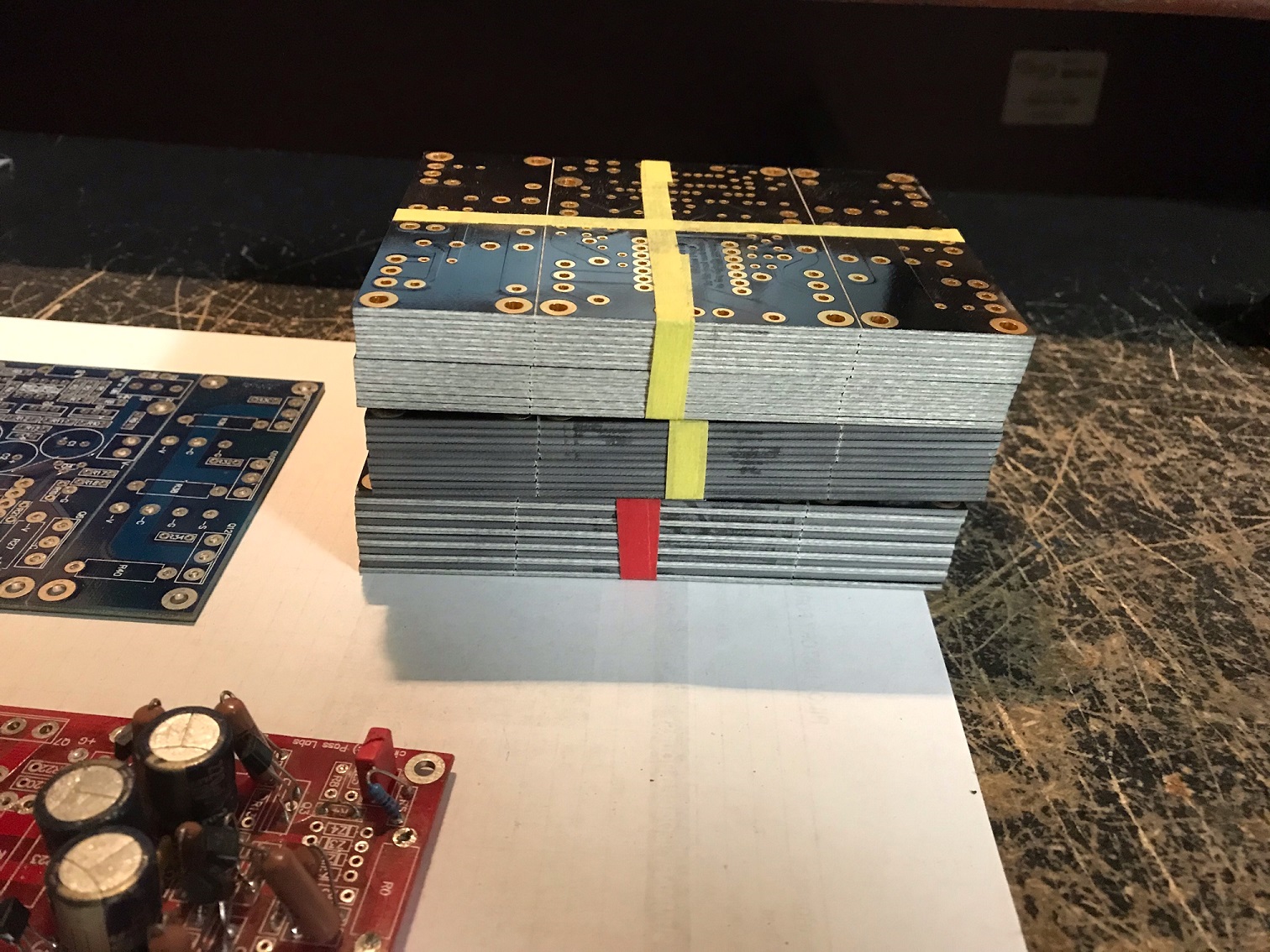

Just the one ?

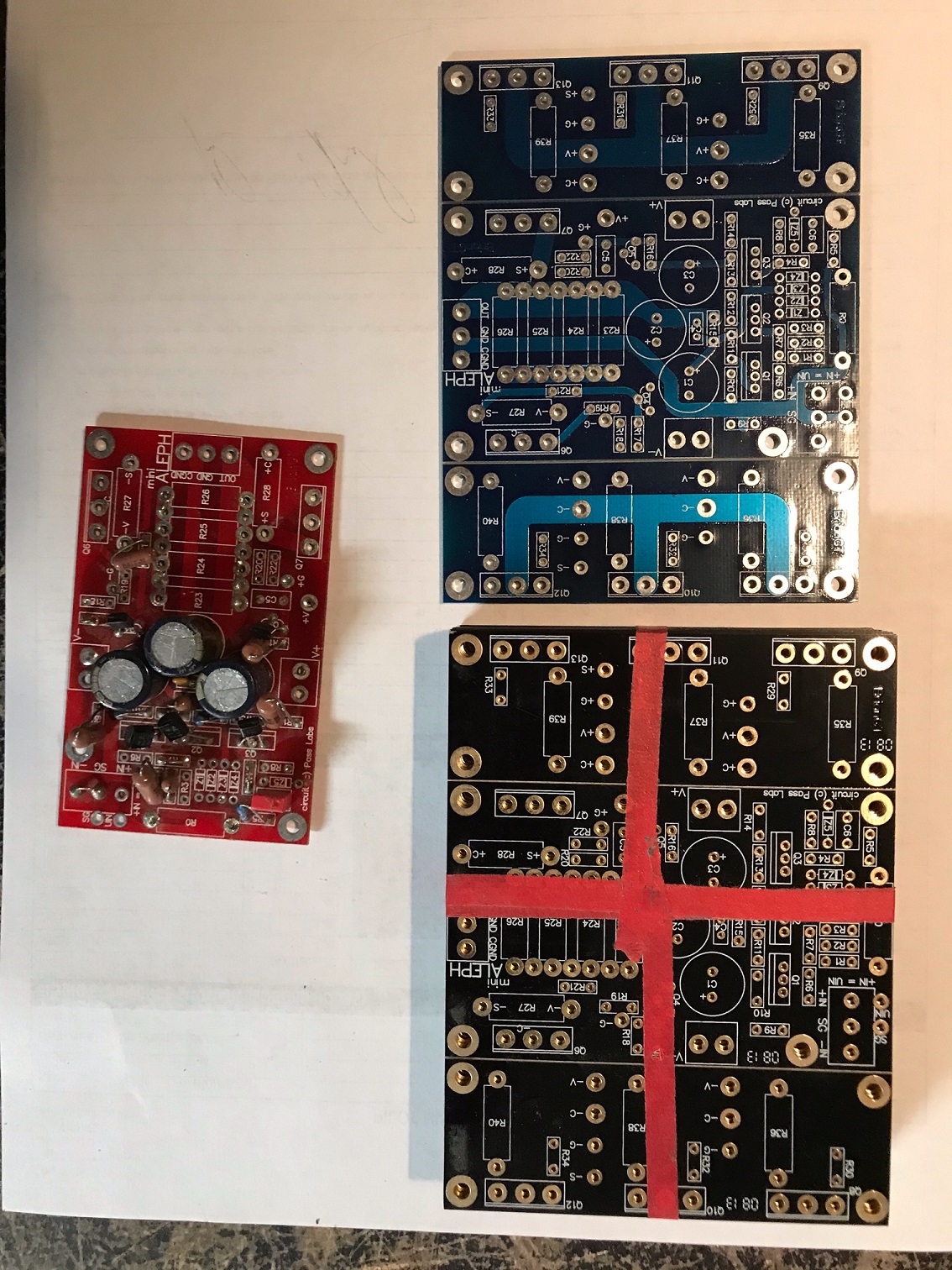

Schematic for it ? I think there was a small discrepancy on the component numbering from the original schematic or am I wrong ?
The very first version of BrianGT's was blue and about 2.4mm thick, 2nd version was red. The red and blue version had a silkscreen error for one of the 220uF caps. That black board Boywonder put up is corrected and matches the attached schematic. I have a stack as well that I've been hoarding for some reason, I'll let a bunch go free..just pay shipping.
To boywonder that's why I asked I read the complete thread from post 1 and there where some people mentioning that exact issue of the different components numbers.
But again I will only buy if there are 2 separated boards I don't have use for just one channel.
I have all the components for the buy bar the boards hence the question but thanks for the offer.
The boards are stereo...one board makes a two-channel amp.
Not correct, one board = one channel. I've built (blown up) about 15 amps using these boards over the years.
Ok...it has been a long time...I need to peek inside my amp.....

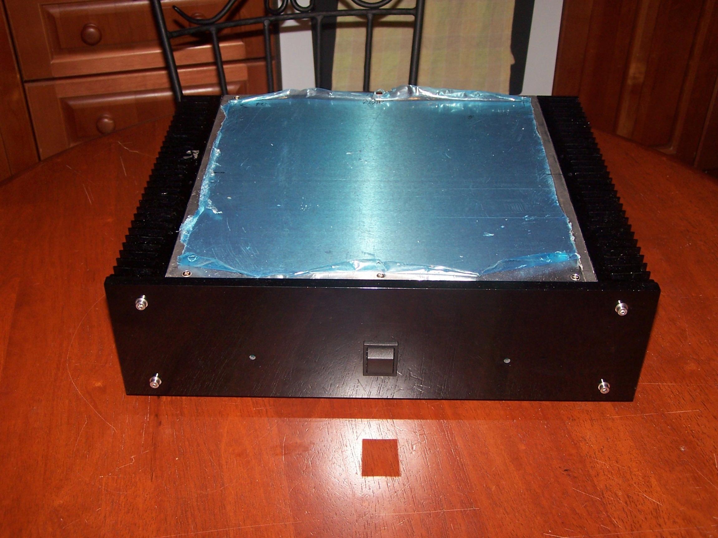

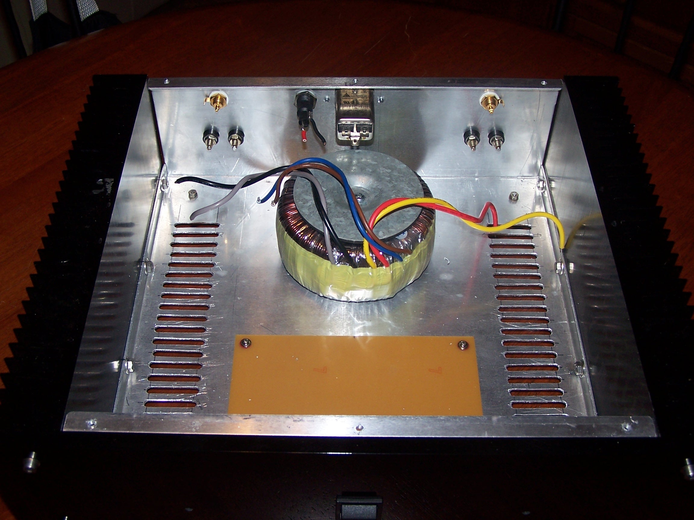

Had a look and found the pictures from the case I build for this little fellow
( Can't believe 10 years gone by)
Hope this will help using BrianGT board and Official Schema

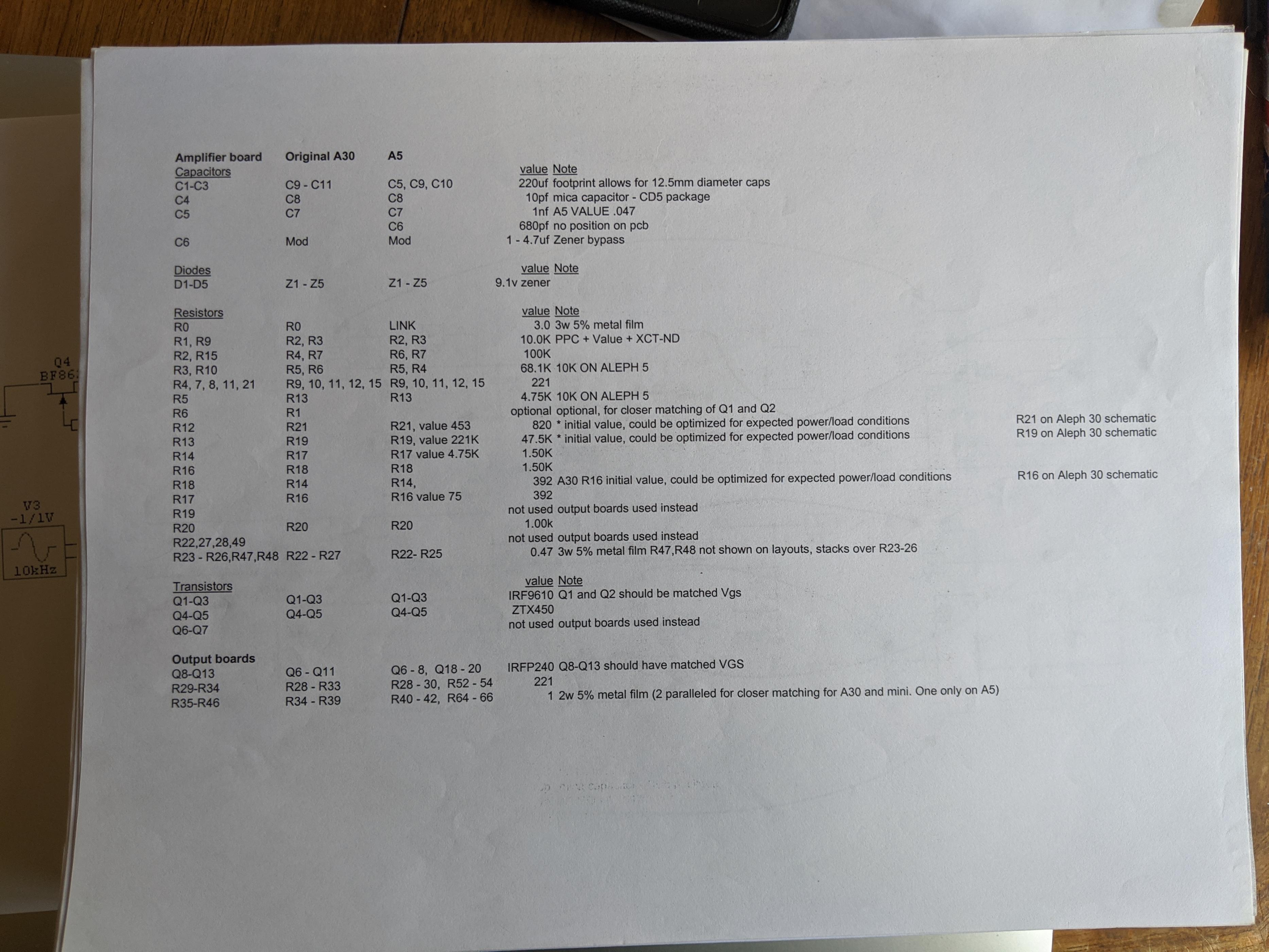

I found a hard copy of this but couldn't find the original file that it came from, likely a Excel spreadsheet. However, I found this quite useful when using he BrianGT black board and the official Aleph schema..
I hope someone has the original spreadsheet and will post it. Until then, use this if you have question of "what is this parts in the Pass schema".
