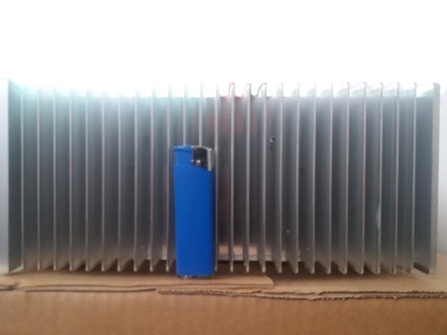

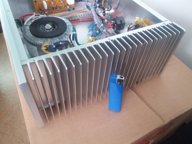

I have bought 4 IRFP240 and 4 matched IRF9610, but when I discovered that
the amp kit came with a 17V transformer I wasn't shure if I should change anything.
Since the kit is rated 2x10W I thought it had more like a 12V transformer...
I also have Elna Silmics from reliable source so I will change all caps.
The rectifier pcb has only 4 10.000uF caps, so I bought 4 22.000uF
This was going to be a mix of a ready kit, but with my own changes from the info found here.
The heat sinks are 10 inches long and 4,5 inches high, the fins protrudes 1,5 inch. Thickness of mounting surface is 0,275 inch. Have no other info about them.
My speakers are rated 4 to 8 Ohms, so if I understand it correctly a higher bias is better in my case. So aim is as high bias as the heatsinks can take :D
Not sure if this is enough info, so just ask more and I'll try to answer.
I get 24,5V out from rectifier board with current transformer.
(+24,5 and -24,5)
It's a bit high for my liking, but this transformer also powers the speaker protection boards, so not easy for me to get a similar.
But if you think is usable I'm all ears. And thanks again I really appreciate it. :)
Bias current from 1.2-1.5A if that is possible.
Maybe I should just get rid of the protection boards and get a 12V transformer and live with the "thump".

17Vac will give you something as 21V5 with loaded rectifier/filter block
practically , you count on 1.25 multiplication , not 1.41 , which is for unloaded or lightly loaded conditions
if we stay at 50W of heat as figure for your heatsinks ( and even that , I would say , with necessary use of Babysitter) , that leaves us with 50W/(2 x 21V5)=1A17 ....... which is pretty close to what you want to achieve
for that sort of Iq , put source resistors (R9 and R27) of 0R47/3W , and same value for sense resistor group (R16,R18)
change R11 to 1K , put 100K trimpot in place of R3 ( Iq adjustment)
if you want to have finer setting of output offset , while maintaining desired Iq , replace R25 with 220R (fixed value) and 500R trimpot , both in series
