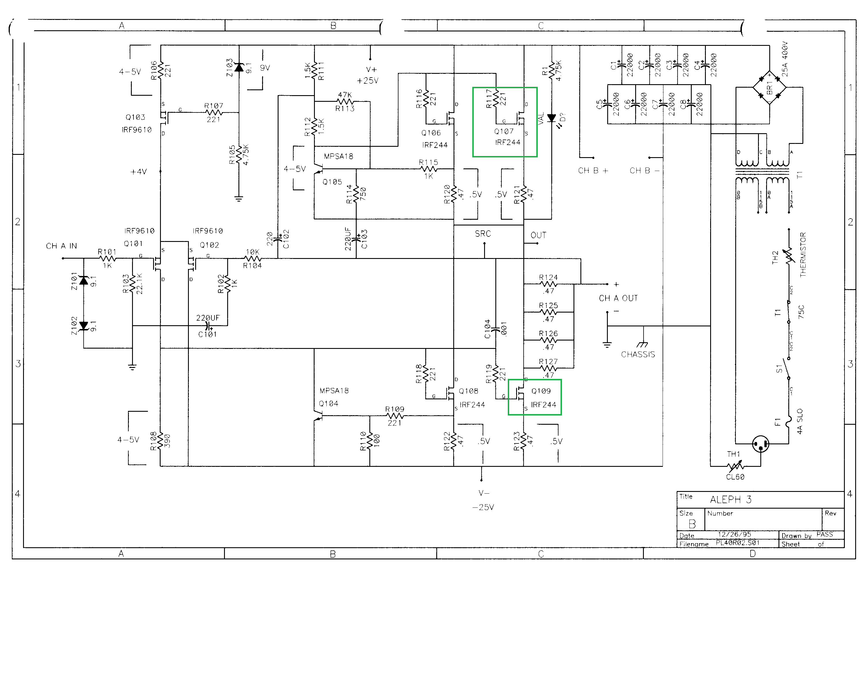

15watt aleph3
Dear All,
Can I remove parallel output stage for 15watt output without changing any components and rails.
As per NP nothing to adjutant in this circuit. And I want use IRFP240 instead of IRF244. It is interchangeable as per NP.
If I want to increase bias 2A and reduce rail voltage to 18V what change is required.
Thanks,
Nag.
Dear All,
Can I remove parallel output stage for 15watt output without changing any components and rails...
....If I want to increase bias 2A and reduce rail voltage to 18V what change is required.
Thanks,
Nag.
I have one that runs ~18.5V.. you may need to start with .22R at the output source to reach 2A. Mine with .33R maxes out around 1.65A per device, IIRC.
After giving some thought, I don't want to modify anything in schematic in post #894 as It is tried, tested and build circuit by NP. So I will use only one output stage. As per my understading it wont give any problem up to 15Watt@8ohm. What will happened if it draws 20Watt@8ohm.
