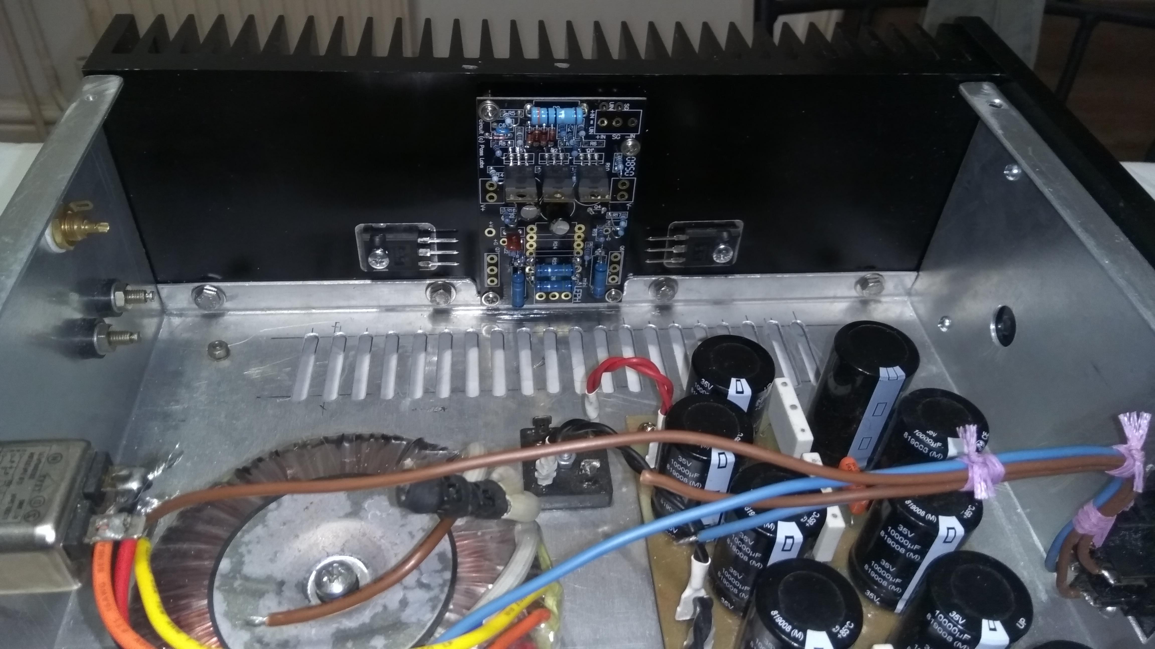

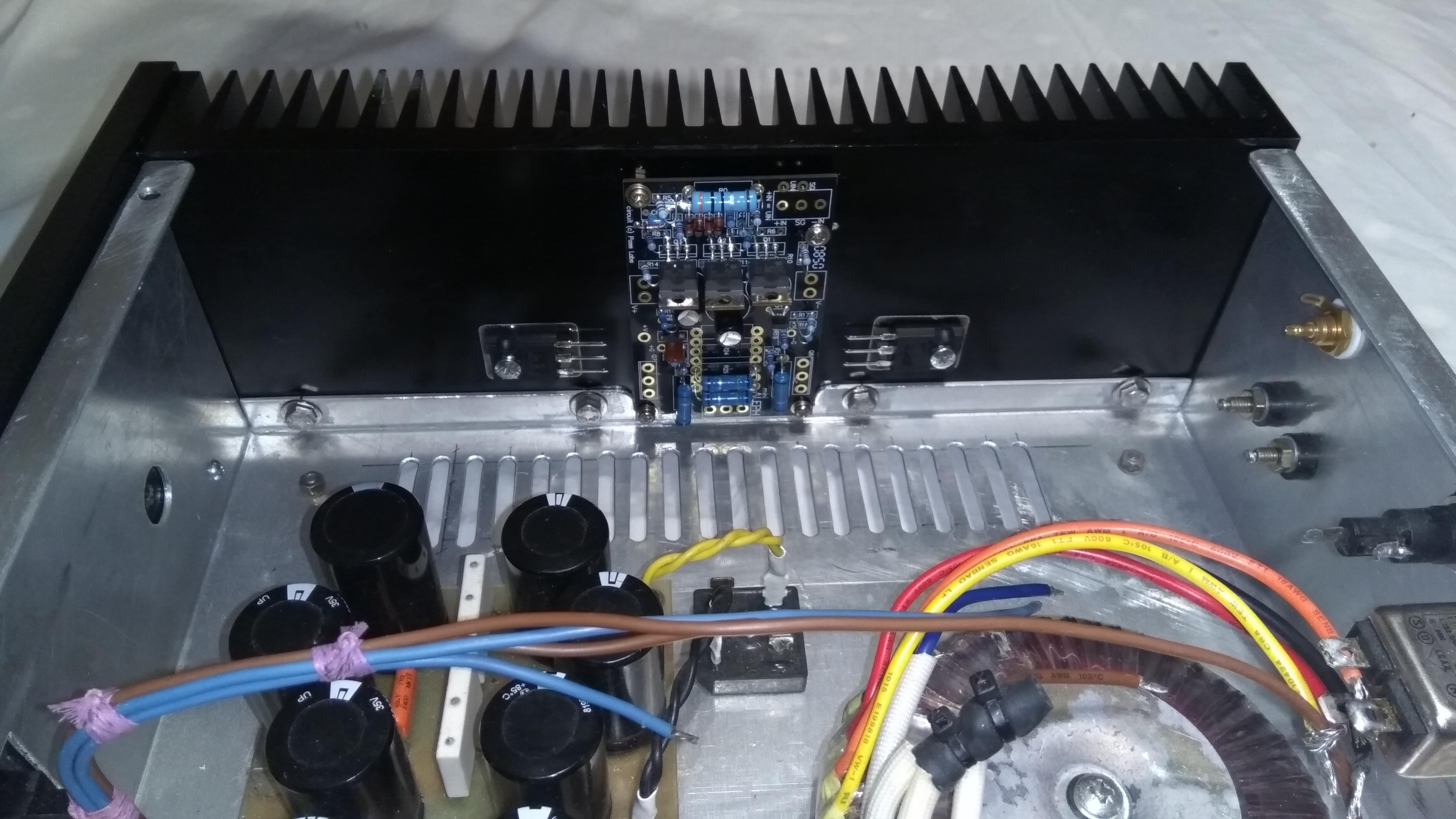

Decided to go with connectors for the wire connections so have to wait a few more days for parts to arrive (Ria Connectors system)
It gives me time to drill the top cover and wire the power supply.

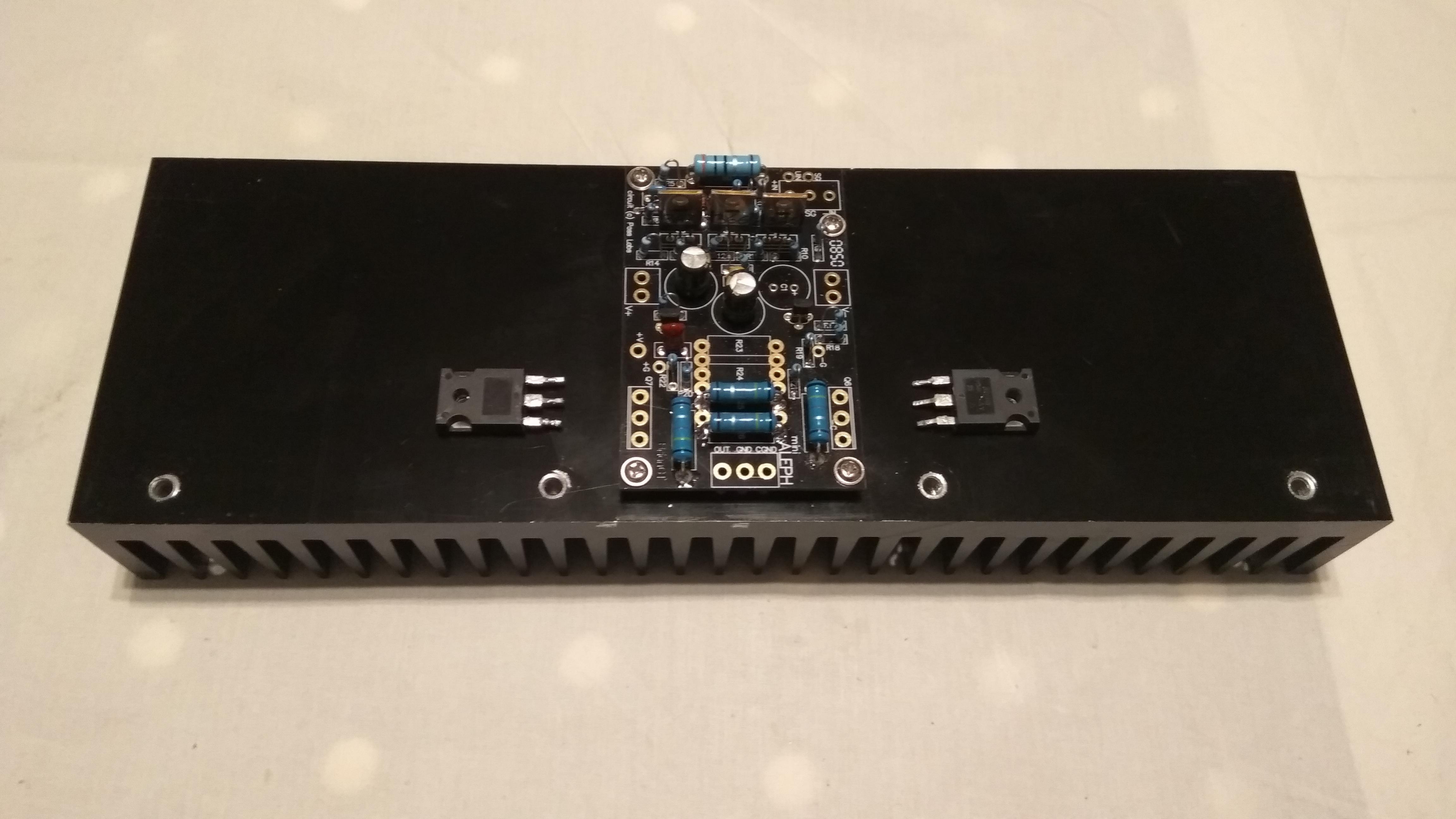

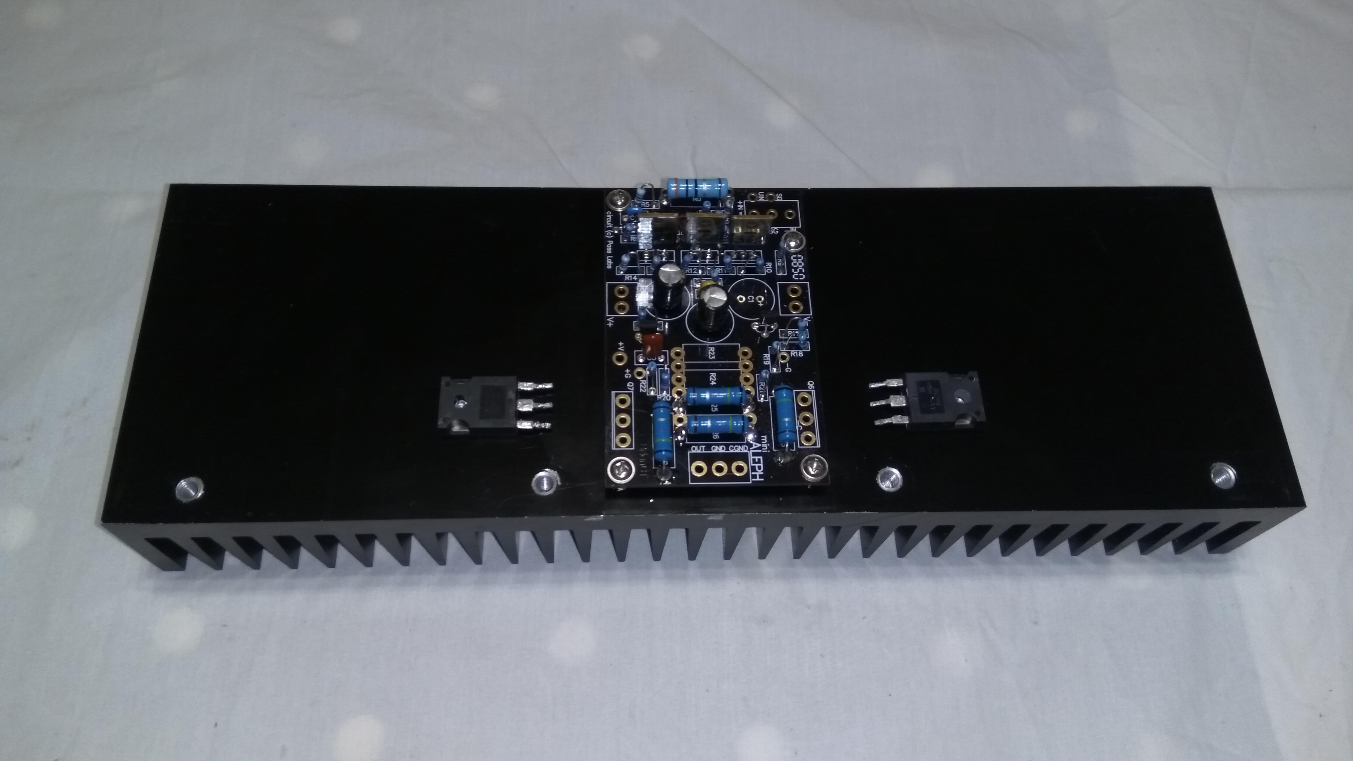

The Heatsink is 300x100x40
Have seen builds here from F5 and mini A with way less heatsink but I know more is better.

that looks like the absolute minimum Heat Sink size...
Mine are 250x180x40 (mm). They are just luke warm. But then my PS voltage is also somewhat too low (+/-16V)

The other question is what current you are going to use to toast your power mosfets. I can't remember mine unfortunately but it was not too low (my speakers are less than 8ohm so I more current than voltage).
Sorry Gregje I was been sarcastic I was aiming to 15Vdc from the day I started the enclosure 10 years ago.
Going to try with the stock value (750 ohm) to start with and go from there and of course checking the sinks temp according to Papa method (hand on sink).
