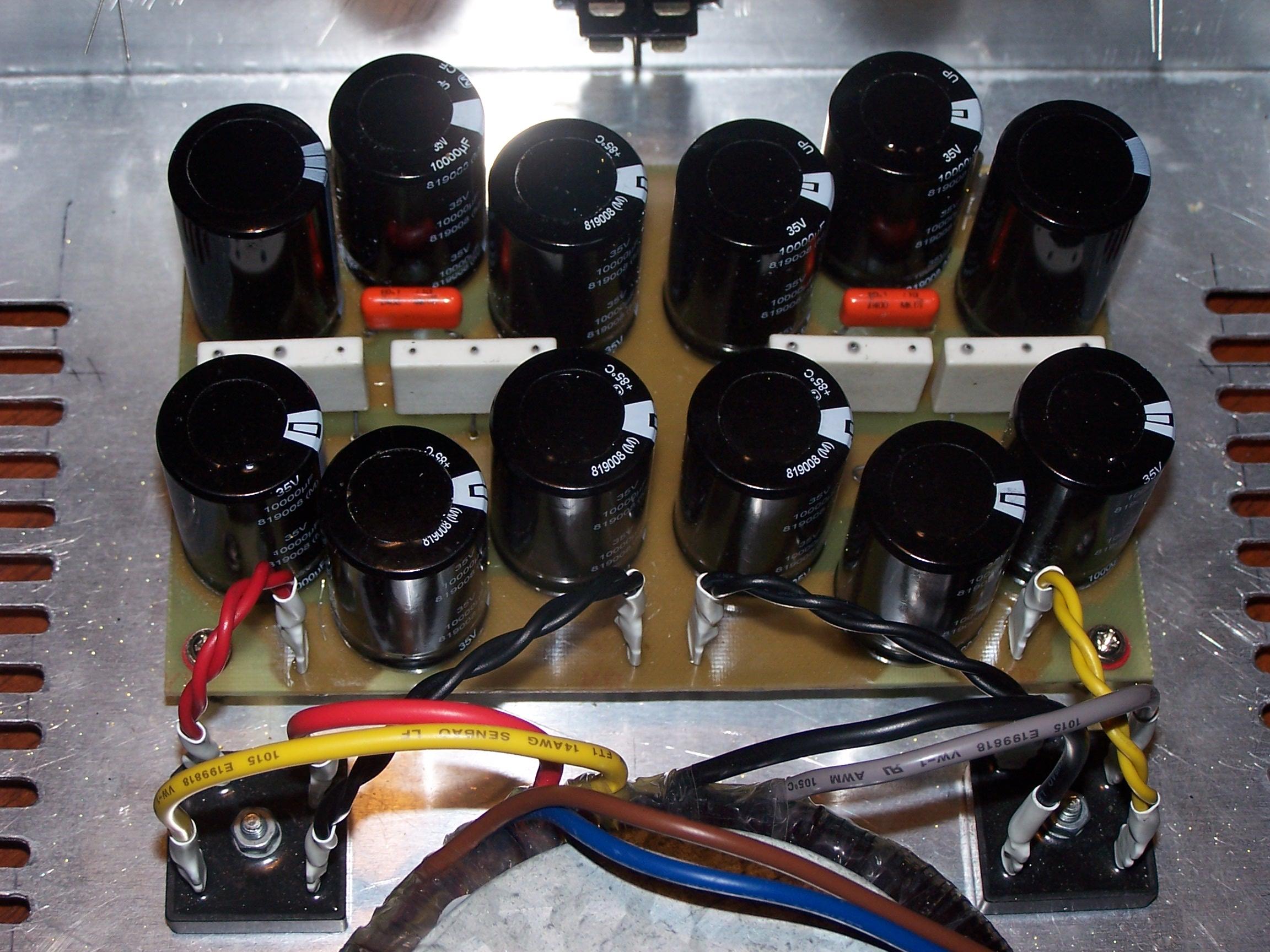

One question: I found in my parts bin(s) 4 Fukushima metal plate twin resistors ans I wonder if I can use this ones in the capacitor bank.
The schematic asks for 4 0.47 Ohms 3 or 5W and this ones are 2x0.47Ohms in one body but I don't know the power rating but they are about the double the size of the normal fukushima 0.47Ohms 5W.
I know they are toooo good for this application but that is what I have at hand at the moment.
The other thing is I need to change the board to fit this ones.
Ric
The ones holding the rails see only something like half a volt over them, 3W would be more than enough for those.
I do have 5W units installed but it runs so cool they may have been overkill, oh well its got to be good for thermal distortion.
Two 0r47 in parallel have an effective resistance of 0r235.
Pass an ampere through them and you dissipate <500mW
Pass 2Adc and they dissipate <2W
Pass 4Adc and they dissipate ~7.5W

I'm talking about the resistores in the power supply capacitor bank, you know the 2 banks separetaed by 4 0,47Ohms in each rail.
I'm using the power supply from the F4 manual

Found out the fukushima resistors are rated 5+5W with 3 leads, don't have a picture but they are the MPC725 (metal plate cement) 0.47Ohms

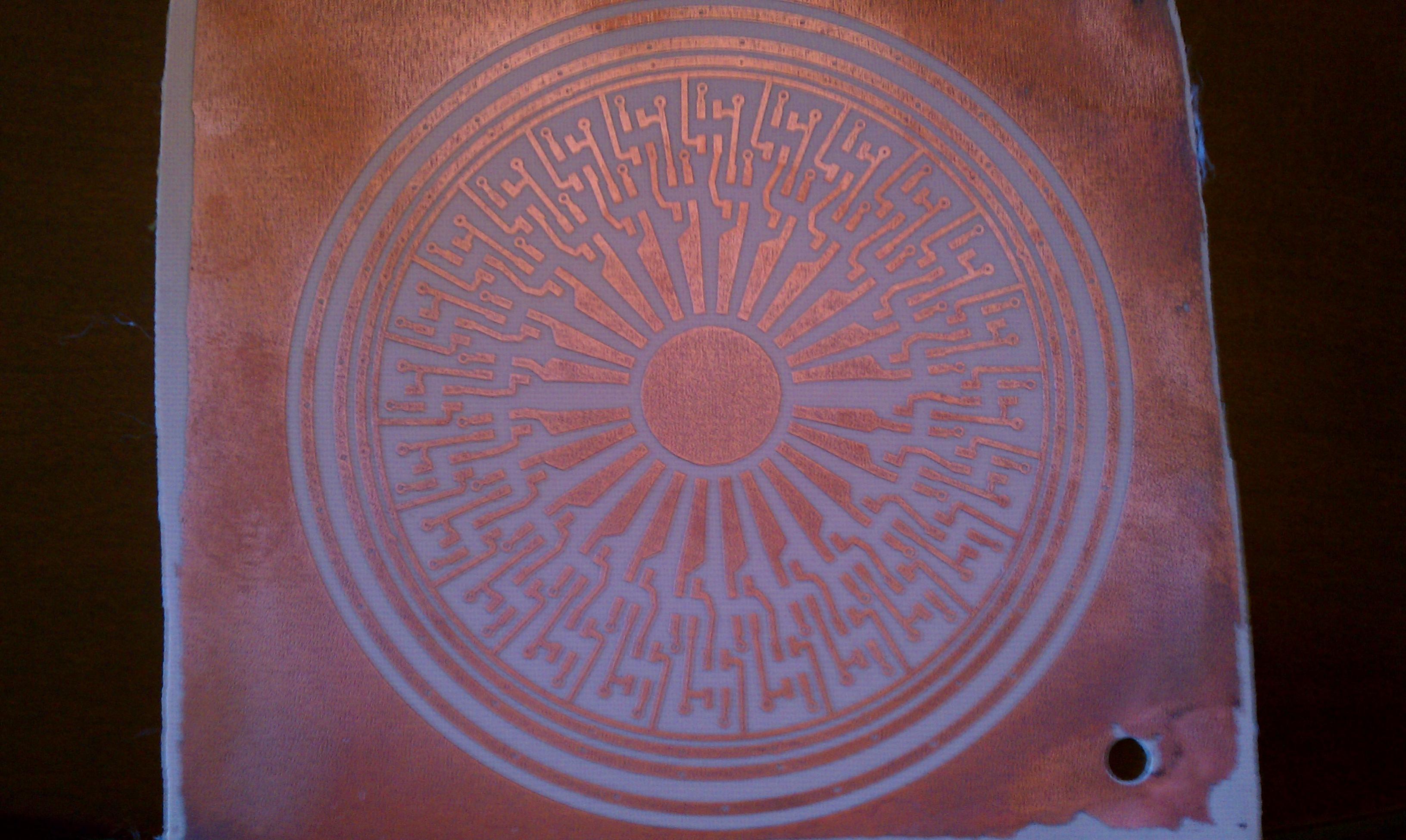

Look, I know toner transfer is a bi^(#, but man I am having great luck today and yesterday. My buddy Sonidos recommended new paper to me. I am using HP Presentation Paper 120g Glossy.
I have done 3 transfers. Two of them came out beautifully. Perfectly.
I am even getting away with a cheapo BROTHER Laser printer. Think its like a HL2140 or similar. Anyway, I make sure the print is ultra dark, photo mode, ultra contrast, B&W only, 1200dpi. Then hold the board and print super flat against each other and masking tape the entire edges. No bubbles of air or ridges of uneven paper between the tape outline. Iron on HI. 2 Steven Winwood songs later you are done. Put a piece of paper between the iron and the image paper for smooth movements. Hold down iron is one place at least 40 seconds and then move over a little. Outline will start to show through the paper. Where it is a bit less dark you need to keep hitting that part. Tip of iron is not as hot as center but does put down more pressure. When it looks like the image has nearly seeped through the paper to your side then youre done. Take the board to the bathroom and put it in the tub. Cold water. Remove it after few seconds and shampoo it. Seriously. Let shampoo sit there for a half minute and then immerse. A few minutes and you can rub a layer of paper off. Shampoo again. Immerse. Rub. When you start getting to copper dont get excited. Move on and keep getting a little paper off of the thing til its all got a tiny thin layer of paper left. Dont get worried to remove this. Be gentle with this last layer. Shampoo it again. Immerse. Now lightly remove the rest. Maybe toothbrush, maybe thumb. Man this worked out wonderfully for me. Best results I have ever had. Super super precise to.
Better than I had hoped for.
Anyway, I want to try photosensitive to but, today when this worked so well, I think I have a new standard to use.

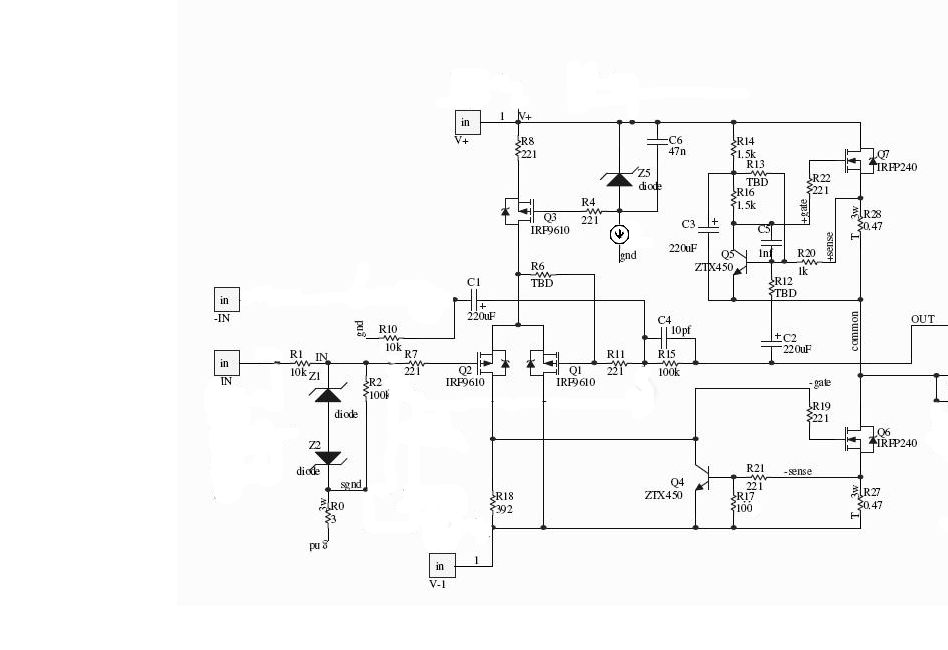

I'm attaching my slight modifications to the schematic. I'm ditching the connection for the balanced input altogether - the extra resistors and zeners they result in. I'm also giving the zener reference a 3mA FET CCS instead of a resistor, because I'm swimming in FETs I don't know what to do with. Does anyone see problems here?

Is that mains to the fuse going in via the side terminal?
That increases the risk of fatality if someone takes off the fuse holder cover and touches the fuse end.
Why have you used yellow? It's a standard colour in 4 wire light switching, not mains cabling. Brown is Live, Blue is Neutral, Green/Yellow is PE/Earth.
Hi Andrew
Thanks in point that out (yellow cable going to fuse)
I know the main cabling standart but in this case I don't have mains cable to do the job so I used what I had (16 gauge black/yellow/red/purple).
I work for the aircraft industry were we do the wiring looms for engines/wing etc but the cable is not suitable to be used in this (small) boxes.
