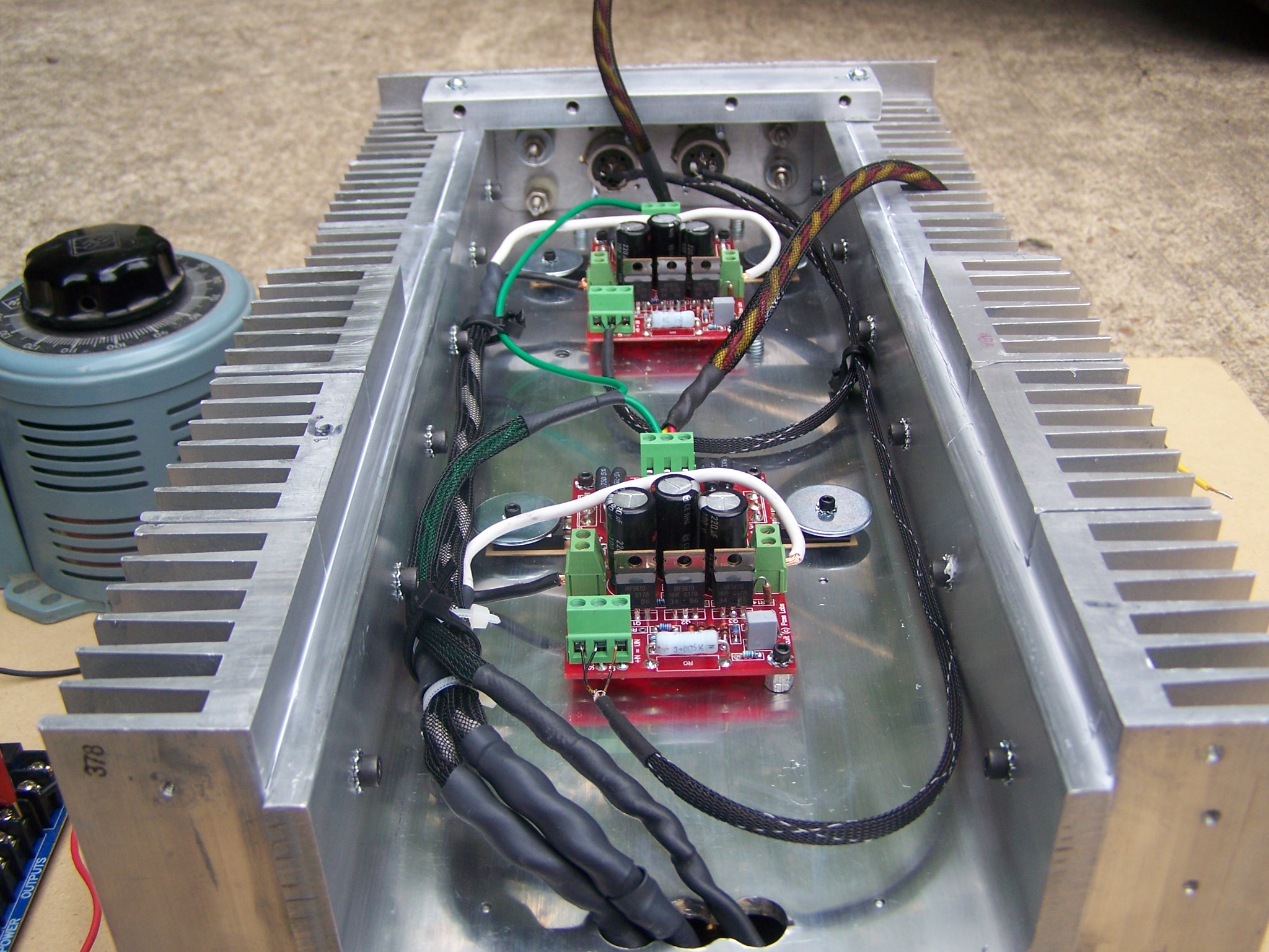

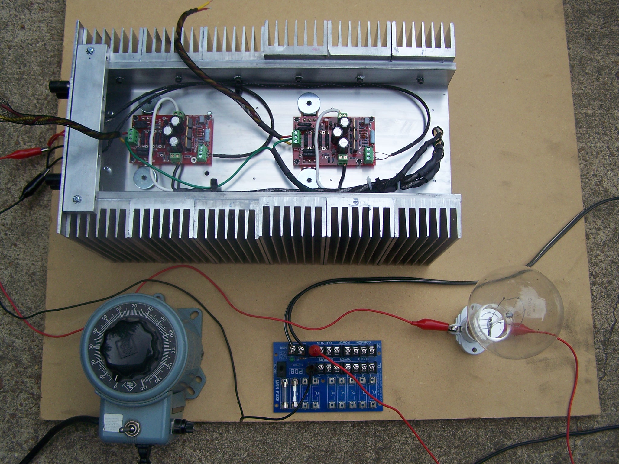

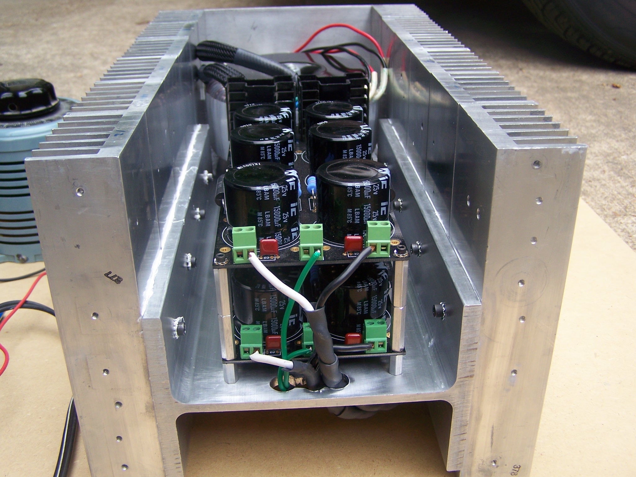

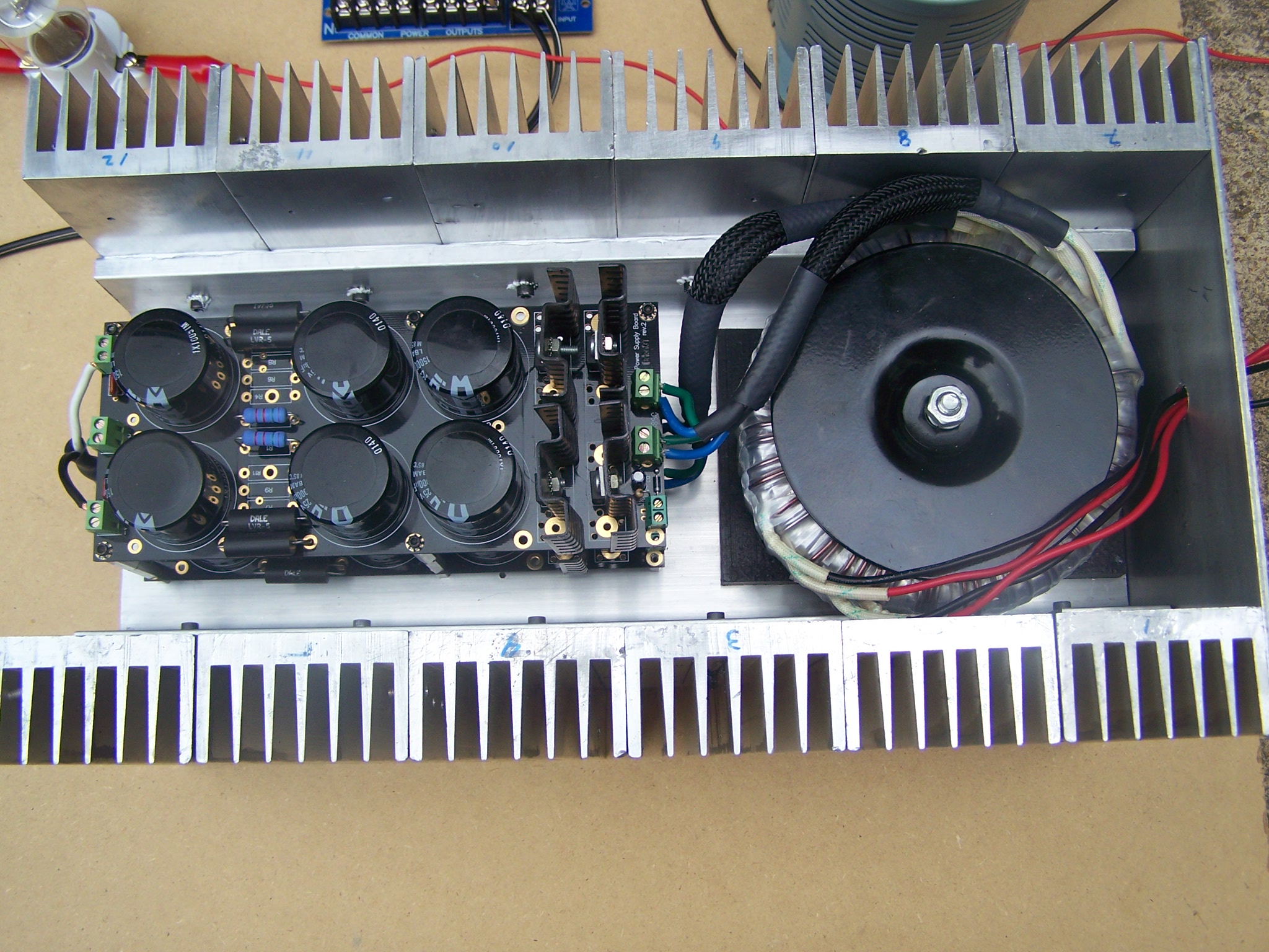

2x amps, 2x PSU in one chassis. The voltages are a bit high I guess from variac " juicing up" the power supply consist of Antek 4x15 400VA transformer. Basic CRC with 2x0.25R 5 W Dales. The power supply seems to be dead on. I used variac to bring it up to 115V slowly. The chain is: Variac, power strip with fuse buss, bulb, Toroidal wired both black wires together, both red together.
I then went to measure DC on the amplifier V+ and V- terminal and got the readings I reported. I check for voltage over the source resistors but had nothing, Z5 had 12V, and there was no offset at speakers maybe 5mv. I can post pics in a few minutes. like I said both pcb's were tested before. I'm afraid that handling might have blown a fet or two.

Here are pics:
I just returned home and tried to power it up again. This time the bulb starts to glow some @ 100V or so.
I tried checking for continuitee between all mosfets and ground, voltage terminals to ground, etc. Nothing that I could see.

firing up already biased amp through bulb tester is nono
you need and can use it only for checking non-biased amp

I think I solved it 😎
In the picture you can see there is 2 green wires running from PSU PCB, to CGROUND on Amp PCB. I connected a alligator clip between both speaker returns on just 1 strand of wire, and who would guess perfect voltages! I will connect both amp PSU PCB's to earth safety ground.

that was my next question🙂 are the 2 green 0V wires conected correctly🙂 seams like they go to the wrong amp board.
if they are mixed up(wich it seams to be) then you will have that crazy voltages.

but first. massure with diode tester the green wires, from PSU to amp. so you see if the corect PSU is conected to the corect amp.
🙄 I missed it, after planning, and setup, and check list....
