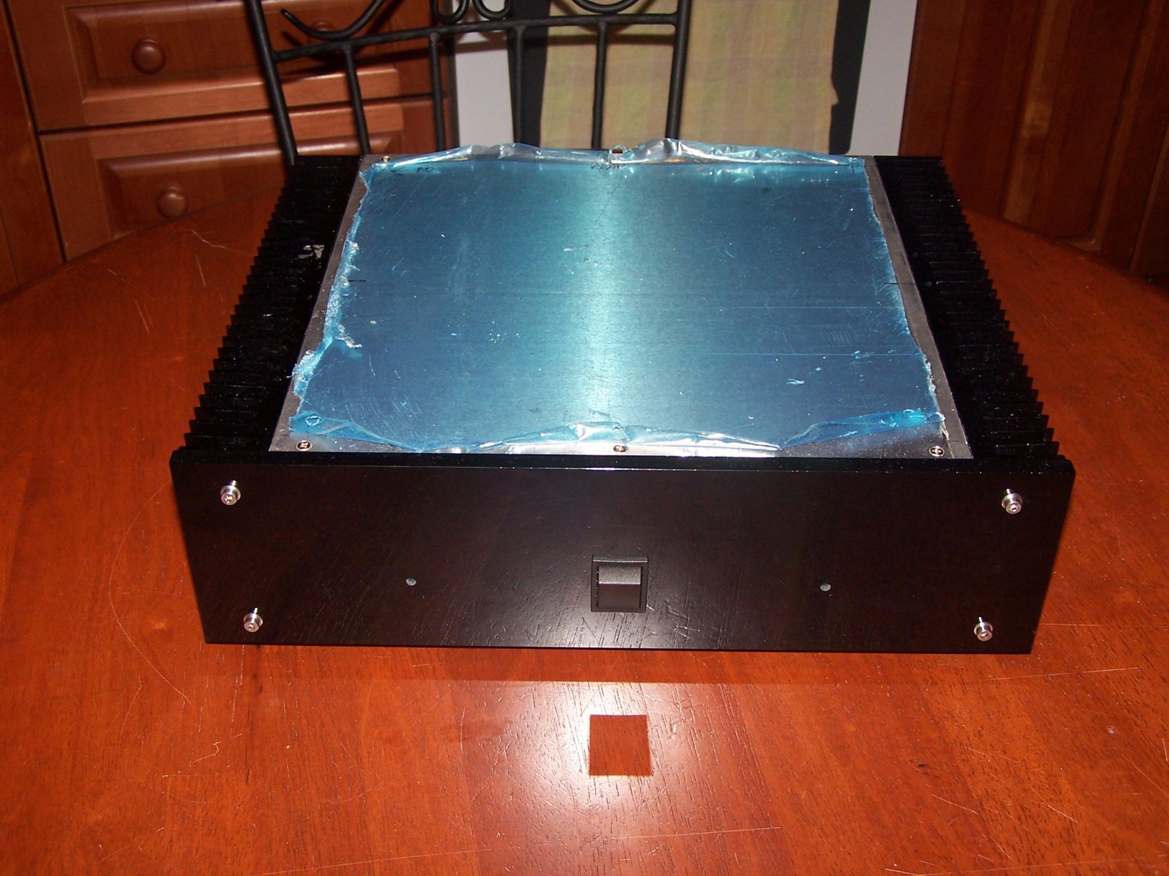

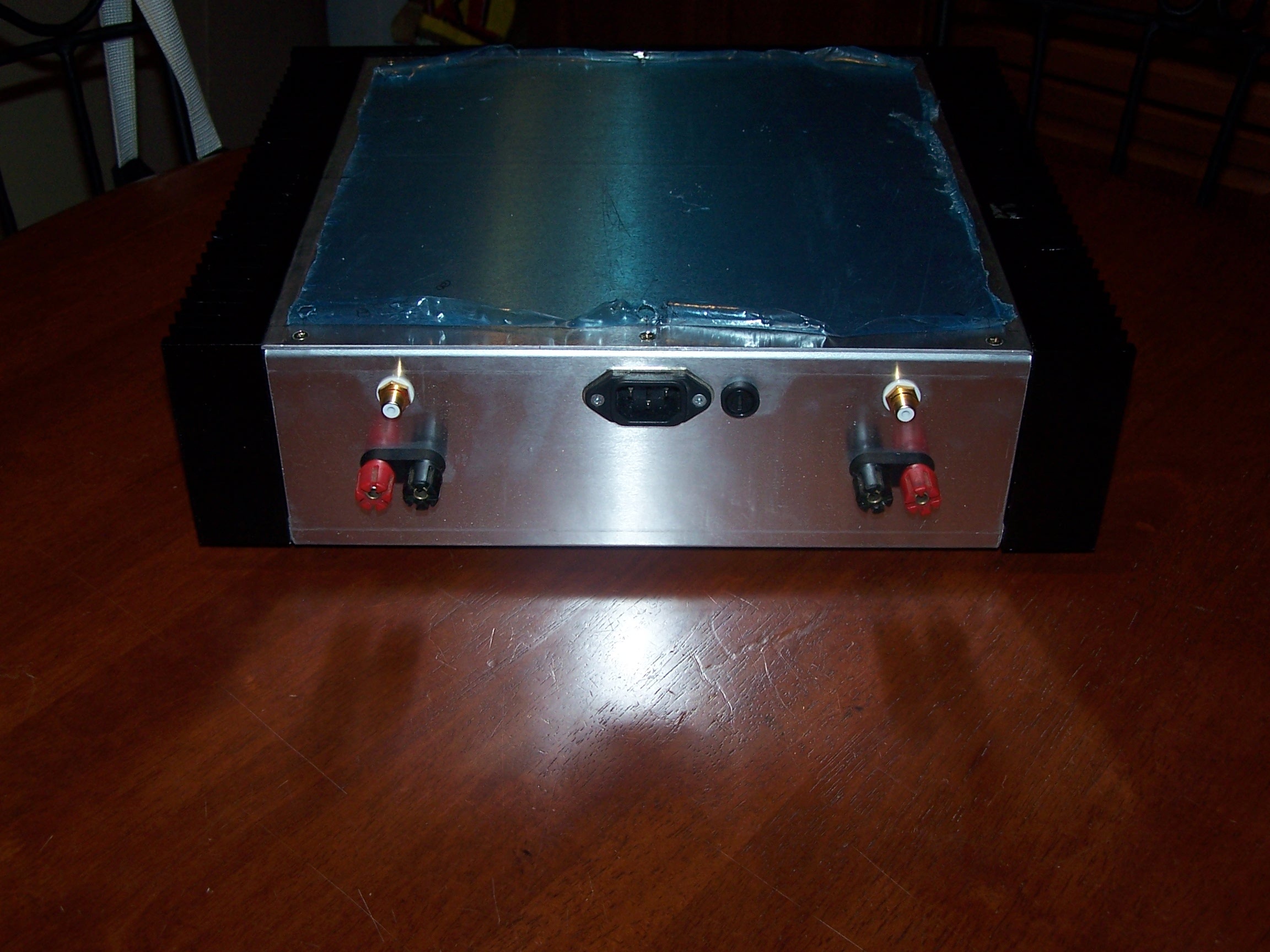

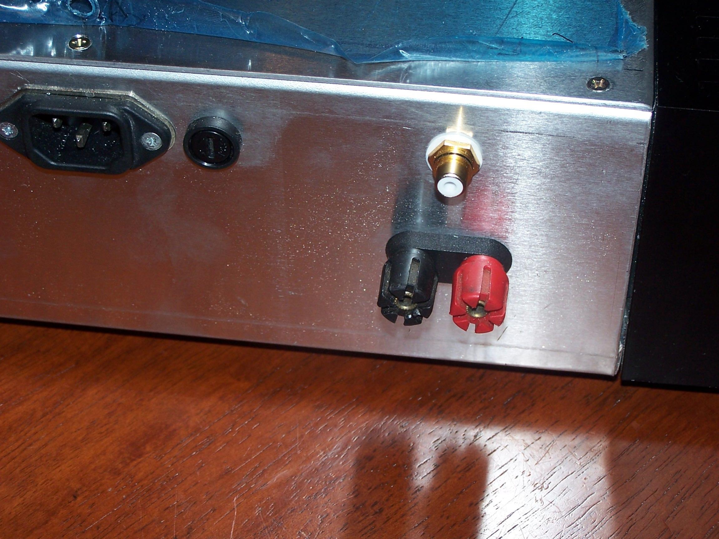

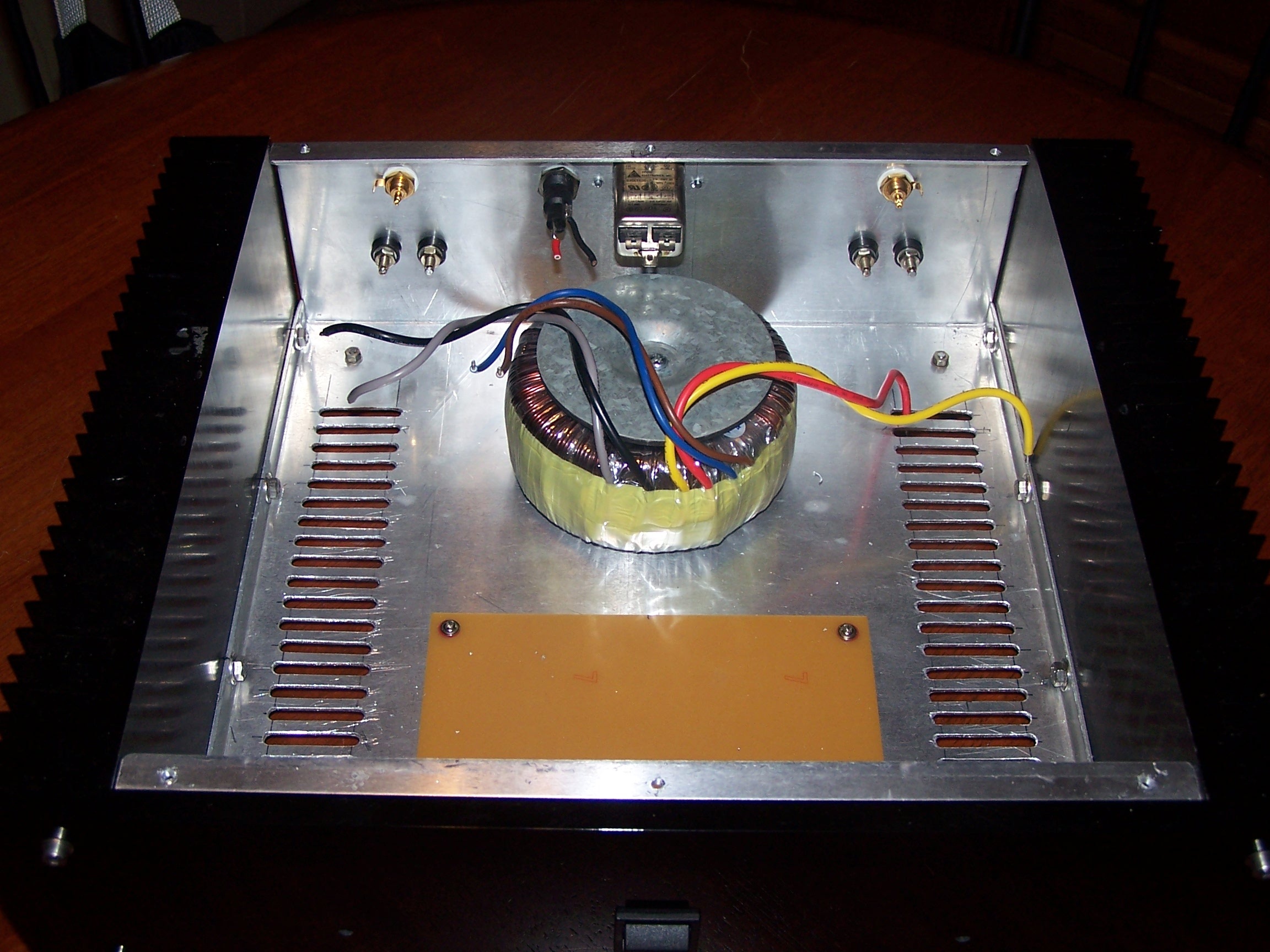

My case is almost finished.
The power supply is only.... 12V/0/12V 300VA and 120000uf
Need a few more bits so I can finish by psu board
I only hope my 300x100x40mm heatsink are up to the task.
Ric
I hope you mean you have a 12V AC transformer, to get you in the region of 15V DC. You need at least 15V and 1A to get the output fets into their optimal operational mode.
I'm so averse to blowing drivers, I still have not tried the mini with my Kirkseaters.
I think is time for a bit of Heavy Metal porn...
I still need to make the vents on the top plate.
The board inside is the one for the cap bank the rectifiers are going on the bottom plate between the trafo ant the board.
Ric
