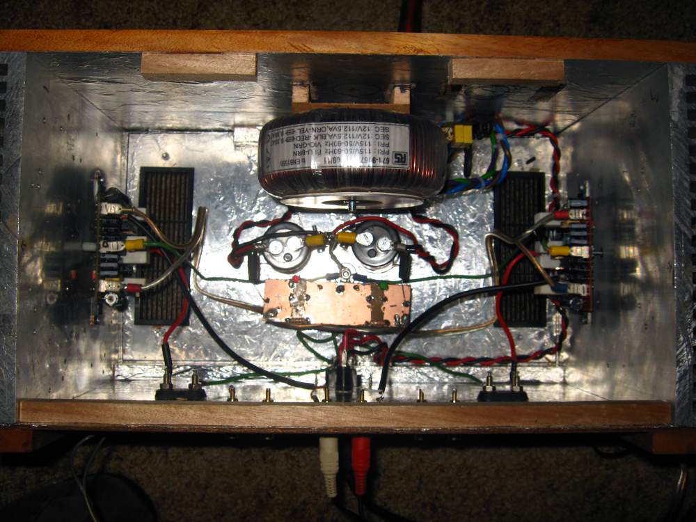

Hey my baby is playing again, believe it or not, the FET that desoldered itself is still alive and kicking. Did nearly have an issue with connecting the traffo primaryout of phase, the thermistor kicked in and saved the day when I switched the amp on the first time (after I bypassed the fuse to see why the thing just wasnt powering on). Also the hum is now completely gone, like nothing, zip nada, dead quiet.

Ok here are the pics, the PSU part is still a bit raw looking as I just used a pair of through hole caps for the second bank, this will be replaced with a set of can types like the first.
Also it is just a test platform, so finish is not of the greatest importance.
Although it is fullly working, a few components still need to be added like the clipping indicator and status LEDs, as well as the relay bank and controls.
the reason the power cord snakes around the side is because it attaches to a thermal fuse.
So far it is dead quiet, and the fixing of whatever was causeing the hum, has improved the sound quality by quite a margin again. Imaging is almost holographic, and you get a crystal clear image of where istruments (mics) are placed.
