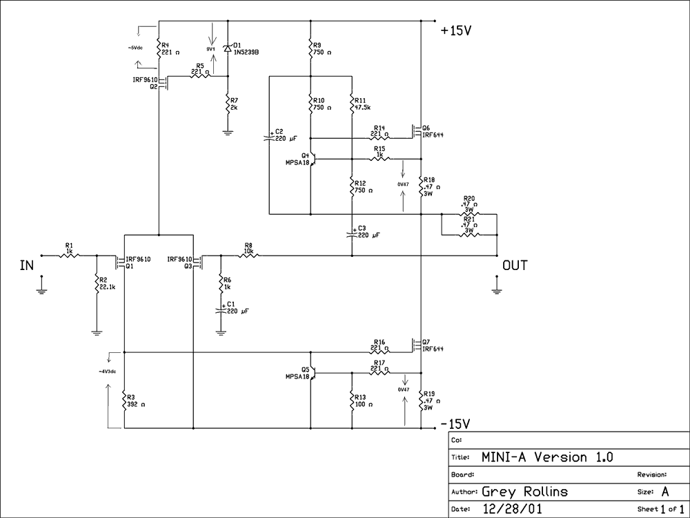

jleaman, I thought that the resistors to ground should also be included when calculating the input impedance. BrianGT's mini-A schematic has a 10K input resistor and then there's those two parallel resistors to ground (R2:100K & R3:68K1) that make it ~50K.
I was told it's the first resistor in the path, i could be wrong tho,
I'm thinking of making another mini-A... Could the more knowledgeable people here confirm the following?
Using BrianGT's schematic I think that:
R8 (221R): sets DC offset
R13 (47.5K): sets bias current
Correct?
My idea is to replace those resistors with trimpots and thus be able to tweak it to my heart's content. Has any body here done that already? Any problem leaving the trimpots in there permanently? Are 21 turns cermet trimpots a good choice? Any suggestions what kind of trimpot value to use?

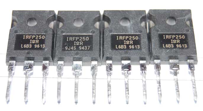

  • maybe replace the IRFP240's with IRFP250's...
I layed my hands on four NOS IRFP250's. Only 1 euro a piece, pretty cheap, any plenty more where they came from...
Anybody here that made his mini-A using IRFP250's?

Thats what i run in all 4 of my smd aleph mini's. IRFP240's 🙂

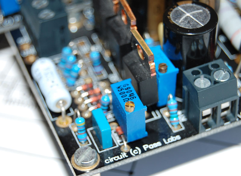

Yesterday I re-did the screw holes in the heatsinks. I got to use the drill-press-on-steroids at work. I used my own M3 tap set and successfully threaded the holes. The MOSFETs are now reliably fastened.
I built it per BrianGT's mini-A BOM and ended up with ~400mV accross the source resistors. This results in a bias of ~0.85 amps. Only recently I found this bit of info:
That does indeed match my observation, a 47.5K resistor gives a bit of a low-ish ~0.8 amp bias current.
I completely rewired the amp and implemented a starground. I also mounted the IRFP250's instead of the original IRFP240's I had in it. After powering it up I started tweaking the bias and DC offset. The trimpots really make adjusting the bias and DC offset very easy. Turn the bias pot up and the voltage drop over the source resistor goes up too. Cool. Over the course of the evening I adjusted left and right channel bias to 1.1 amps (heatsinks at ~37°C). DC offset in both channels is now below 10mV, one channel was 70mV before the tweak.

Good work, looks nice, i ditched the screw terminals for the power supply leads, I found them annoying and not needed.
