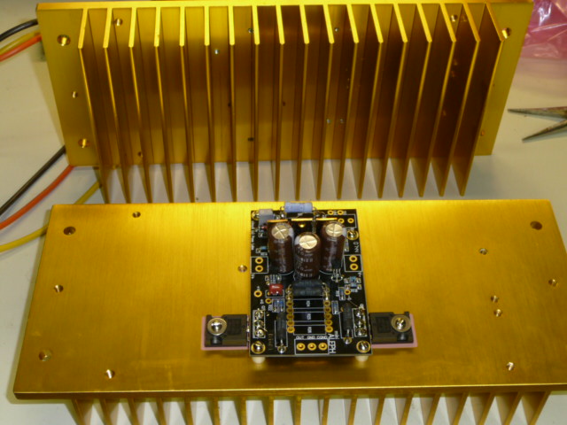

The boards are currently black with white silk screen:
amp set: http://chipamp.com/diyaudio/miniA-amp.jpg
psu board: http://chipamp.com/diyaudio/miniA-ps.jpg

Consider those 1.5" tall rectifier diode heatsinks as the minimum requirement. Taller is better! My mini-A runs @ ~1.2 Amps bias current and it really needs those 1.5" heatsinks.
BTW where are C1 and C2 in the power supply BOM? I used two Vishay's MKP1837 for those.
Diode-wise you can choose from a lot of TO-220 types, I used HFA08TB60's. Nelson prefers slow diodes: http://www.firstwatt.com/downloads/powersupply.pdf
The through-hole boards I built I used Simlic II caps and that does make a difference.
I used Elna ROS Silmic caps too, they cost more than double than Panasonic FC's (very decent caps) but are worth it IMO. My mini-A sounds wonderful with them.
Nelson is also fond of these Elna caps: http://www.diyaudio.com/forums/parts/151392-best-electrolytic-capacitors.html#post1919931

While I have your attention, one more question. Sources for the IRF9610 and IRFP240? My understanding is that for the IRFP240 since I am going to be using just one for the output then matching is not an issue. They do not seem to be so readily available however. Last week I thought that I had found a source on EBAY but it seems to have disappeared. The IRF9610 seems to be available but I would love to find a source that offers matching(Q1,2).

Correct, the output mosfets do not have to be matched. Have you checked DigiKey for them?
Q1 and Q2 will have to be matched. Check out this for matched IRF9610 mosfets: Tech DIY Company Store
Highly recommend Tech DIY . You only need Q1 and Q2 matched.Digikey is you friend for the rest. Heat sinks are always fun Steve at Apex is a good place to check for surplus, Russ HeatsinkUSA, llc is good for raw heat sinks. If you want the true DIY experience you could learn to Anodize them your self. I have been wanting to learn to do this with silk screening to give a more professional look.

Can someonepoint me to a Digikey part number for the thermal pads for the IRFP240's. The last time I worked with a sand amp I used heatsink paste 🙂

the case i'm ordering is 170$ us shipped,
They also sell feet and knobs etc etc, thlaudio.com 🙂
I'm still using my ceramic ones, they are thick about 2.5mm think i think, they work great.!
Thermal pads, http://search.digikey.com/scripts/DkSearch/dksus.dll?Detail&name=BER131-ND
Digi-Key Part Number BER131-ND
