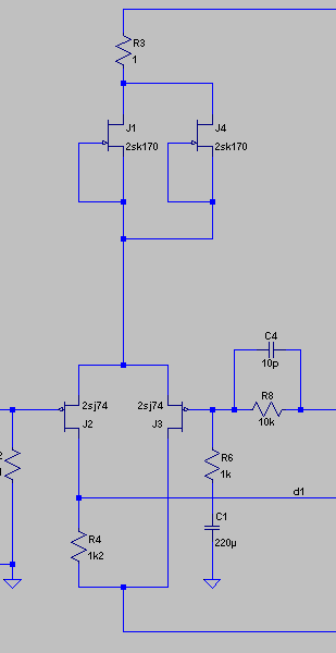

OK - looking at Grey's schmtc
to increase bias - increase value of R11 , say in increments of 10K
to adjust offset - instead of R4 , place in series 150R resistor and 100R trimpot

There are 2 approaches to raise the bias, increase R11, decrease source resistor, or both. My question is, which one is better and why? R11 seems to be much simpler than changing all the source and series resistors. BTW, I used the later to bump the bias.
Just decrease the source resistors. Changing r11 will have almost no effect on the dc bias and changing it will mess up the active behavior of the current source. It would
probably be ok to just decrease R18 and leave the other source resistor alone.
I lowered the source resistors by placing a 2.2R across them resulting in a ~0.39R. Bias current now is ~1.05 amps. That's better. DC offset is ~56 mV.

I went out to get some 1R / 3W resistors. Source resistors are now ~0.32R. I now have the mini-A idling @ 1.25 amps with a heatsink temp of 40°C (104°F) at 20°C ambient. A nice stopping point IMO.

say that goal is to have around 500-600mV across source resistor ;
source resistor is for coarse biasing , "R11" ( in that schmtc) is for fine bias adjusting

every Aleph ( implementing active CCS , so called Aleph CCS ) will have max current peak in range of twice Iq
Using Ohm's Law I was able to get the bias current I wanted by lowering the (combined) source resistor. Fine tuning with the source resistor is also possible, wether it's an elegant solution is another matter.
I now have both channels idling at ~1.25 A, heatsink is ~41°C (~21°C above ambient). Since it's only about 12 Watts per channel it's not a very powerful amp but the sound is phenomenal. Think quality rather than quantity. Tremendous clarity and depth, even at low listening levels. I'm very pleased with the results. And with autumn and winter coming it serves a dual purpose because it also is a wonderful heater. 😀
