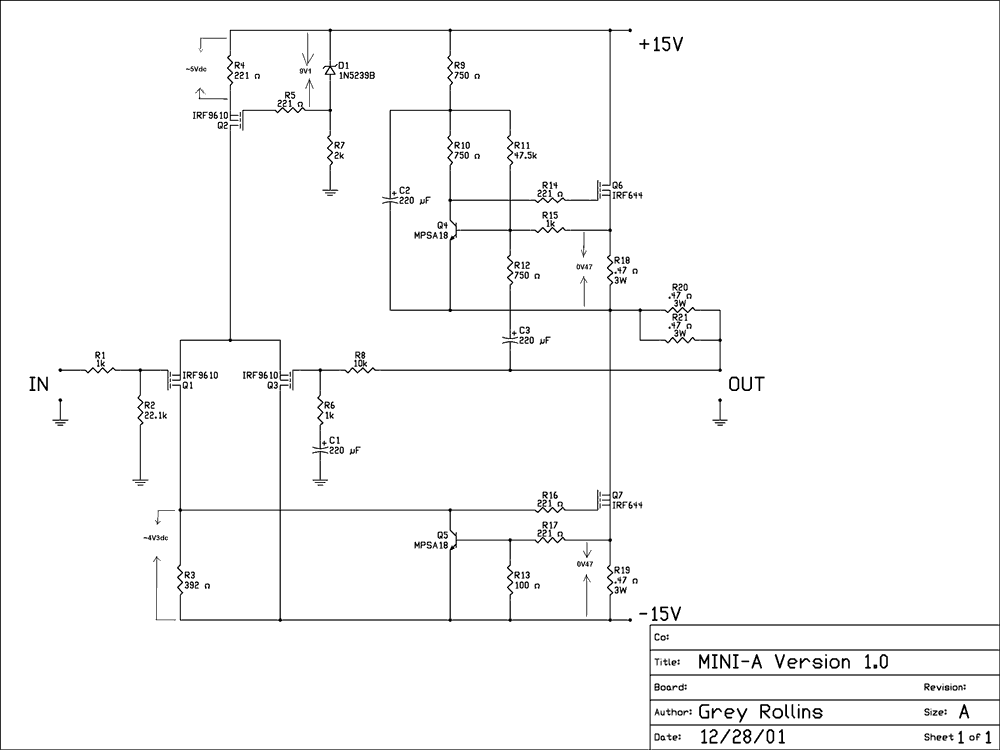

OK here's my mini Aleph:
Got my transformer today (Amplimo 2x15V / 160VA) and now have one channel wired up. Flipped the switch and then nothing happened, no smoke or noises. That's good! After that the left channel heatsink started warming up... Woohoo, it's working right at the first time!
Rail voltages are 18.4Volts. Voltage across the source resistor (0.47R) is 0.402 volts meaning a bias current of ~0.86 Amps. A bit too low, will it increase once it's properly warmed up? If not I'll have to solder a resistor across the 0.47R.
DC offset is ~70 mV, a bit high. Again will see what it does after an hour or so.

Well an hour has passed. DC offset is still ~70 mV. Any method of lowering that?
Voltage across the source resistor is 0.40 volts resulting in a bias current of only 0.85 amps. There's room for more bias current as the heatsink is only ~36°C (~97°F) at 20°C ambient temperature. How can I achieve a specific bias current predictably, or is it just a matter of trial and error?

gimme schematic here and I'll tell you what to do
I'm using the black PCB's from BrianGT. I don't have that schematic at my disposal. There's Grey's schematic of course but parts numbering between the two isn't identical.
OK - looking at Grey's schmtc
to increase bias - increase value of R11 , say in increments of 10K
to adjust offset - instead of R4 , place in series 150R resistor and 100R trimpot
