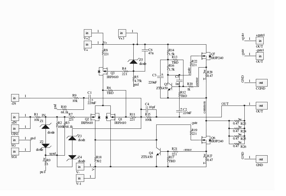

OK. Tonight I had the amp open looking at what it will take to replace Q1/2. While going over the boards I noticed something very odd. R13 had a broken or cut lead. The resistor had been mounted way above the board and as far as I could see had one side disconnected(cut) even though both leads were soldered. I figured that either it had snapped from some fluke. While getting ready to solder the two disjointed ends I noticed that the other R13 on the other board was similarly "cut".
Is this just a remarkable coincidence or did the creator snip it to take it out of the circuit on purpose? I do notice that the amp runs a little cooler with the resistors now back in the circuit.
Any ideas?

Yes. I bought it on A-gon to use while building out Brian's boards. ironically, as it turns out is uses Brian's "black" boards!
It seems to use good quality parts although the builder did substitute 2sj74's for Q1/2 and seems to have left out a few other parts on the input. It sounds good although I need to work with it a bit to get the DC offset down on one channel ~90mv.
Here is Brian's schematic although my guess is that you are familiar with it. Sorry to not have included it...
On Brian's BOM it is listed as being 47.5K.
R13 is snipped to ensure max possible bias of output mosfets , dictated solely by value of source resistors ;
without looking at your previous posts ..... give us few measurements data :
voltage across R28 or R27 , and value of these resistors ,
PSU voltages ,
value of R8,Z5,R18 ....... to check is it conversion to Mini Aleph J made without risks to input jfets
then I'll tell you how to set output offset without hassle of replacing input jfets

Here is a bit of info from both channels:
R28 = .9/1.0 (in place)
R27 = .8/.9 (in place)
Supply is = +/- 17.64
R8 = .786/.769 (in place)
R18 = .995/1.012 (in place)
Zener - can't read the marking. Would I just measure the voltage drop across it?

Ok. With a steadier hand I ventured into the power amp and took some more readings. Here again I may share more ignorance than offer information...
The voltage across Z5 is 9.84v.
R28 measures .391v with one probe on ground and the other at the junction with R20. I read the color bands to be R=0.46 10%
R27 measures -17.55. I read the color bands to be R=0.46 10%

Ok. I am going to take a stab at answering my own questions.
Regarding bias and R13. I got a reply from the builder and he snipped R13 to max out the bias at about 1.5 amps. Based upon his reply when I reconnected the 47K resistor I basically cut the bias in half. It definitely changed the sound but not for the better. With the resistor disconnected and the bias about 1.5a I could put my hand on the heatsink for about 15 seconds. 1.5 amps is probably max but workable so I will probably leave it disconnected.
Here is what his answer was:
"R13 is the dc bias resistor. snipped to full open let run at 1.5amp or so of bias rather than 1.1-1.2 amp if had 100k in there... tricky as orig aleph circuit has that resistor hooked up tiny bit differently, same purpose though (dc bias). Typically a 100k gives little over 1 amp, 150k 1.3 amp or so... 47k .8 amp."
My second question was the 90mv of dc offset. Reading Brian's schematic and comparing it to the Pass Aleph 30 schematic that I was pointed to it looks like R6 is used to adjust offset. The Pass schematic suggests 10M to drop the offset from ~100mv to a small number. Since the original builder of my board did not populate R6 this seems like the easiest solution as I could probably add it without pulling the board.
Am I on the right track?
replace R8 with 100R resistor in series with 100R multiturn pot
tweedle with pot , and you'll make offset vanish 😉
but - you didn't answered on all of my questions , so I can't tell you comment on what I'm also interested - what's current through input LTP
if values are as in original MiniA , then is possible that input Jfets are nearly overcooked .... but (skipping now to your previous post ) - looking at voltage across R8 (0V77? ) , if R8 is 220R , then input stage is starved ....
is it possible that you make new schematic , with exact part values , as they are on pcb ?

Ok. I see a problem. The values I posted were resistances, not voltages and I did not note that. And just to be really confusing I put in the values for both channels. I will edit them.
R28 = .9k ohms/1.0k ohm (in place, across the resistor)
R27 = .8K ohms/.9Kohms (in place)

Measuring the voltage across R8 I get -8.23. The color code on R8 looks to my eyes like Br/Bl/Bl/Br/Br. Is that 1K 1%? ...which would be different from Brian's.

hold your horses ! 😉
R28 and R27 must be in sub-ohm range .....
ok ; we are going to do it this way :
gimme :
R8 resistance and voltage across
R18 resistance and voltage across
R27 resistance and voltage across
R28 resistance and voltage across
Z5 voltage across
all resistance READ from part , do not measure in circuit
measure voltage ACROSS the part , not ref to gnd
I don't care for other parts - don't bother your self with schematic
and - give me values just for one channel - presuming that parts are the same on both channels , and that voltages are in 5% .

Ok. No smoke, no shocks. I got the voltages across each device and read the resistors as best that I could. On for about 10 minutes. One channel only...
R27 = .47ohms with -.628v across it.
R28 = .47ohms with +.628v across it.
R18 = 1Kohms with -2.54v across it. (sort of drifted a bit)
R8 = 1Kohms with -8.69v across it.
Z5 has -4.59v across it.
R18 and R8 looked the same to me as far as the color code. br/bl/bl/br/br
Thanks for your patience!
OK
as I said before - replace R8 with 680R+500R trimpot in series ;
then adjust DC offset with that trimpot
which output mosfets you have in amp ?
2V54 looks somehow low for IRFP needs ....
