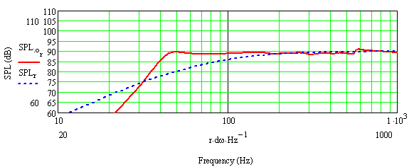

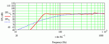

Not an ideal match, but you could always have the first pair of aperiodic metronomes. 60in tall, So= 4in x 3.5in, Sl=11in x 14in. Drill a 7/8in hole in the bottom and stuff with reticulated foam.

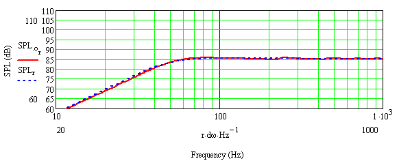

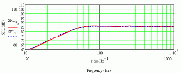

F120a Metronome.
48in tall. So=2in x 1in, Sl=9in x 6in. Zdriver 24in. Vent 2in diameter, 2.5in long.
I like the look of the 120a. I've only heard it's big brother once(please Uncle Fostex: will you make an F160a? And while you're at it, an FX160, and put the FX200 back into production too) & I came away thinking I'd probably do anything up to and including robbing a bank so that I could own a pair. I feel the same way every time I hear a pair of FE208ESigmas, but as I'll shortly have those (heh heh heh... mine, all mine...:devilr:) , I'm at less risk of an unfortuate encounter with the gentlemen of our police 'service.'

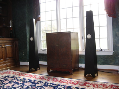

Finished my FE127E Metronomes
These are the single driver version, not the bipole. They have a holey brace. The back of the enclosure from 12 inches below the driver up to the top has 1/2 inch acoustic foam. They were covered using the black ash vinyl laminate from parts express.
I'm very impressed with the amount of bass these are putting out. I was using the reference project enclosure before. These definitely are an improvement in the lower octaves. On music that is fairly simple - acoustic guitars, string quartets, vocals - they sound great. On music that is more complex like big band, they get a little congested and boxy. I haven't tried adjusting the stuffing to see if it improves. I'm a little limited on what I can change now since they are all glued up, but I can always add some polyfil.
