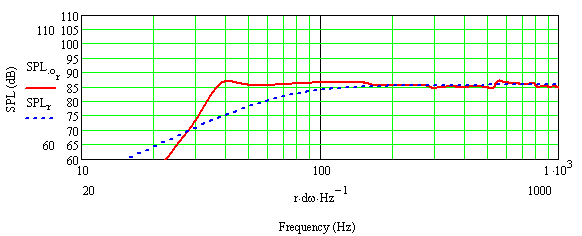

Hi everyone, my first post on this forum. Thanks to this thread, this will be my first DIY project. Im one of those who likes to know everything before I start so a few questions....im really new to the field so...my jargon isnt that good btw. My only saving grace is that i have a fairly good ear and a passion for music
My original plan was to use the Fe108sigma build because it was the shortest box i could get. But after visiting Planet_10, it looks like they have some nice drivers as well that i can pound out of the standard 4x2 sheet
what do you guys think about putting a Modified FE126e or FE127e or a Creative Sound FR125S in there? What would i have to modify?
SunDragon said:what do you guys think about putting a Modified FE126e or FE127e or a Creative Sound FR125S in there? What would i have to modify?
We haven't figured a Met for the FR125S yet, but a suspect we could get Scott to run the sim. The FE126 & FE127 are both in the table. My felling is that the 127 is probably a better choice than the 126 (Bipole 127 is high on my list)
As to the choice of CSS or Fostex, that may come down to the amplifier that you are using.
dave

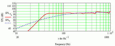

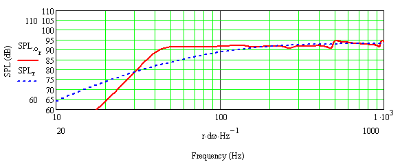

Scottmoose...
If you have the time, can you please run a Metronome sim for this driver? I'm considering using pairs of them in a Metronome bipole configuration with a ribbon tweeter. How do you think it'd do?
Here are the specs:
PHL 1230
Efficiency: 93db 1W/1M
Impedance: 16 ohms
Fs: 45Hz
Re: 12.1 Ohms
Qms: 3.1
Qes: .27
Qts: .25
Cms: 1000
Sd: .0143 square meters
Vas: .030
Xmax: +/- 3.5mm
Here's a link to the data sheet:
http://www.phlaudio.com/datasheets/17_pdf/1330_1290.pdf
Thanks!

Scottmoose said:And this is the shorter 167 Metronome I was asked about a while ago.
55in tall, So=3in x 2in (WxD), Sl=11in x 8in (WxD), Zdriver 27.5in, vent 3in diameter, 3in long.

As in those with Hemp drivers IIRC? Dimensions are up on the frugal-horn site: http://www.frugal-horn.com/metronome-table.html
