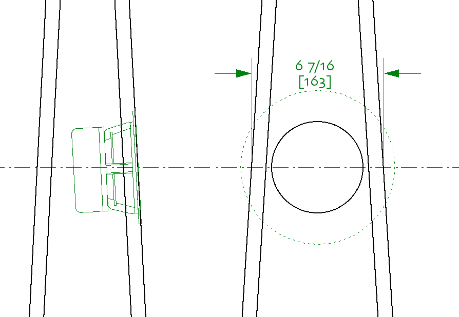

I'm thinking of a Jim Griffin JX92s/G2si Metronome Hybrid. Jim's TL was designed for a baffle width of 7.5 inches. How hard would it be to adjust the crossover for the ~9.5 inch baffle?
The WAF is greater with the 'nome than the TL.
bluegti said:I'm thinking of a Jim Griffin JX92s/G2si Metronome Hybrid. Jim's TL was designed for a baffle width of 7.5 inches. How hard would it be to adjust the crossover for the ~9.5 inch baffle?
If we assume that the unspecified Zd for the JX92 met is 50% & that you use 18mm BB to build it, then the baffle width at the driver is 6 7/16". This isn't all that different. Still a supraBaffle might well be indicated to reduce the constriction the driver magnet causes.
You could also get the width out to pretty close to 7 1/2" by adding a (close to) central front-to-back driver/cabinet brace.
