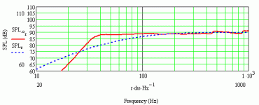

So I have this pair of FE166ES-R's, which have sat in their boxes since I bought 'em almost two years ago. Lately, I've been feeling guilty each time I see those boxes in the closet.
So many projects, so little time. But, I think it's high time I got these drivers into a set of enclosures, making music!
I had been thinking I'd build a pair of BiBs for these, but maybe I'm glad I waited, because after hearing (and seeing) lousymusician's hemp FR8 Metronomes at BAF, I think I've changed my mind. I'll have to go back and read through this thread to get all the details, but unless the numbers just don't work well, I think I'm set on building the Metronomes. They look and sound just wonderful, and I'm guessing the 166es-r would do very well in this design.
Could someone do me a favour and calculate the box dimensions?

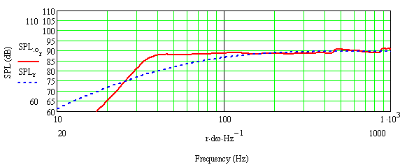

The T-S parameters of the B20 are so similar to the FE207, wouldn't it be a drop-in replacement for FE207 Metronome?
holdent said:The T-S parameters of the B20 are so similar to the FE207, wouldn't it be a drop-in replacement for FE207 Metronome?
If they are anywhere near close, yes. The Mets are quite tolerant. Scott wil get back. It may get better with a slight port change.

The FE166ES-R can be made to work: 60in long, 30in Zdriver, So=2in x 1in, Sl=12.25in x 8in, 3in diameter x 4in long vent, and 6ohms of series resistance.
Strikes me as being a bit of a shame to use ES-Rs like this though as efficiency in particular is crippled to sub 90db levels. It'll certainly be better than the regular FE166E, and that huge motor will give excellent detail, but the ES-R wasn't really meant for this sort of load -it was designed with horn / quasi-horn loading in mind & if you want to get the best out of it, that's what you'll have to do. If the more complicated horn cabinets are out, I'd stick them in a pair of BIBs, where they'll be much happier.

Yep, 6ohms needed. That's a driver with a very high power motor in a cabinet that it's not naturally suited to.
Scottmoose said:B20 will sound suitably large in the LF in the 207 Metronome -just increase vent length to 4in.

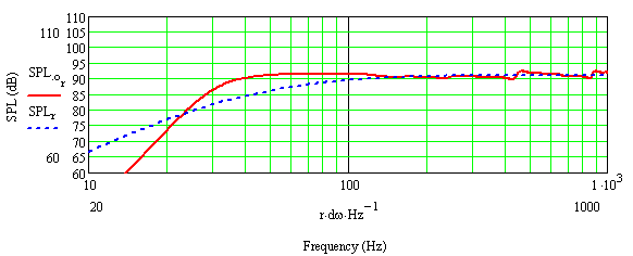

Am I reading this chart incorrectly or is the upper frequency limit at 2,000 Hz rather than 20,000 Hz? I wonder if using the Pioneer driver in a Metronome enclosure is worth the effort, or if I should go with a Fostex FE-207 or Hemp Acoustics FR8c instead.
Also, the influence of most back-loaded boxes is pretty much over & done by 1KHz. In most cases, you're really only using the enclosure to support the frequencies below the mass-corner of the driver where the response starts to roll off. You'll have some baffle-step and edge diffractions below 1KHz too, but generally, unless you're attempting something fancy, above that point the real job of the cabinet is to provide a solid mounting point for the driver.

Scottmoose said:The FE166ES-R can be made to work: 60in long, 30in Zdriver, So=2in x 1in, Sl=12.25in x 8in, 3in diameter x 4in long vent, and 6ohms of series resistance.
Thank you for running the numbers Scottmoose. Looks like you're right, ML-QQWT would be a big compromise, BLH is really what these drivers want.
This puts me in a bit of a quandary. The BiB looks like a really good design for the 166ES-Rs, but I realize now why I wasn't in a hurry to build them - they would simply be too physically imposing in my small apartment, dominating the space and making the room feel claustrophobic (presently, I'm recalling scenes from Space Odyssey 2001...). The Met's offered the possibility of a slender cabinet which wouldn't crowd the room, despite being tall. So, for the ES-R's, I think I'm back to square one: the folded-horn plans on the Fostex datasheet. Not terribly small either, and a bigger challenge for me to build.
