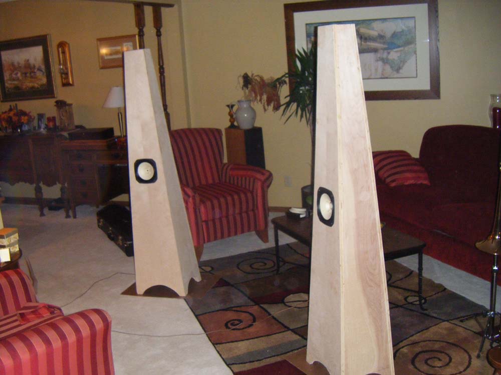

I have a report on a FE166 metronome pair I put together this weekend...
Built exactly per the plan on the frugal-horn site (thanks!)
Included BSC circuit as recommended.
Cabinets went together fairly easily with lots of clamps (despite the weird angular shape...)
Sound Impressions:
**DISCLAIMER: the cabinet has not been stuffed, or lined in any way- naked plywood inside, no mods on drivers**

Ok, heres the deal... (Note: They need the "Loudness" switch on my old SS reciever to be in the "on" position, or else they sound thin...) These speakers model down to 40Hz, and I think they get there- very low bass for this little driver, so in that, I'm impressed - however, when you drive them to much more than a whisper volume, the speakers begin to sound flabby; to achieve significant volume, the "loudness" needs to be turned off- but then the thin sound returns. Also, I notice that when driven, the cones really move! (I think more than the Xmax parameter says they should) Is it possible that I have unrealistic SPL expectations for this system? They definitely cannot keep up with my 2-way Klipsch home theater towers (spl or bass wise)...
Midrange: This is the big hitch... Very "shouty" upper mids! I don't have too much test equip- but I would say that somewhere slightly below 1khz, there is a huge peak, and it is a little distracting/ fatiguing... any suggestions? please?

And a pic!

Tony,
I can think of a few reasons your Met's bass is MIA. First, you say you're using the Fostex FE166's. I don't remember a design for the 166's, only the 167's. The lower Q of the 166 would result in less bass, especially with a SS amp ahead of them. A resistor in series with teh + lead to the driver might help resotre some bass (at the expense of burning some power in the resistor). Scottmoose could probably advise if a port change would be advised to adapt the 166 to the 167 cabinet.
If the drivers are brand new, you'll need to give them lots of time to break in before they sound like they should. The Hemp Acoustics drivers in my Met's took MONTHS to fully break in, and I nearly gave up on them while I was waiting! They sound much smoother now, it was worth the wait.
The lack of damping in the cabinets may be adding to the midrange 'shout'. For mine, I bought a yard of fine netting at the fabric store (like for a bridal veil), and cut a tapered 'sock' the rough size of the cabinet interior, and long enough to reach a bit below the driver. I sewed up the sock with heavy thread, filled it with teased out fiberfill, and closed the bottom with a drawstring so I can open it for adjustment. I can get the sock in and out through the driver hole. A string is stapled inside the cabinet a little below the driver to hold up the sock. I used something under a pound of fiberfill per speaker (roughly 0.5 lb/ft^3, which IIRC is MJK's recommended starting point in his MLTL designs) and I have never felt the need to go play with the stuffing after that. The cabinet is otherwise unlined and unbraced.
One last thing, your photo shows the speakers well out into the room. You may want to try them closer to the wall. If that restores some of the bass, you may need to either keep the near-wall placement, or modify the BSC to your taste.

You can artifically raise the Qe & Bl factor of your 166s by adding a 4 - 5ohm resistor in series with the driver. That should bring the bass up, and take down some of the midrange that's bothering you. You don't say what your amp is, but with the exception of some class T amps, and Nelson Pass's Zen & First Watt designs, this is not a driver that likes low output impedance solid-state amplifiers at all, without some series resistance to reduce it's damping factor. This will reduce the efficiency, but rebalance the sound.
The internals require some damping -at the very least, line the rear panel from the top to just below the driver to prevent any reflections from the rear wall coming back out through the cone.
The cabinets are specifically intended for near-wall placement, so try experimenting with the position a bit.
Finally, the 166 is known for a somewhat forward midrange. Phase plugs will help here, as will some basket damping etc.
For future reference, the FExx6E and FExx7E series units all have very different parameters -it's more than just shielding. The up-side is even with series resistance added, the large motor of the 166 will provide good detailing, so it's not a disaster.

Basically what's happening is the FE166E, being a low Q unit (i.e. it has a light cone, stiff suspension & a high-power motor etc.) is naturally well-damped (arguably overdamped) in the LF. Now, if you combine that with an amplifier with a low output impedance (high Damping Factor), the amp can't help correct for this damped LF behaviour / low driver Qts. High DF amps work best with high Qt drive units, which are underdamped in the LF. Conversely, a high output impedance (low DF) amplifier will work best with a low Qt driver and / or system where their own relatively underdamped response in the LF will help raise the overdamped behaviour of the drive unit in the same region. It's all about getting the balance right.
Adding series R will artificially raise the Qt (actually the Qe and Bl) of the drive-unit, which has the same effect as lowering the DF of your amplifier. That amp will need changing at some point as it's not the last word in sound-quality, but at least with series R in place you'll be getting some well-rounded bass. At present you'll have a decreasing response below the driver mass-corner with a peak at Fc -worst of both worlds.
