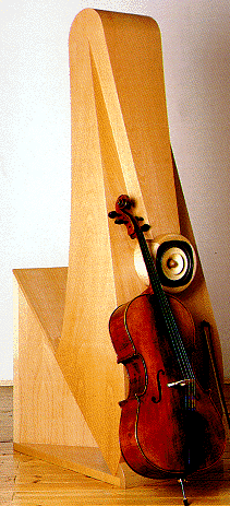

gurley123 said:rjbond3rd,
That's a nice cab you have pictured there. Is that a Lowether?
Hi gurley123, I believe it's a no-longer-made Carfrae with a Lowther. It looks like a Metronome that was literally folded, does it not?
Originally posted by rjbond3rd I believe it's a no-longer-made Carfrae with a Lowther. It looks like a Metronome that was literally folded, does it not?
It looks nice is what. I really like that big deflector.
