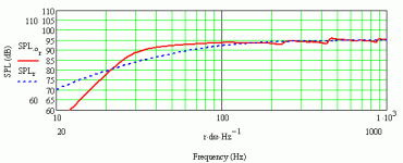

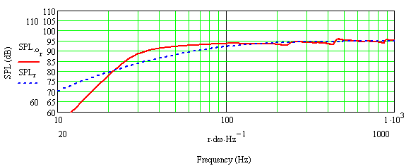

This do you?
Line 60in
Zdriver 30in
So = 4in x 5.5in (WxD)
Sl = 14in x 12in (WxD)
Vent = 3in diameter, 2in long. Usual damping proceedure applies.

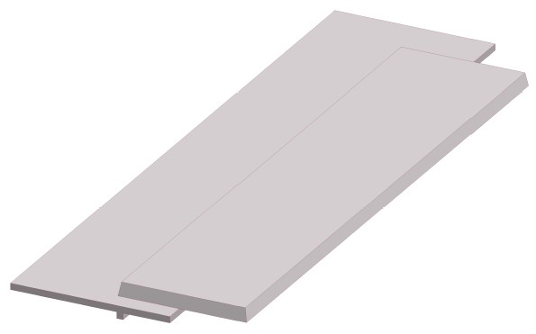

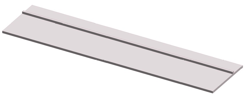

I've been asked this question many times recently so for those that don't know what a sliding taper jig is..here is a pic.
I've drawn it upside down to show the guide.
The guide runs in the slot on the table saw. The work piece is stuck to the jig with blue-tac or double sided tape, with the required cut aligned to the edge of the jig.
The edge of the jig is right up to the blade.
Regards
Ed

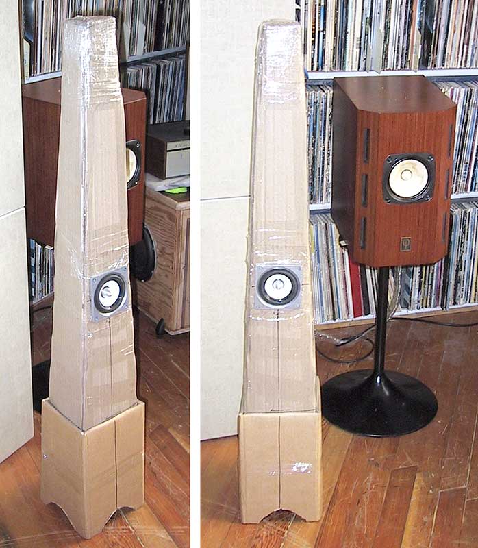

I wanted a Metronome in the house just to be able to live with the shape for awhile... our official Metronome project is way down in the queue, so a recent post reminded me that cardboard was an easy to use material for whipping up "working mockups". Here is a picture of one of the almost finished unobtainum 3" TB cardboard Metronomes... Fonken in the background for scale (these metronomes are a bout 1m high)
dave
