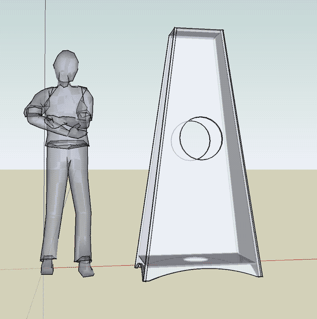

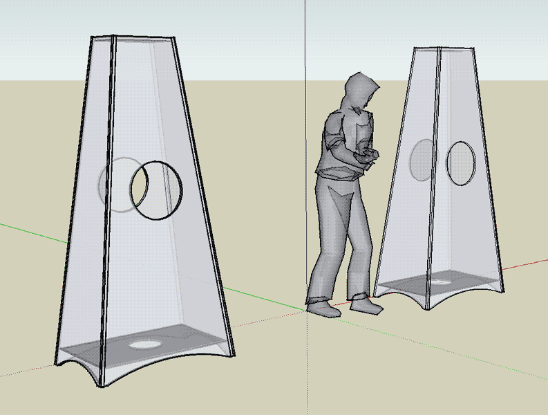

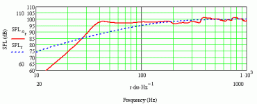

Did someone mention Metronomes with a pair of 15in co-ax units?
No problem at all. Here's one for the P Audio BM15CX38: http://www.speakercity.com/Merchant...C&Product_Code=BM15CX38&Category_Code=PA-COAX (not cheap, but possibly good).
Line 72in
So=65in^2 (I used 6.5in wide x 10in deep)
Sl=360in^2 (I used 20in x 18in)
Zdriver 34in
Vent = 8in diameter, 0.75in long. Line the cabinet, or stuff 0.25lbs ft^3 above the driver. Might need a suprabaffle for mounting the driver to.
