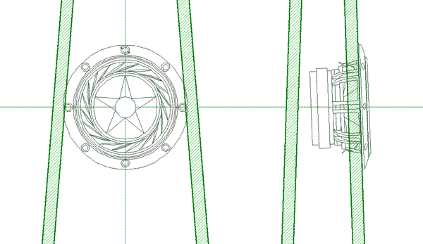

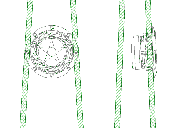

The 168 sigma driver has a depth of 4". My crude maths suggest this won't fit the dimms listed in the table as Si 10" by 6'' and So 2.5" by 1".
For the side panel I need to loose 5" and at the half way point for the driver the depth will be 6" - (5"/2) = 3.5".
There won't be much room to sit the driver either which has a diameter of 7.5", and I need to loose 7.5" in the taper, so at the mid point I will have 10" - (7.5"/2) = 6.25"
Are my maths flawed, would a supra baffle be the way to go? Does it looks a very tight fit for the driver to "breathe"?
Cheers
Scottmoose said:
Suprabaffle = best way forward.
A supraBaffle is recommended, and as much to give a little less restriction in the line as to help push baffle-step down.
In the case of the existing suggested dims it is a case of just fits... you could change the base dimensions to 12x5 and get a bit more sideways room.
dave

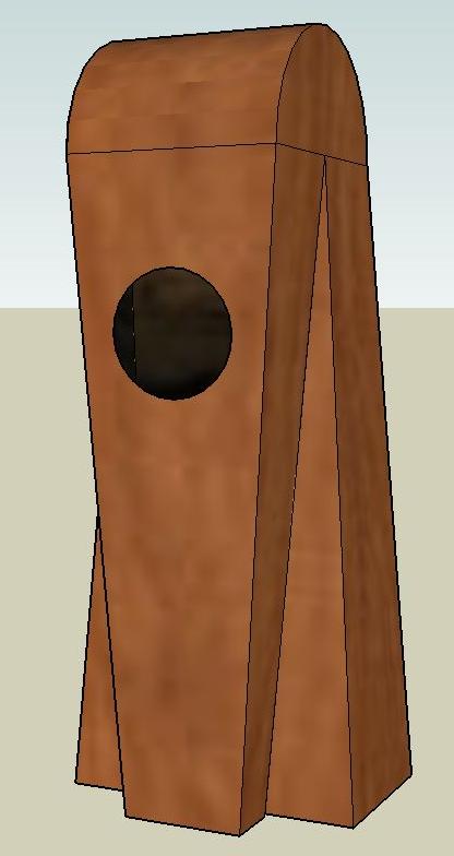

Here is a model of the speaker to better give an idea of the shape.
dave
