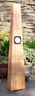

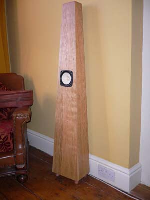

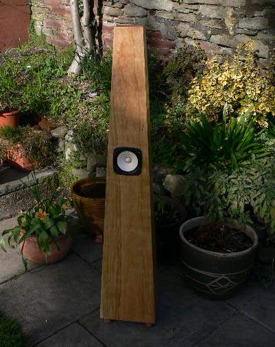

yeah, well, I couldn't help myself... Especially as the misses decided that they would look better slimmer, and she's right - they do. I'll report back on the final sound when the second one's finishes, maybe tomorrow.
So, just finished listening to my newly sized FE127e Metronomes. They used to have external dimensions of 7.9 x 9.5” and 4.7 x 4.3”. Now they are at the design size of 6.54 x 9.5” and 3.2 x 4.3” (these dims were chosen to give an internal golden ratio when using 18mm ply). First impressions – they look much better in the new sizes! Pics to follow, if I can steal a digital camera. Listening – they always were great, now they simply sing. The mids and imaging are just stunning and there is easily enough bass for my taste. I went to see Lucinda Williams at the Birmingham symphony hall a while back - it’s a place with terrific acoustics. Listening to her new CD takes me right back there but this time with a better seat. There is a small tendency to boomy bass at a couple of frequencies. I’ve pulled them away from the wall but it doesn’t seem to help, in fact the wall reinforcement seems to augment the overall sound. I’ll play around with other factors, but I’m new to this so if there is a standard method to tune speakers of certain qualities don’t be shy letting me know.

Great looking speakers Gus.
Hope you don't mind but I've nicked a couple of your images to post on the
World Designs Metronome Thread in the UK
