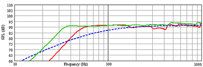

I'm really taken with this design. This will be my first build, but I'm really torn about driver selection. I have a friend coming over from Japan who will bring me some Fostexs.
My room is largish - 5 by 6 metres, my tastes are rock/pop/electronic/jazz. Amplification will be a Charlize T-Amp. My inclination is the 168sigmas instead of the 207. Iv'e heard the 168s in a BIB and was very impressed - plenty of bass and dynamics, but the BIB cabinet will be a little over powering for this room and corners are limited. Another choice could be the F120A, but not that efficient?
Any thoughts anyone? I'm a bit concerned the 207 will be shouty and harder to live with that the 168.

NICKEL said:Any thoughts anyone? I'm a bit concerned the 207 will be shouty and harder to live with that the 168.
I've only briely heard 207, and not even seen a 168 yet. I have a set of 207s here (+FT17) for a set of Bruce... your room isn't as large as mine, so unless you like LOUD level with either & your amp should be fine level-wise.
Let me throw you a curve... bipole FE127. Althou -- if i could afford to keep any of the box of 8 207s i just got, i'd be thinking of a bipole with 207s.
dave

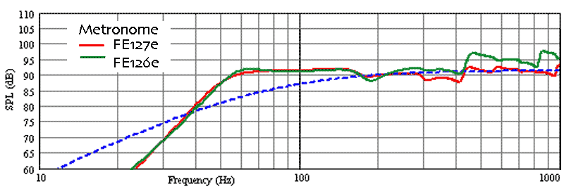

Can you compare/constrast the bipole 127 vs 126? I was all set to go on the bipole 126's, but you've mentioned the 127 version more than once. So now I'm pausing ...
Ryan
planet10 said:Let me throw you a curve... bipole FE127.
dave
Dave,
Ryan

planet10 said:Here is an "estimate" i only had a bipole FE126e sim so had to eyeball the relative level...
dave
Thanks Dave!
Ryan
