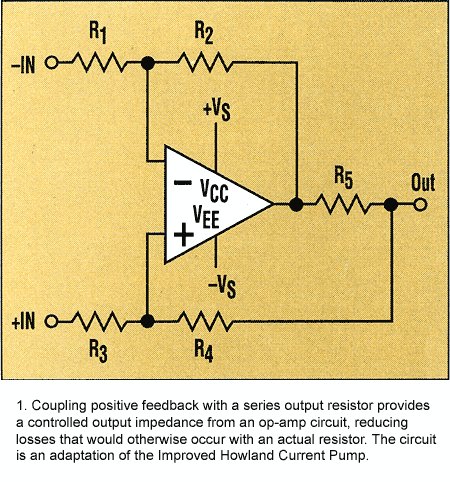

I've got a dumb question 😀 Is it possible to get properties like you mentioned above with feedback amp? One example, how to make intentionally low damping factor with global feedback amp?
The correct one
Here's the correct circuit. The value of R1 will be multiplied by the amp gain.
RF1 and RF2 are the existing amp's feedback resistors. As shown, Zo will be about 2 ohms for an amp gain of 20.

lumanauw said:
Hi, Jorge,
What I'm thinking is decreasing, not increasing.
Have you built it? How does it sounds?
Mauro build similiar cct (but different) with gainclone.
Again, I was with my head in other matters...
The circuit will DECREASE damping - rise output impedance. As I've said in the second post above, the 0.1 ohm resistor (very little loss) will behave as a 2 ohms resistor for a closed loop gain of 20 (or 1.5 for a gain of 15, etc)
I have not tested it in the last 40 yrs or about...
There was a time when some tube amps had a pot and a circuit similar to this one so user could adjust bass to his taste.
If you want to experiment, place a a low value trimpot (say 50 ohms) in parallel with the 0.1 ohms resistor.
With the pot at the ground side, output impedance will be the amp's plus 0.1 ohms, with the pot at the speaker side, it will be about 2 ohms (depending on amp gain, as stated above).
Use a fairly high wattage resistor for the 0.1 ohms (like 2W - parallel a few lower watt ones).
Ciao, Mauro

Mr Evil said:
If you reverse it and use positive current feedback then output impedance can be reduced below zero and overall damping can be increased to infinity.
To almost infinity - it will oscllate by then...😀
I've never liked positive feedback in amplifiers due to it - high risk of instability.

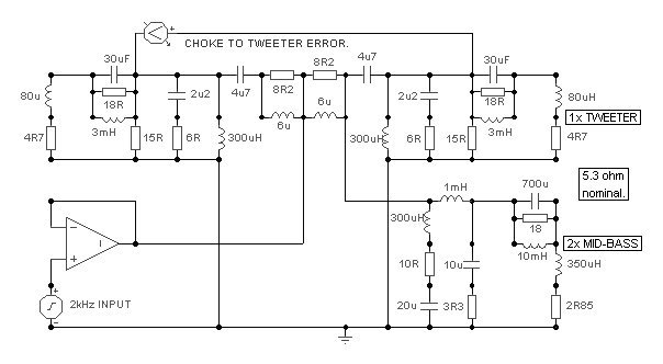

I have pulled out of the thread you reference ( started by Jorge ) due to personal criticisms and 'smart-****' responses aimed at me; these being due to nothing less than a lack of necessary study and thorough 'pre-post' thinking.
Andy C. wrote that he was going to check out my suggestion that speaker cable induced voltage distortion arises due to series impedance and composite loading.
I very much look forward to reading his findings.
I have dug out and offer this test circuit as a starting point for anyone who doubts the existence of back-EMF, or its distorting influence upon hf audio reproduction.
Cheers ........... Graham.
