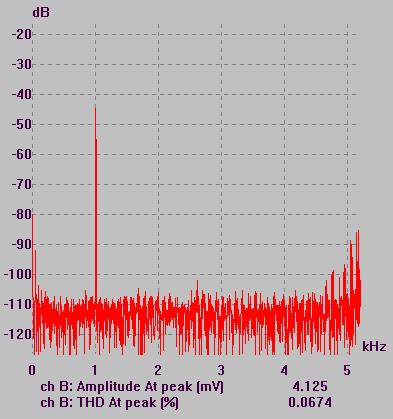

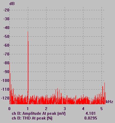

a "real" load; I don't have a "saved" slides, but a simple esample on a loudspeakers ESB QL65-A @3Vrms 1Khz (not high Back_EMF zone but I have "see" an analogue phenomena @ LC & Motor load at anothers frequencies). The amp not is DSLI but my 2030 high damping. When will have other measures on this load will show you.

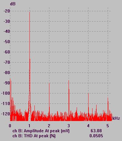

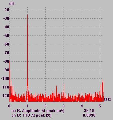

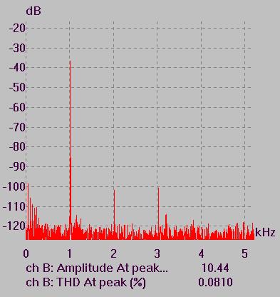

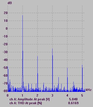

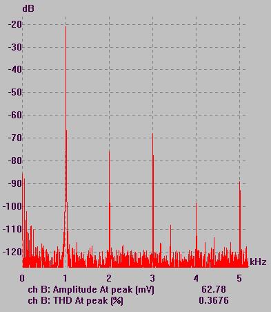

mauropenasa said:P.s: My measures are a "preliminary" value, and a "direct view" without
optimized. .....
Excellent Mauro.
Now post #381 is resistive 8 ohm load and post #385 is corresponding voltage, so spectra should be identical. They are in quite close agreement, differences probably due to changes in measurement setup.
Post #384 I assume is current spectrum for same voltage as above. Not unexpectedly the load's nonlinear nature comes through.
Then there are posts #388 for voltage and #389 for current. Problem is we do not know if this corresponds to the same amplifier (seems it is not), so we cannot segregate which distortion components are contributed by the amplifier itself, and what results from nonlinear loading on a relatively high output impedance one.
It should be important to get this clear. For example you can replace in this last case the speaker with a resistor and acquire voltage and current spectra for the same output voltage level.
Rodolfo

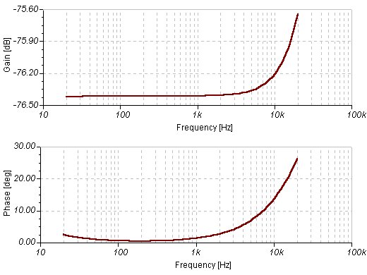

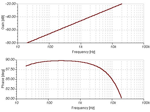

See attached amplitude/phase characteristics for the circuit I illustrated in Post#174.
Clearly that amplifier's output stage is inductive, and thus phase shifted load current is going to generate an error voltage, which if sufficient in level, could fractionally overcome forward output bias, as illustrated in Post#175.
A 4 transistor JLH amplifier might have a much lower damping factor say 30-32dB, but its angle is zero degrees at 1kHz and just +/-10 to 15 degrees at 100Hz and 10kHz depending on transistor choice and output capcitor value. Thus the out of phase component generated by the amplifier itself has a lower value.
Cheers ......... Graham.

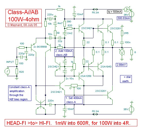

It is the neutral loudspeaker driving response of JLH based amplifiers that have always appealed to me, and yet even if you go up to 300-400W of heat dissipation they still do not have Pop-dynamics capabilities.
I have gone backwards and forwards though JLH based circuitry many times over the decades, and there has always been a trade off between phase coherent output damping and overall stability.
The attached amplifier is neutral, powerful, performs cleanly and has been nicely stable during use.
The next attachment shows its simulated output characteristic. Further improvement might be possible, but its already good, so I'm still thinking.
Cheers ........... Graham.
