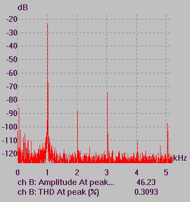

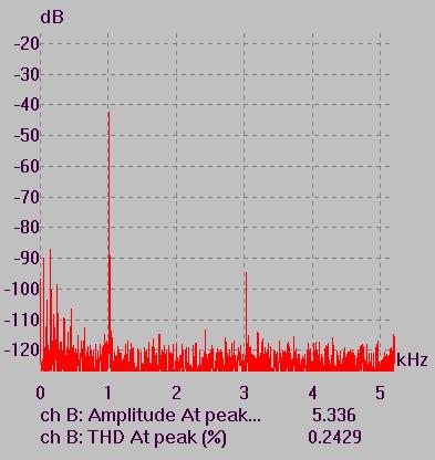

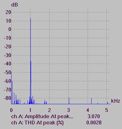

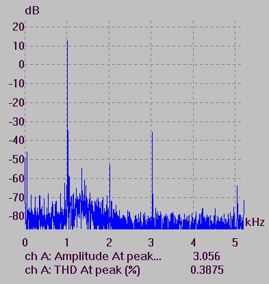

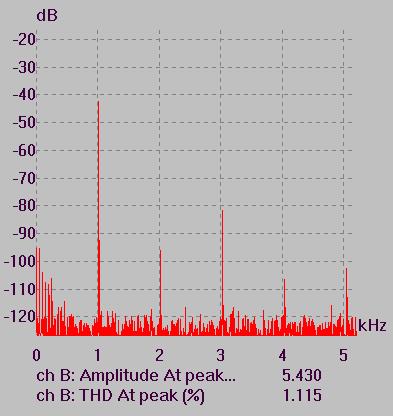

Hi Graham, have had little time, and am "buried" by a series of FFT that have performed and that have to analyse with calm.
In particular, have tried to isolate the dynamicses of pilotage of reactive load and real with current driver and voltage driver. They see well the behaviours of the "dynamic" damping and the "indestructible" nature of the Back_EMF . I am looking for of "paste" this test to the exhibited theories in this THread, but me maids of the time not to draw conclusions " too " make a mistake. To purpose of discussion, you show you some results:
This is a typical Voltage FFT @3Vrms to my old load (Filter LC 1Khz +6 ohm serie + 220uH serie), amp=DSLI (D.Self L. I.):
Obviously with resistive load this THD corresponds to that of voltage THD. How to never the current has a THD of 1% ? To the experts the answer ( I I know but per hour he doesn't expose theories...). Hour show you the same load but current driver ( partially, width bridge current about 100ohm Zout): First the voltage FFT:
mauropenasa said:.....This is a typical Voltage FFT @3Vrms to my old load (Filter LC 1Khz +6 ohm serie + 220uH serie), amp=DSLI (D.Self L. I.):
Good job Mauro.
Did you keep the resistive dummy load or an actual speaker in your tests? If it is the former, current distortion is solely attributable to the back injection transformer magnetics. It should be interesting to repeat the test only with a speaker, without the back injection circuitry.
I go for the voltage mode drive for reasons I will post later. Let others voice their oppinion.

Hi Rodolfo, I have performed this test without any external signal, and the source of THD that sees is produced from the magnetic perturbations of the choke that I have used, and increases with the resonance of the LC.
I have used this setup because the resonance ( maximum point of Back_EMF and delta phase) is to an easy frequency by real-time analyse (without soft/hard -filtres ).
To demonstrative title I public 1 FFT with a 12V Motor load (7ohm Z & more Back_EMF @ all frequencies) Noted the simile...
Hi UnixMan, your link ( and your contribution ) is a lot of useful, because me allows to deepen of the theories that I had already realized, but had not read...
I like that my impressions on the better way for driver of loudspeakers is shared by other.
Ciao
Mauro
FFT1: Motor 3Vrms 1Khz (not resonance point, but some reactive load...)
Ciao
Mauro
