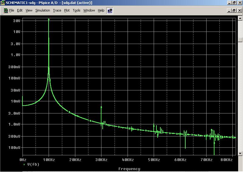

lumanauw said:
This is the second experiment. He intentionally feed the output of the amp (which is attached to dummy load or speaker) with outside signal.
The amp is having feedback.
I dared to simulate one of my projects and attach FFT of the result.
As you may guess amp is near full power at 10kHz.
