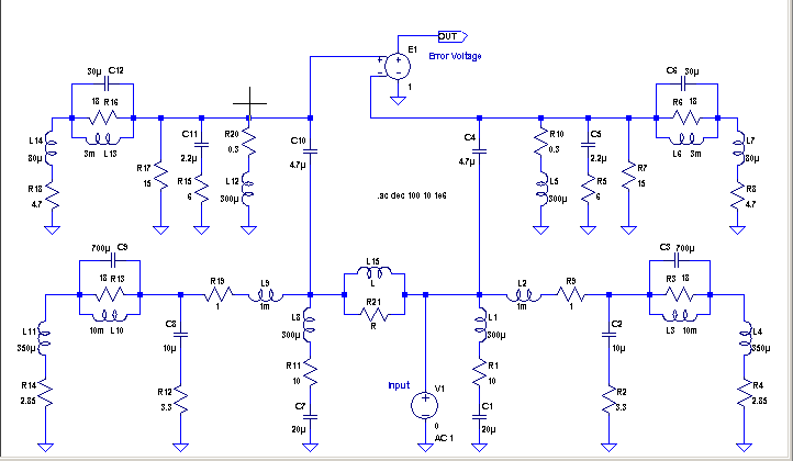

Graham Maynard said:Is there *ANYONE* who can run a 20kHz bandwidth wav.file into the 2003 circuit in my Post#439 above
Graham, it is morning here, and as I said I am going to try this out. First I need to write some code to convert my stereo WAV files to mono. This isn't very complex, but your patience is requested as the normal day-to-day requirements of living also occupy my time. I'll report some results Sunday.
I have some questions about your test circuit.. It looks like an ideal amplifier driving two simulated speakers, except that one simulated speaker has no woofer section. Now, I'm guessing that the parall R-L network of 8.2 Ohms and 6 uH is meant to model the amplifier's output inductor circuit, right? I'm also guessing that this is meant to be an argument against using output inductors. If that is so, then I'd propose the following change.
1) Make the simulated speakers identical, both with woofer and tweeter sections.
2) Drive one simulated speaker straight from the zero impedance source, and the other via a parallel R-L circuit.
3) Define the error signal as the difference between the tweeter simulated outputs.
I think this would represent a more realistic scenario, namely "identical speakers with two different amplifiers" and as such it directly addresses the issue of the output inductor.
Secondly, it appears that the driver portion of your simulated speaker is exactly identical to what PMA described in his earlier post. Namely, a series R-L circuit in series with a parallel RLC circuit. See the far right side of this diagram.. If we can agree that the back EMF of the speaker is completely modeled by this parallel RLC network, then I think it's safe to say that the entire discussion has been a misunderstanding in which the two sides of the issue are talking about the exact same thing in two different ways.
Here's an example of what I'd propose to test. Identical networks on the left and right, except that one is driven from an ideal amplifier output, while the other is driven from an ideal amplifier with an output inductor network. The error voltage between the tweeters is at the top and represented by the unity gain voltage-controlled voltage source measuring the voltage difference between the tweeters.
I've updated the speaker model to reflect some of Graham's later posts, which show some resistors in series with the crossover network inductors that weren't shown in Graham's earlier version of the speaker models.
