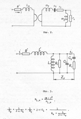

Well - yes, we can. I am attaching an image showing how to transfer mechanical impedances (both speaker and air on membrane) to the electrical circuit. The model is pretty good, but detailed explanation requires study of electro-acoustics.

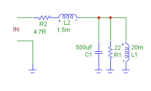

I hope there is no misunderstanding. The RLC parallel resonant circuit (R1, L1, C1 in the attached image) is a model for mechanical speaker behavior, not voice coil inductance. The voice coil inductance is represented by L2. See the difference in L1, L2 inductance values. L2 (voice coil) causes only impedance increase on higher frequencies. L1 is reponsible for speaker low frequency resonance.
The so-called "back EMF" is nothing else than energy exchange.

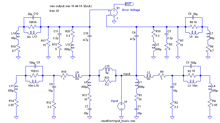

Test Results
I've performed the difference test using WAV file input and output. I'm still unable to get my Squeezebox 2 to play the LTSpice WAV output files. The problem appears to be two zero byte counts in the WAV header which I'll write some code to fix up later. However, foobar plays these files just fine and this allows me to hook up the Sennheiser 580 headphones directly to the analog out of my E-MU 1212m sound card to play them. So that's what I did. I'm able to play music loud enough with this setup to be uncomfortable.
The circuit I used is in the attached graphic. It's meant to evaluate the effects of the output inductor. The same simulated speaker is driven from an ideal zero impedance source and a source with a parallel 6 uH, 8.2 Ohm RL network in series with it. The difference voltage across the two tweeters is captured to a WAV file. First, I captured the input to a WAV file and verified that I got a good quality replica of the original sound. The original was a mono-converted version of the song "Almost Gothic" from the Steely Dan "Two Against Nature" album. Then I switched over to capturing the tweeter error voltage to the WAV file. I only simulated the first 20 seconds of the song, as the simulation is much slower than real-time.
The result? Well maybe I'm deaf, but all I could hear was total silence. This is changing my view of the output inductor.
