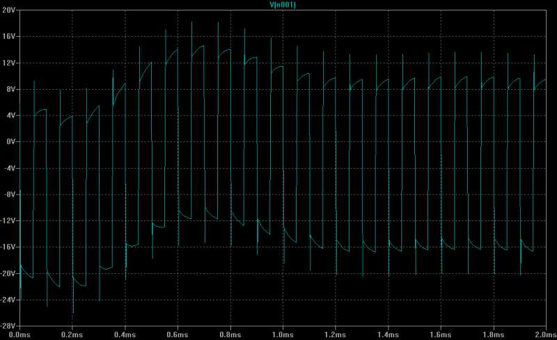

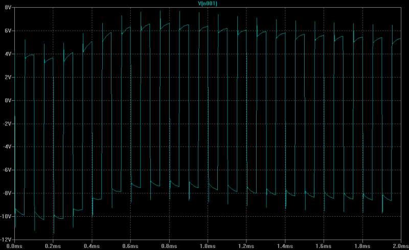

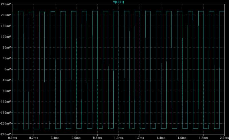

Let's damp it with your favorite 0.22 ohms resistor:
Amazing! Both the spikes and the ressonant effects are gone!
See, Graham, this is real life LOSS, and the speaker is connected to the source it was designed to.
Will this speaker sound different id connected to a 15 ohms source or to a 0.22 ohms sourece?
Absolutelly, it's in the traces.
The right one is the 0.22, it's the closest reproduction of the input signal.
It just may be you like more the 15 ohms one, it's called 'euphonics', the embelishment of the sound by artificial means.

Jorge said:To it, let's apply a current 10 kHz square wave, band limited to 100kHz.
Hi Jorge ! Feeding a current squarewave into a coil is ... EVIL !
With a naked coil you'll get infinite voltage.
Where is the bandwidthlimit ?
Don't forget, an amp has voltageoutput and damping means the
ability to hold this voltage...
You really should do these sims with voltage-squarewaves !
Mike

I know the use of a current source is not recommended here (and the 3.5u rise time is not the best way to band limit), but it did good enough to show my viewpoint...
One can interchange voltage and current sources freely to study circuits behaviour.
Norton's theorem is used for the conversion.
See here:
http://hyperphysics.phy-astr.gsu.edu/hbase/electric/norton.html#c1
In my case, the resistors were in parallel with the current source (right figure in the link above)..
So, for the 15 ohms case it would be equivalent to a 15V voltage source in series with a 15 ohms resistor (short circuit current is 1A, open circuit voltage is 15V, same as it was the current source).
MikeB, Scott

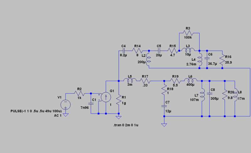

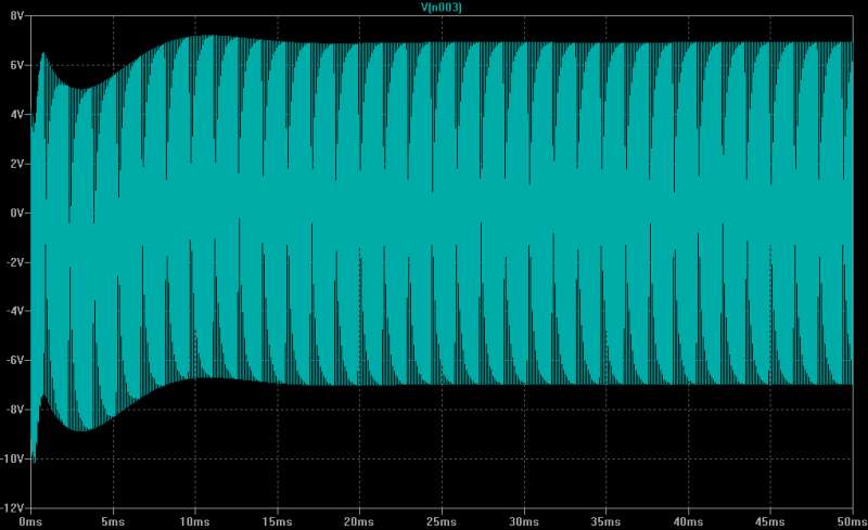

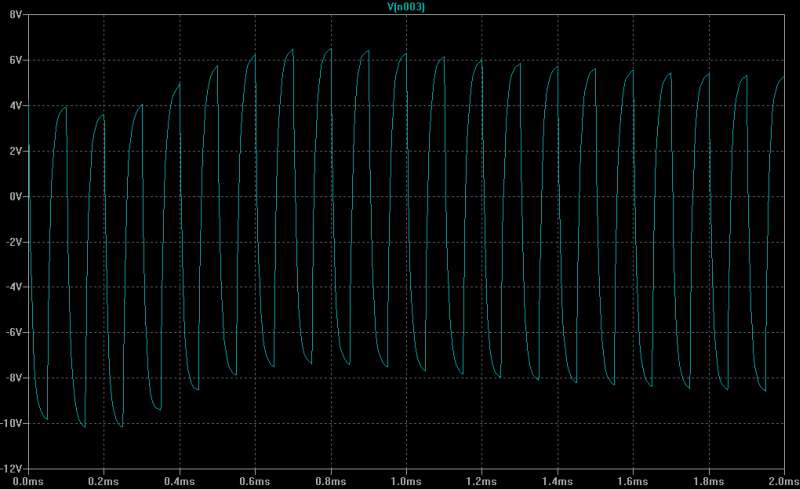

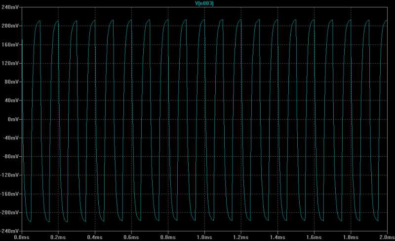

I've made the circuit more precise re band limiting, using a voltage generator and a transconductance to drive the speaker.
The band limit is done trough a single pole (set at 20kHz).
Due to some instability of LTSpice, I've placed a 100k resitor (R3) in parallel with the tweeter voice coil (a much higher value than the real equivalent loos resistence a more detailed model would have).
R1 is the source resistence, 15 ohms, 0.22 ohms or 1 G for infinite.
Results with a more precise band limit are the same, I've used 100kHz before since lots of amps do respond to this range.
Here's the circuit:
Here's the circuit:

janneman said:These error voltages we see in my opinion are the result of linear distortion, i.e. deviations in the freq response. Is that right? In other words, there are no non-linear distortions like harmonic or intermodulation products.
Jan
Yes and no.
These simulations are based in linear models, so they do not take in account the non linear distortions that have been quite well covered in the Hawksford paper.
The only way to reduce them significantly is driving the speaker from a current source, but then linear distortions shows up (as in my previous postings with the 15 ohms or more source impedance).
So one has to decide - go the classical way (low output Z), or go to MFB.
Maybe it is possible to design a LF/MF (the area of most improvement due to current feed) speaker that benefits from a high Z amp (or a normal amp with a fairly high value resistor in series) and still has a flat response.
I really don't know if the results would be significant compared to real current feed.
