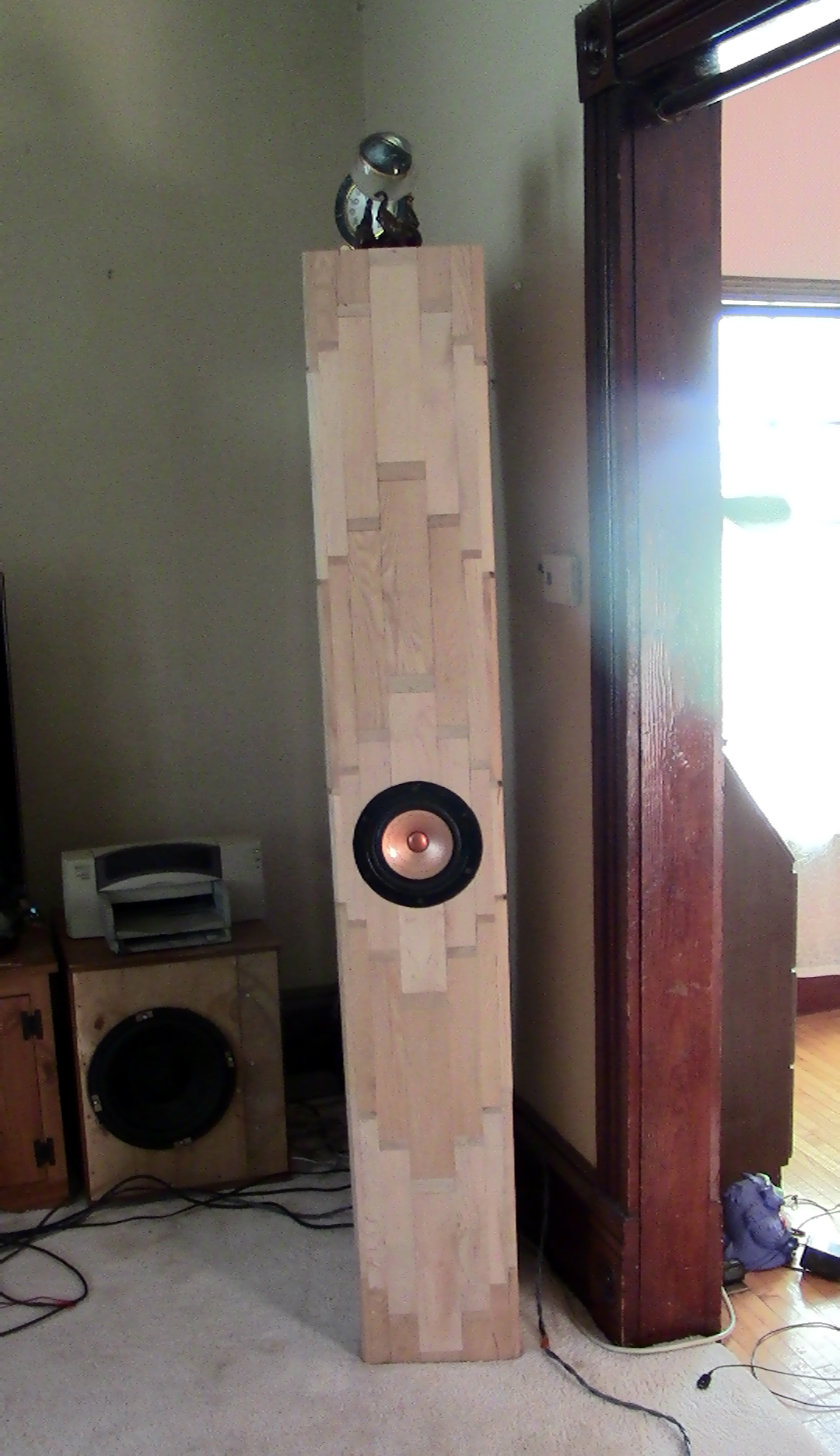

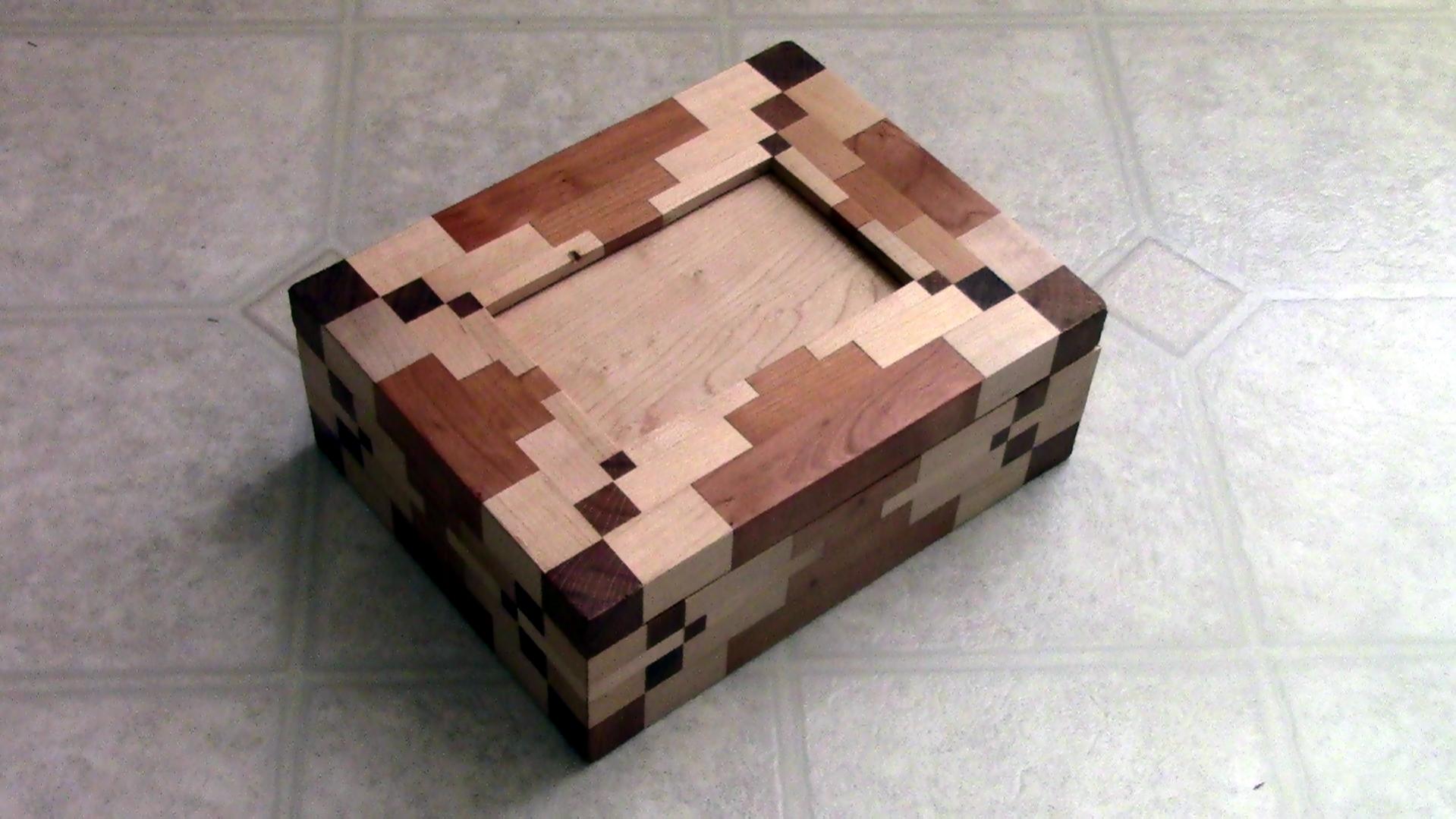

Below is one of my ideas of making a large system look pretty: wood mosaics 😀
The Avebury mosaics are still in progress, but they will look a lot like the box in the second photo, once sanded and finished. 😱
I plan on doing something similar with my "All Aspiring Array Project" 😀

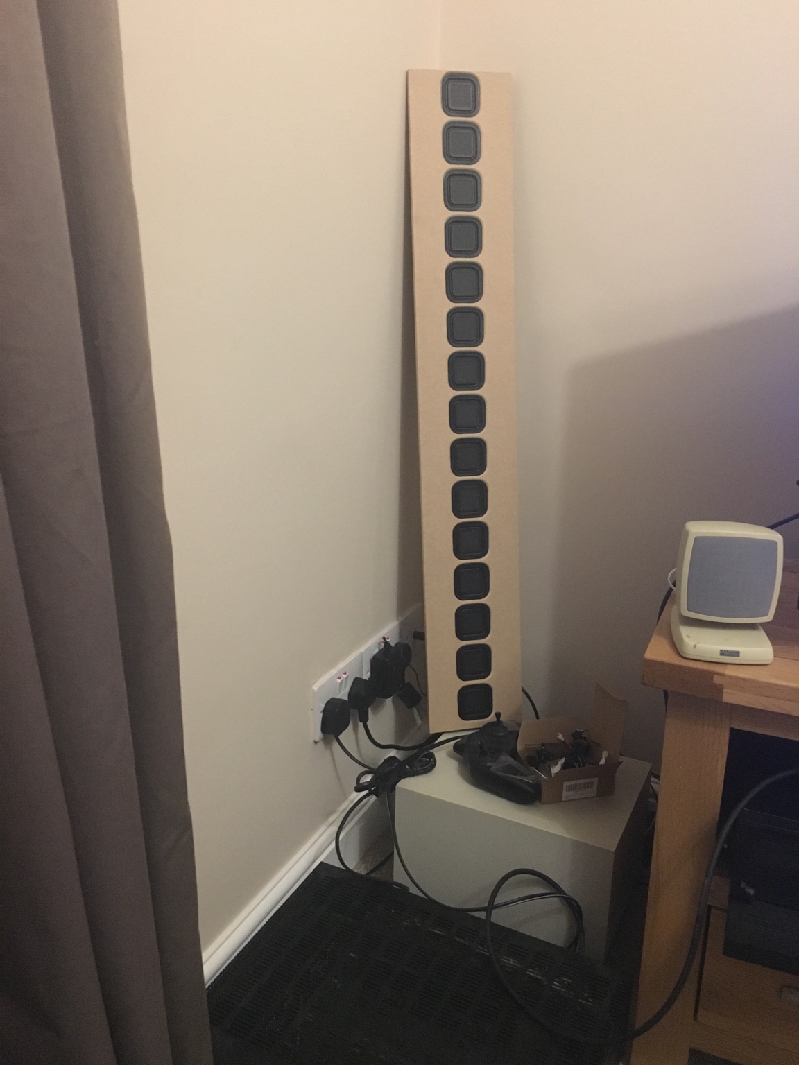

Before we miss out on Jameskatie's build!
Okay, sing it out, Jameskatie
impressive, how?
What are You hearing compared to other systems you have?
Also, what do You think of the dispersion characteristics of the BMR, esp in the highs? Is the dispersion pretty uniform. As You are corner mounting these, I would think the power response is pretty consistent for all frequencies. Do You observe the same setbacks as ra7 mentioned with constant directivity systems? (as in being either too bright or to dull)
Do You have a thread documenting your build?

View attachment 52927030 2" tectonic BMR here I'm building results so far very impressive

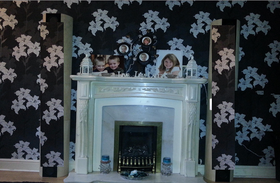

Blend it into the bakcground
I am going to get flamed for this but I feel the line arrays would be nice with a cloth grille, the same color and pattern as the background wallpaper.
Why not enclose the entire thing in wall paper so it disappears into the bakcground like some Klingon starship?
Just a thought. What is its acceptance factor, though?

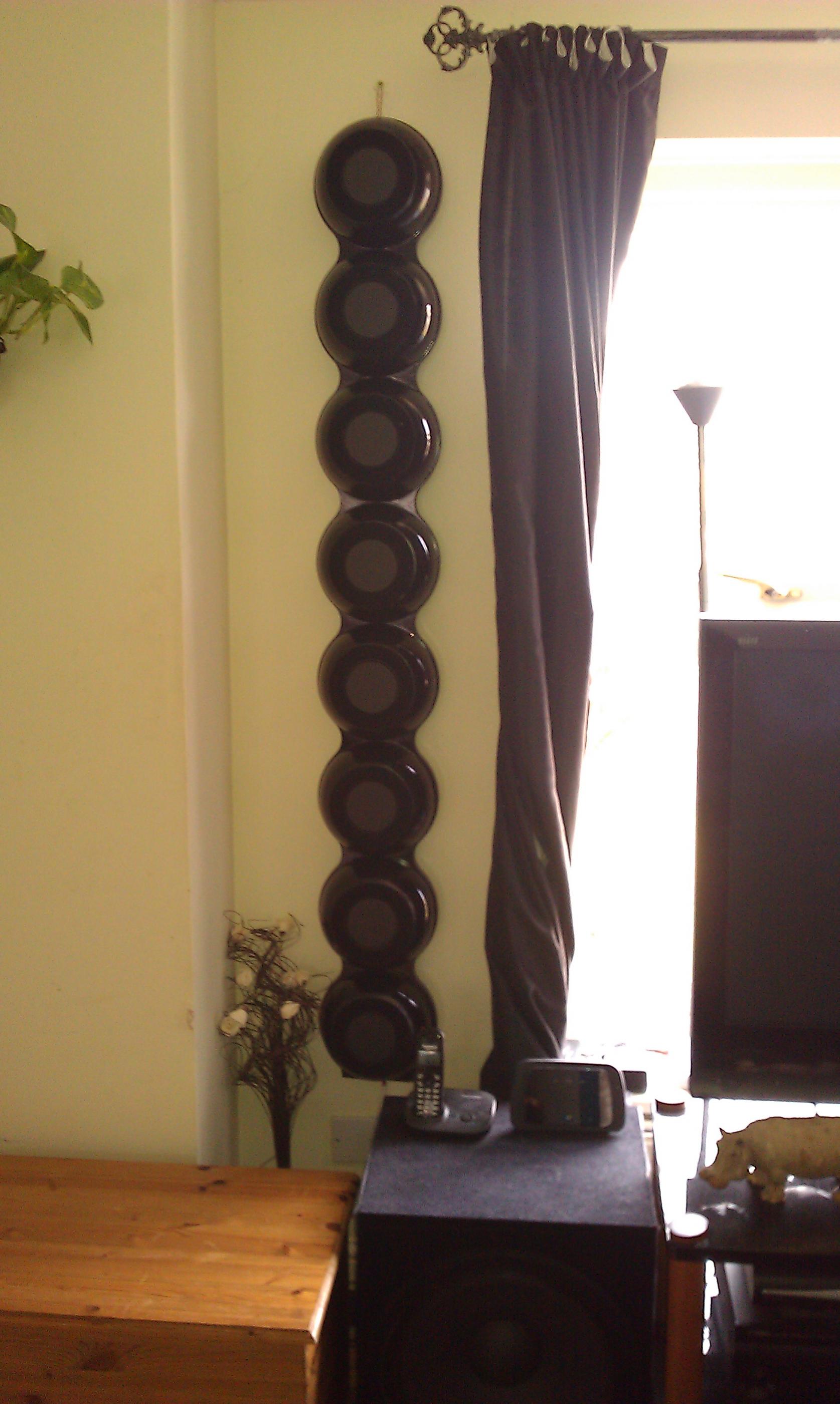

Derek's ("Overkill Audio" on here) on wall line arrays did pretty good in that test! If you could get something like that past the commission it wouldn't be a bad idea. His later designs aren't all floor to ceiling but have a nice modern look and are pretty unobtrusive in a more modern interior.
This was a later design:
Still floor to ceiling but I'm looking for his commercial site... Found it:
More here: CustomInstallAudio

I think so too, just like another design...

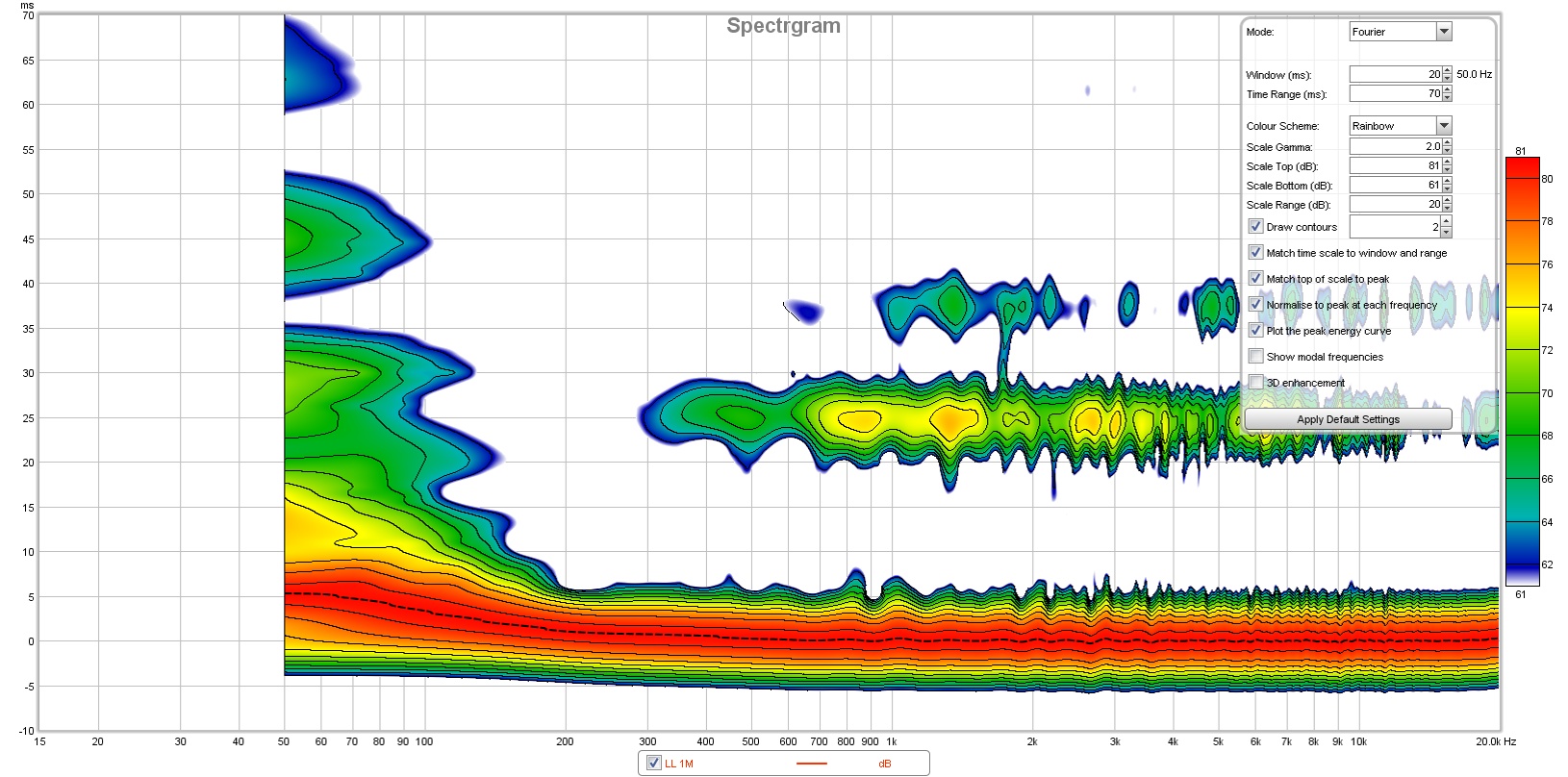

The start of my ambient project, what can I say about it..
Another way to look at it would be the spectrogram:
Mains playing only
vs
Mains and ambient channels
You can see the response of the ambient channels is messy, as planned, not a specular reflection but actually a series of reflections. Hopefully diffused enough to help de-correlate them from the main signal.
In my testing the ambient signal gets an additional low pass, somewhere above 3500 Hz. (currently at 7 kHz) But I figured it would be easier to change a couple of digital filter setting within JRiver than making new FR targets for DRC each time I want to try another slope or frequency.
I'm gonna hit Submit Reply now before I accidently lose this post 😉.
Hey there...
Someone over at AVS pointed me over here as I was interested in my own ambient project and said you had one going. I guess I found it 🙂
Anyway, I was looking at my spectrogram and yours. You dont show the control panel, so I dont know what settings you used to create the graphs shown, but here is mine, more or less like yours (to -20db depth).
As you can see, my Haas Kickers alone dont give me anything beyond 37ms or so. I am not sure if at this point, I really need to, but I am open to exploring the possibility.
Basically, I am happy with my reflection suppression <20ms. But it came with the cost of reduced leftover energy for later arrival. What I have been thinking about is how to mitigate this. I could add an extra pair of speakers in the 110-120 degrees area (where 0 degrees = forward), and delay them in time. But I want them to have a gradual decay, so I would need some sort of reverb also.
I was looking at the Illusonic Iap processors until I saw they were $20K 😱 Thats not going to happen. So I thought you may have some ideas. Keep in mind, I am CD player-DAC limited for my source.

Hi Jim, funny how that works, I looked at your results to help me shape mine 🙂.
I use speakers aimed away from me to the outside and let them scatter to what they reflect off of. That makes them more diffuse and even have some tail. Have you seen Linkwitz page on his ambient speakers? He's using a Dolby Pro Logic II to extract the ambient information. I just hustle the L-R and R-L and insert a bit of L+R, all band limited (not in that picture) delayed and attenuated driven from a separate amp. I'll think about it what it would take in your case. I did also think about adding reverb, but figured this will do for now.
Linkwitz link: http://www.linkwitzlab.com/surround_system.htm
I do use convolution to get the FR right in basic shape. But the impulses are left scattered from the reflections which is what I was after. I can test and listen to reflections only as they are fake. They have to be somewhat convincing, right? Yours seemed remarkably clean, not that diffuse at all. Even in the TDA plot.
