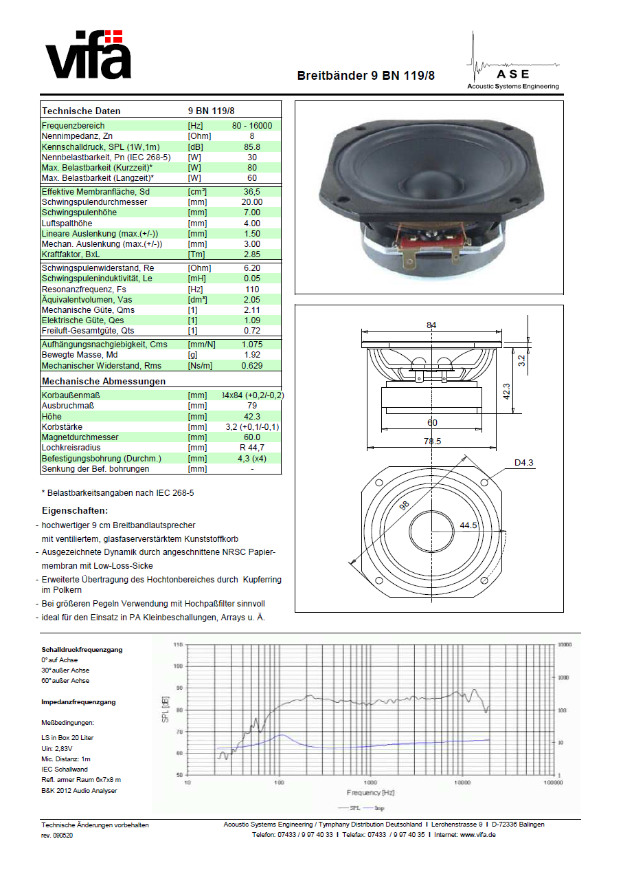

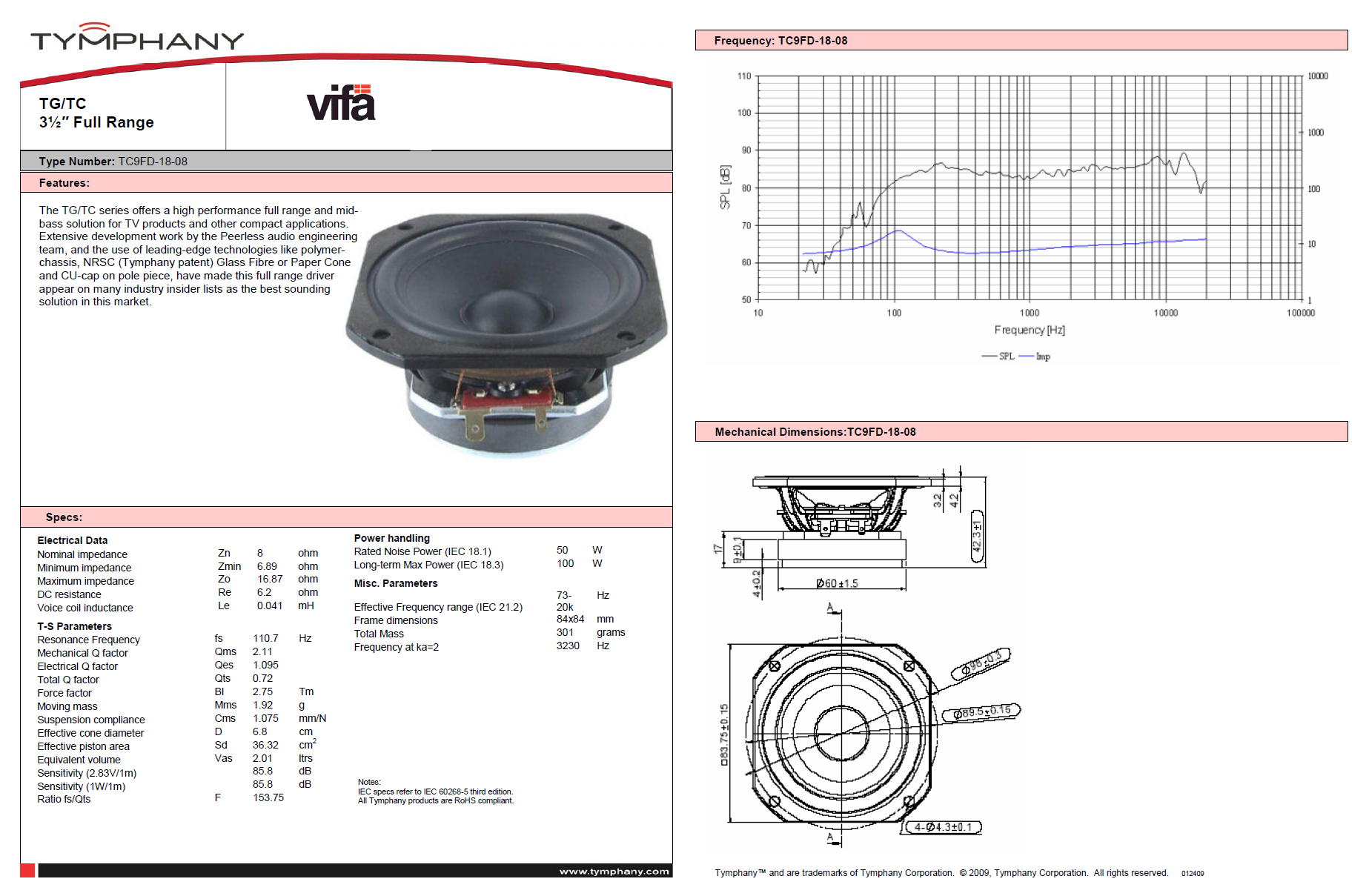

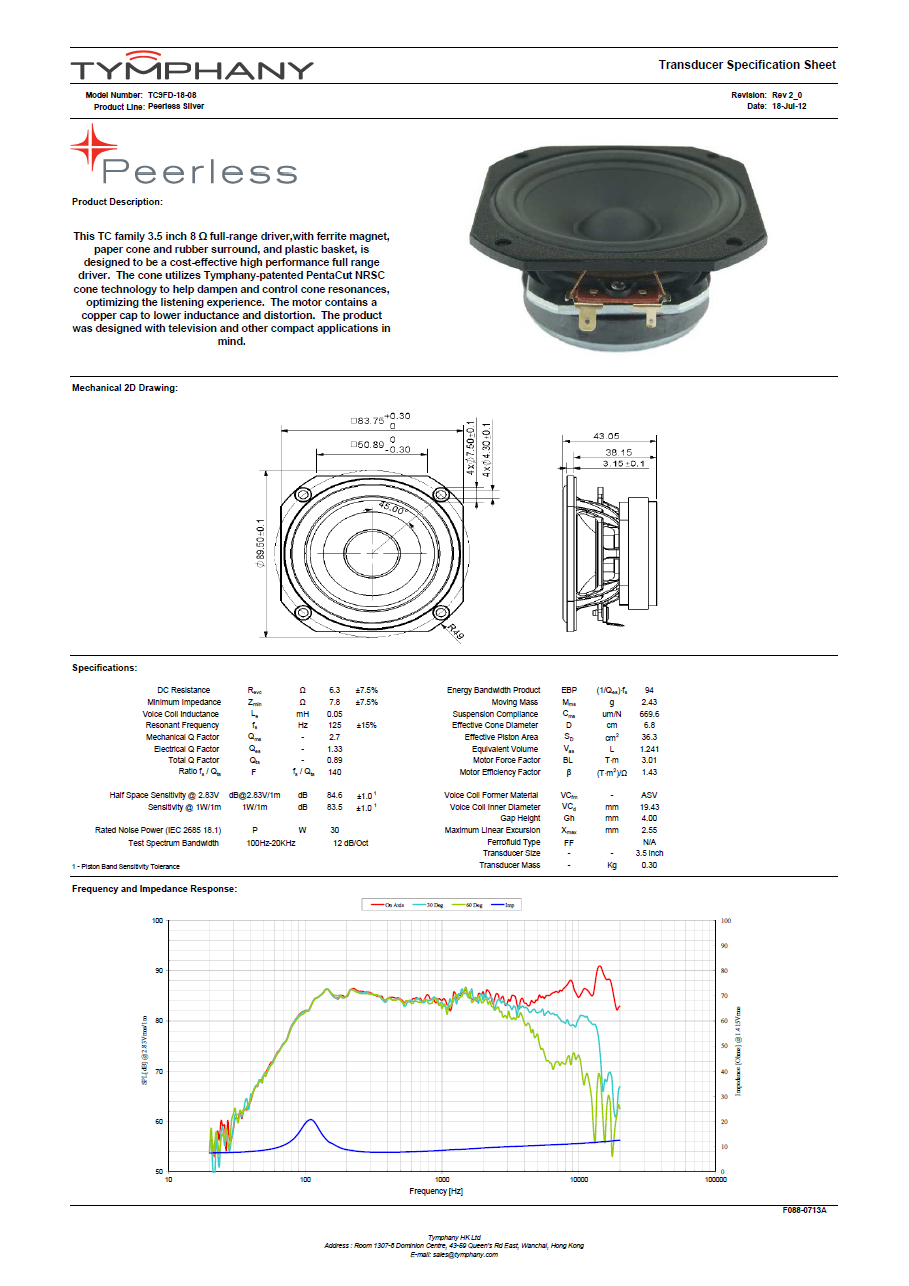

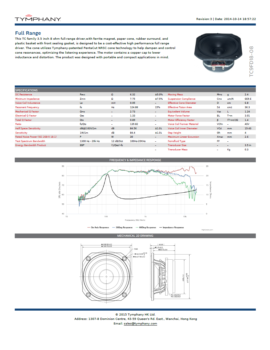

sannax,
Think they are worth to mix, myself have ordered first two pieces then two more and last time it was four pieces, time of orders was very different and from three different shops, but when later measured with DATS unit they where all very close except one that had a little lower Fs.
Below is four versions of datasheet i had on my HDD and while the last one is from year 2014 its mostly same data as the year 2015 at PE site. Maybe the biggest difference is Tymphany personal is updating documents for driver to reflect brand now is Tymphany and not Peerless or Vifa and also in they could have got new measurement suite and environment where they test drivers and want to publish those better precise numbers.
Nice collection, I saved those too, I had the rev 1 pdf on file, as my drivers were bought back in 2011. Attached it for those that would like to see it.
Saved it in oktober 2011, when I ordered my drivers. 😱
