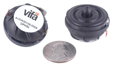

ArtsyAllen,
Your comment on the width of most dome tweeters is very true generally but you could look to some of the very small dome tweeters intended for automotive use that use Neodymium magnets in a cup core design, Those can be almost as small in diameter as the dome itself. Now who is making a great sounding unit I can't tell you but they are much smaller than a typical tweeter using a flat ceramic magnet with a front plate and rear T-pole type construction.
Vifa tweeters like these come to mind:
View attachment 52927030 2" tectonic BMR here I'm building results so far very impressive

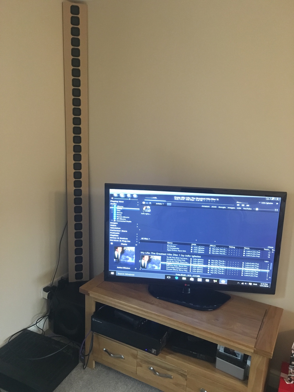

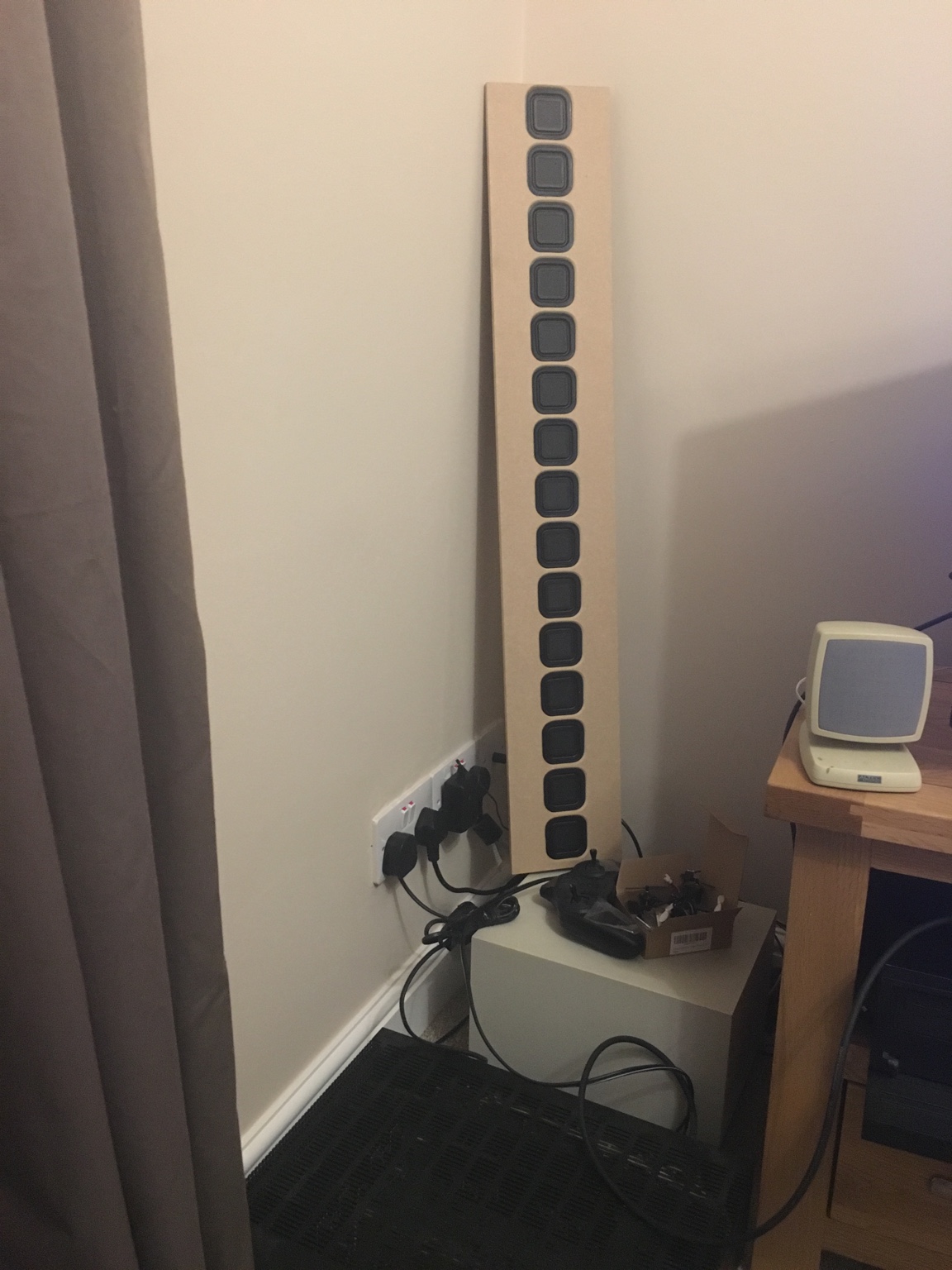

Wesayso, been lurking in your thread for a few weeks while I've been planning a build to get back into speaker building, I'm not going to say anything that you haven't already heard, but epic build and even more epic effort! I came across your thread initially when I was researching laminated building techniques.
I am taking on a much simpler project using longitudinal layers, nothing too special but it's been fun to figure it out with limited "hand" tools and experiment with the technique. I'm documenting my build and system in this thread if you get a chance to check it out http://www.diyaudio.com/forums/mult...ayton-reference-adcom-system.html#post4609593
Anyways, thanks again for inspiration and not giving up so easily, great to meet you 🙂
