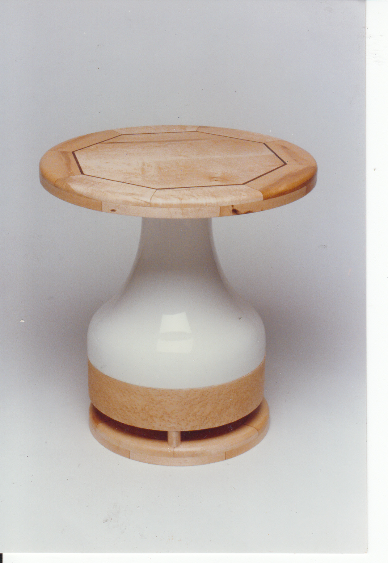

WAF is one of those reasons that people need to be a bit more creative with how they design their speakers. I think that Wesayso's speakers look nice and don't overpower the room. they could have a grill cloth if a wife didn't like the look. Here is a picture of a subwoofer I created over 20 years ago and nobody would realize they were even subs when they were just sitting there. Think outside the box. pun intended.

Nicest sub I have seen. Is it wireless? That would take care of ther unsightly monster cables.

they weren't wireless but hiding wires isn't always that hard to accomplish. Its easy enough to hide wire under a carpet if there is one. Today I could do something wireless, don't forget this was over 20 years ago and wireless speakers were more of a concept than a reality. Don't forget even with wireless you still need a power cord.
Thanks for the complement on the styling. The top was made of solid Birdseye Maple and the bottom section around the base was a veneer, the base itself was again solid Maple. I used some leftover Coco Bolo for the insert on the top.

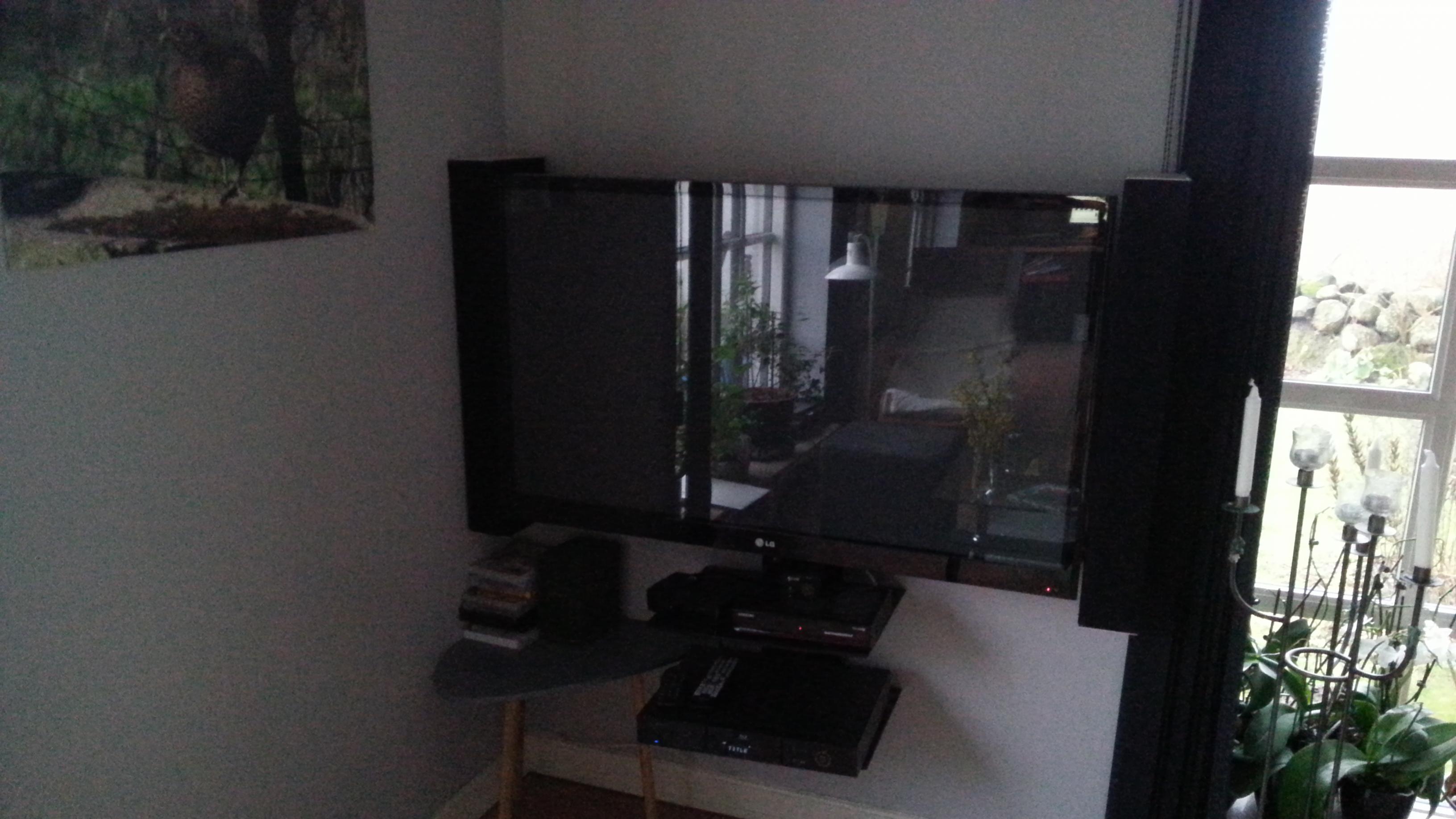

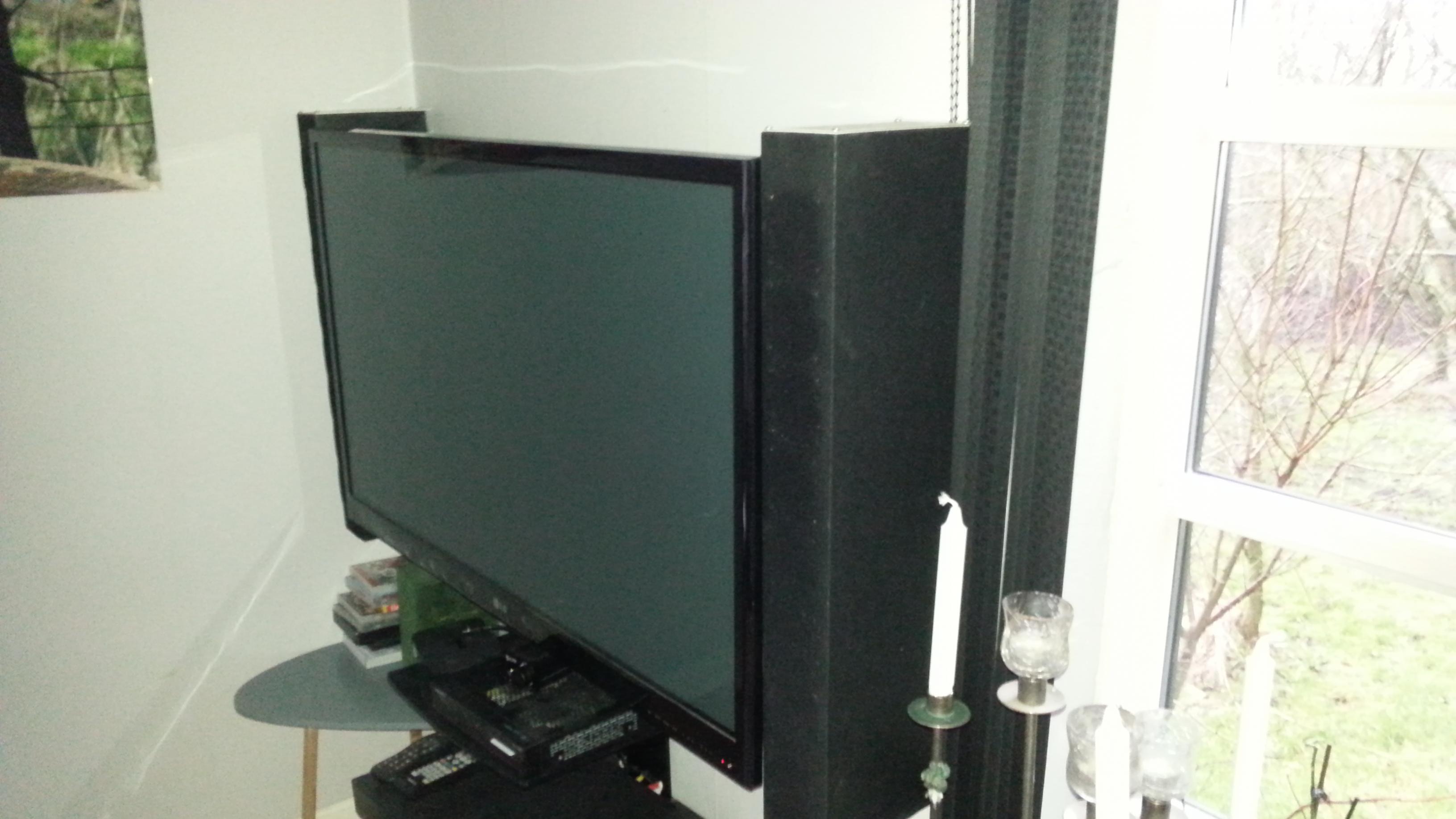

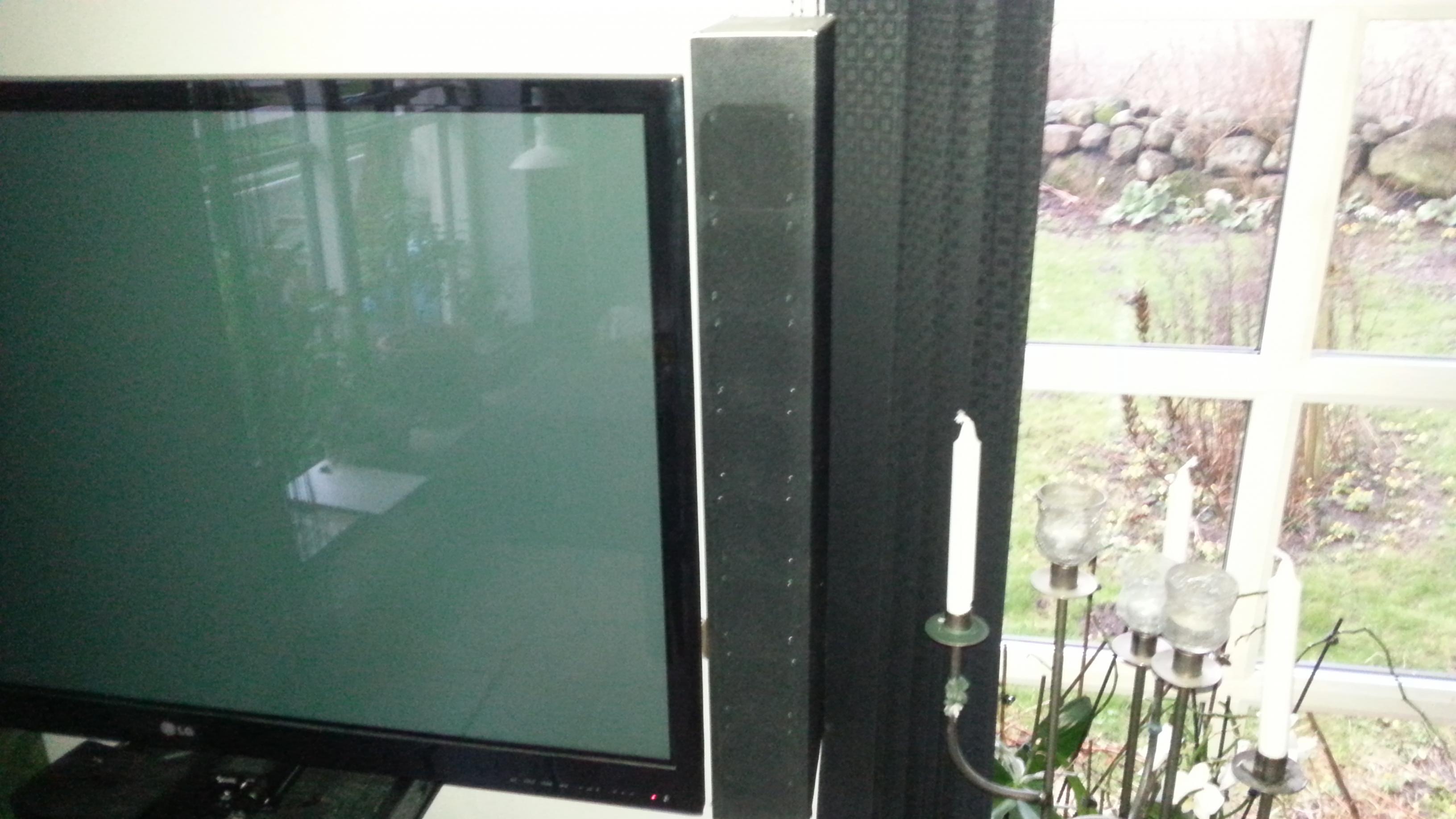

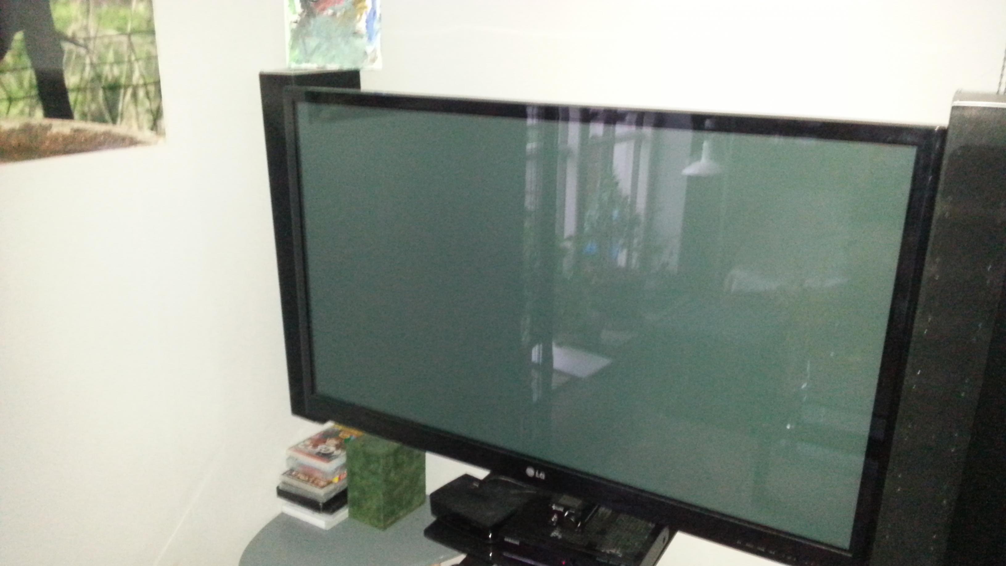

How about something like this. 8 Vfia TC9 in a Alu enclosure🙂
Like 1/3 line array.
You cannot see the speakers through the grill cloth it is only when I use blitz they are visible. Last picture is without blitz.

Koldby,
Though those could be legitimately called line arrays you would not have the advantages that Wesayso's line arrays would have with the floor and ceiling bounce elimination. So we are back to very similar room response as you would have with most any small enclosure. The extreme length of Wesayso's line arrays are a major contributor to the overall success of his design.
Great stuff, and discrete and elegant. But doesn't aluminium resonate?
Also, 1/3 line array compared to the full floor-to ceiling ones, how does it do?

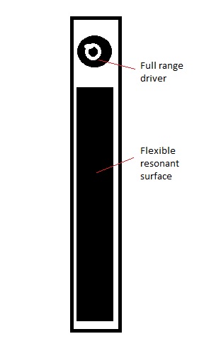

Here is one off the wall (pun intended) idea I had - a single driver coupled to a planar passive radiator made out of rubber.
Will it work? Anyone tried this? Should save a packet on speakers drivers. Extend it to the ceiling if you want.

Your plans with a single driver and a large passive radiator are cute, but would take an enormous effort to get right, if it can be done at all. I chose sealed for a reason. And another thing: a big part what makes these line arrays special is the number of drivers. It brings down the excursion of each driver. That certainly has advantages.

Koldby,
Oh yes, but I know that. My main speakers in the stereo system are linesourses with 25 TC 9 in each 🙂
These are just leftovers of that project and they perform well as TV speakers.
The main reason for making them, was they looked good and they actually perform surprisingly well. Alu cabs. must be damped by putting asphalt plates or the like on the inside walls, but after that they are very rigid.

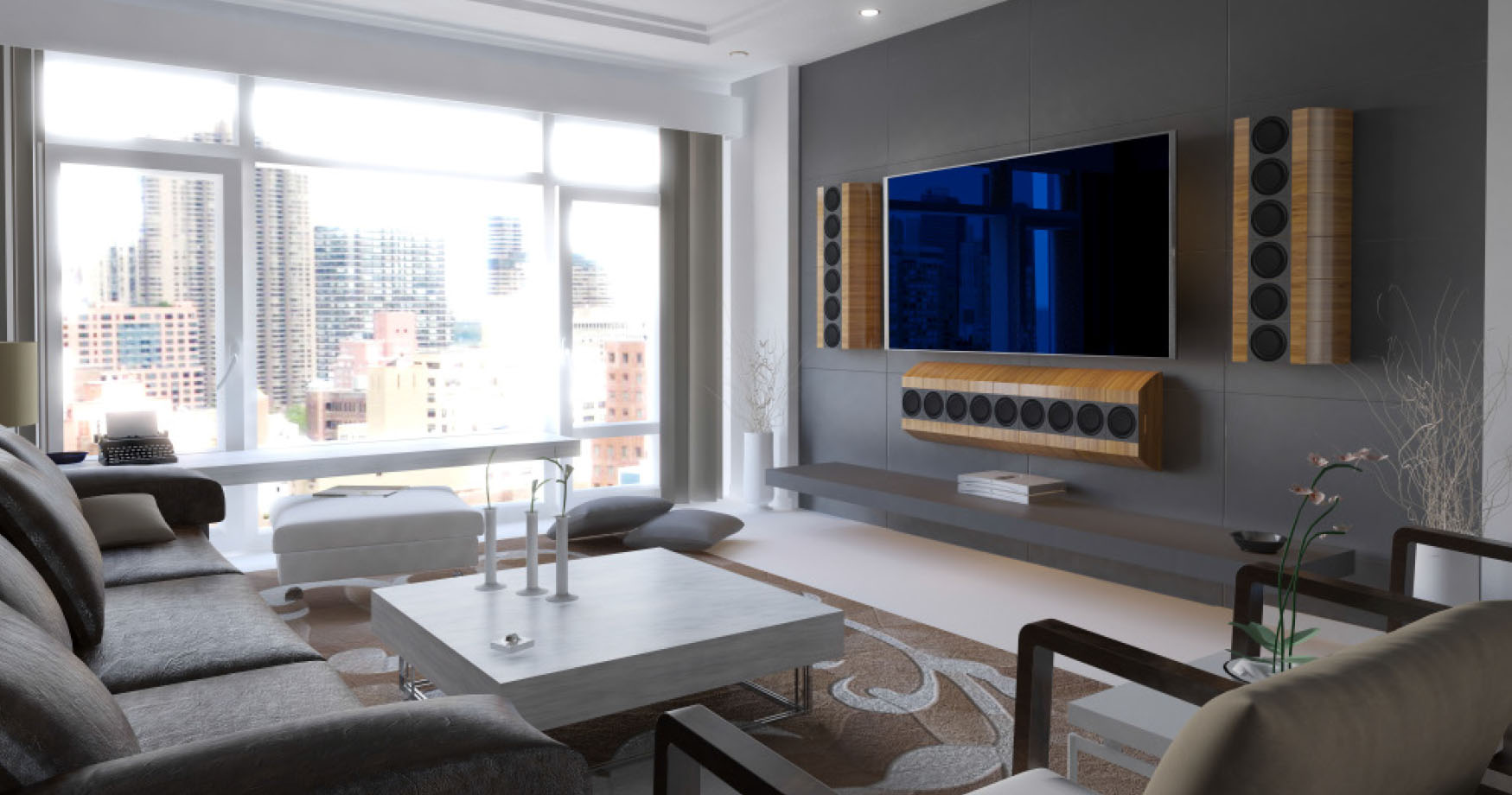

Derek's ("Overkill Audio" on here) on wall line arrays did pretty good in that test! If you could get something like that past the commission it wouldn't be a bad idea. His later designs aren't all floor to ceiling but have a nice modern look and are pretty unobtrusive in a more modern interior.
This was a later design:
342124d1365771574-near-full-range-bmr-balanced-mode-radiator-la16-unfinished-12-03-13-002.jpg
Still floor to ceiling but I'm looking for his commercial site... Found it:
attachment.php
More here: CustomInstallAudio
