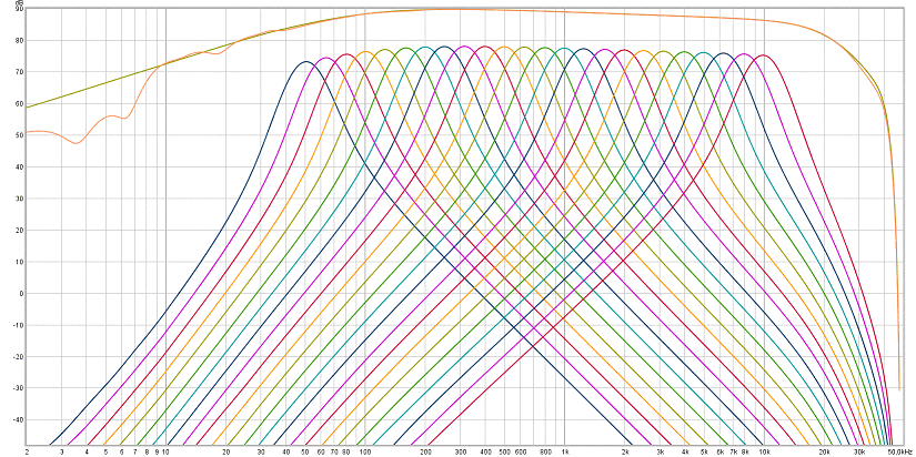

The making of: The Two Towers (a 25 driver Full Range line array)

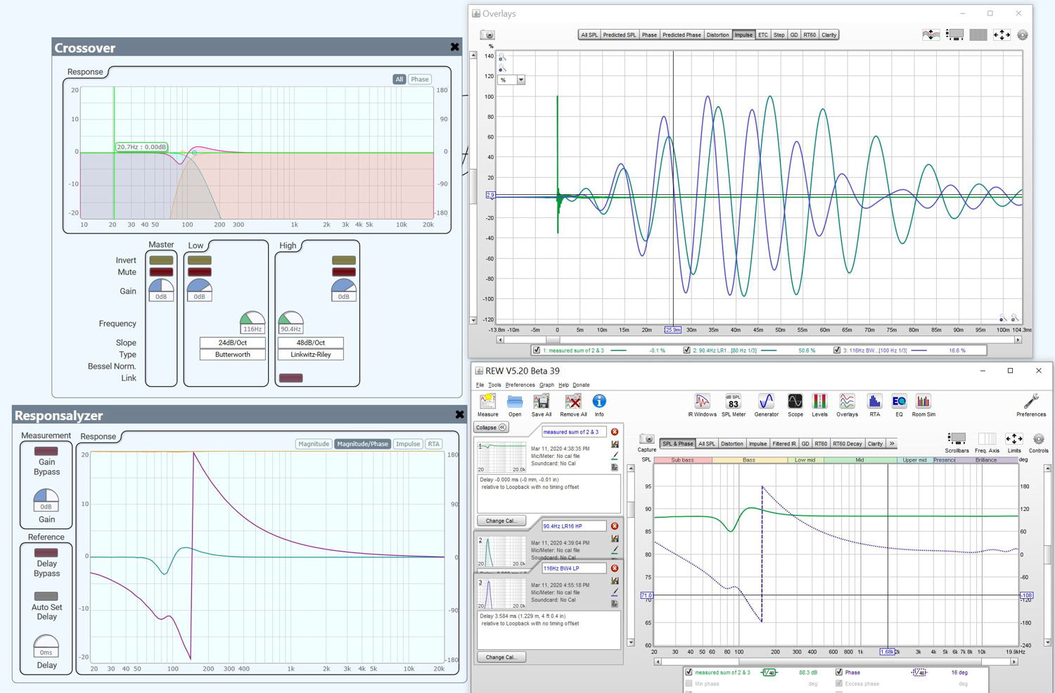

First, obvious problem is what filter freq do you chose when HP and LP are different freqs?
But what really gets me is look at the following:
A BW4 at 116Hz LP summed with a 90Hz LR16 HP....thought I'd whack it up a bit. A 1/3 oct impulse filter at 100Hz is used.
The thing is: the 1/3 oct impulse overlay alignment is correct !!!
Any shift would make would be incorrect.
See how REW SPL and phase agree with Responsalyzer....
I guess 1/3 oct wants complementary xovers.... if traces are to be aligned...which is ALLRIGHT by me 😀

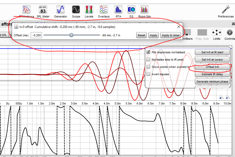

I still have beta 22 installed, that might explain the differences. However it would be a shame to lose the option of fine tuning impulse responses. I've used it often to try some theories (like these Filtered responses).
Doesn't pressing that offset button lead to a setting box of its own? Where we can shift an IR by entering numbers?
I would expect it to do that, as can be read in the old manual: Impulse Graph
Can't think of a single reason to edit out that useful option. 😱
The offset button offers a setting box, but it is a sliding action (not +/- arrows) and it is impossible to "dial in" small values. It is too coarse and has no fine control over the value, unfortunatelly.
EDIT: just realized it can be controlled with left/right arrow keys in fine steps. Was using mouse only before....so it seems to work, only looks differently.

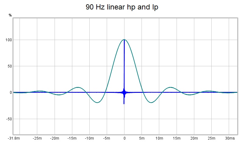

Hi BYRTT, pls see the reply i just posted to Fluid.
Thx for hanging in with me as I struggled to get to the bottom of the discrepancies i was seeing...
Here is a measurement that finally matches what I could get with theory & rephase imports.
90Hz 100dB/oct linear phase HP and LP...
impulses center aligned as you knew they would be...
attachment.php

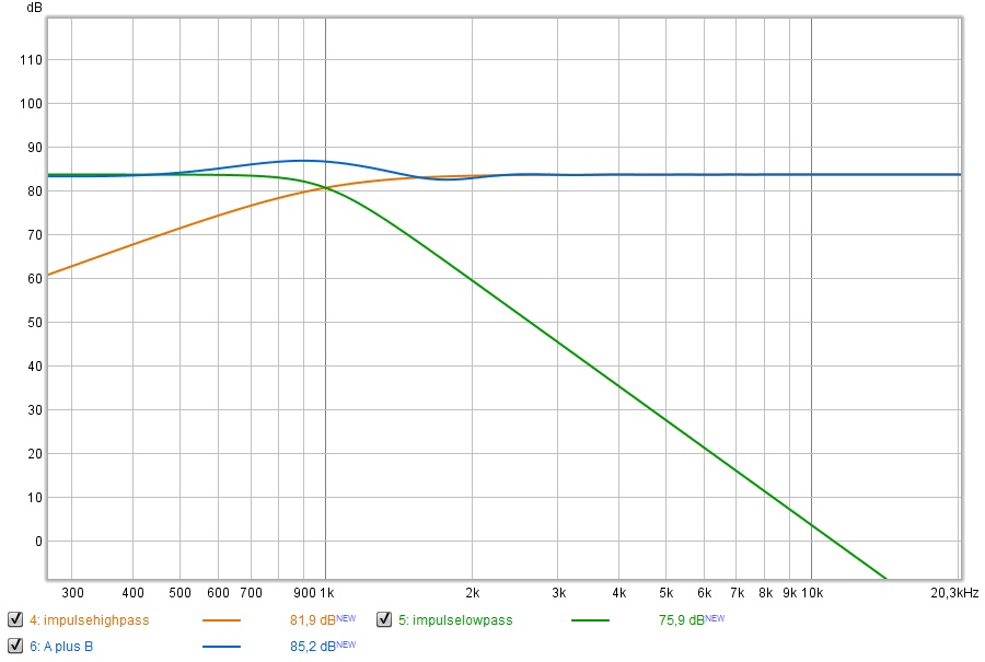

For instance it should be usable on a Harsch type crossover too:
824274d1583957709-towers-25-driver-range-line-array-harsch-jpg
824275d1583957931-towers-25-driver-range-line-array-harsch-filtered-jpg
Not a standard type of crossover, put pretty hard to get right conventionally.
It sums +3 dB around the crossover point but has excellent group delay without being a linear phase variant. It's all minimum phase.
More here: S. Harsch XO

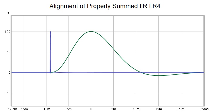

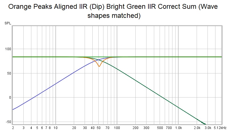

Aligning the peaks of IIR filters (without 1/3 oct filtering) will result in a dip as shown below.
attachment.php
Correct alignment (which is easy for an LR crossover using wesayso's waveshape method) looks like this
attachment.php
The issue in saying it is the start of the IR in practice is determining where that is. Without a time locked measurement trying to work it out from the impulses would be very hit and miss. Hard to see where the start is in the graph above.

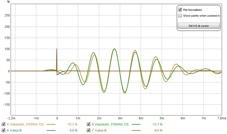

I still think that being able to add a user configurable number for an 1/3 octave filter (thus at a frequency of our own choice) should help within REW to use it as a crossover tool.
Not something I need specifically, but a nice to have feature.
Maybe I'll suggest it, John also incorporated the APL_TDA-'like' wavelets after bugging him about it for a while 😀.

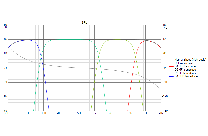

As some know, I often advocate making a xover by first flattening the in-band and out-of-band response of drivers thru their summation regions, and then applying complementary xovers.
In-band need no discussion, it's out-of-band that is interesting.
The flattening of the drivers out-of-band should be thought of as an intermediate step that MUST have a xover applied to it.
The summation of the out-of-band flattening with the complementary xover ends up being the total electrical xover.
And strongest odds are that will not look exactly like any named xover.
And one driver's electrical xover will not be symmetric with with the summing driver's counterpart.
The two total electrical xovers will not sum complementary, electrically.
But the acoustic driver summation will sum complementary 🙂
I think many people can see, if drivers had flat response, then adding complementary electrical xovers will give complementary acoustic response.
That method just makes them synthetically flat as an interim step, toward build a total xover.
The much more common method, is to say hey, drivers don't have flat response,
so i will experiment with different xovers on both drivers, by type, order, polarity, delays, etc...until a nice smooth mag and phase summation is measured acoustically.
And end up with non-symmetric xovers that will not sum complementary, electrically. (just like the prior method)
But the acoustic driver summation will sum complementary (just like the prior method) 🙂
Now here's what's really cool imo.....if we set our acoustic xover goal at some particular order, say for example 4nd order between drivers...
.....the two methods just discussed will end up making the exact same total electrical xover.
They have to...to satisfy an identity equation that says: electrical xover (including EQs) + driver response = acoustic response.
All the trial and error adjustments in the common method must equal the pre-flattening summed with complementary xover method....if the speaker has the desired acoustic summation in place.
What this means to me, is that the 1/3 technique is more likely to work well, because it is being used against measurements (acoustic) that are closer to complementary than not.

So there, another reason for non complementary crossovers, as the arrays do not have a crossover set, they have a low shelf with PEQ tweaks that determines their roll off.
Heck, when someone asks for crossover help, usually I'm glad if I succeed to point out that it is the acoustical shape that matters.
That you just can't just pick a crossover slope from a drop down list and everything will be perfect. 🙂
I hear you 🙂
Imho, until people realize that it is acoustic xovers that matter and not electrical, a tool like 1/3 octave impulse alignment is over their head and likely of little value to them.🙁
I also think even if people understand that acoustic xovers are what matter, until they realize that good speaker xover results will measure as acoustically complementary,
they can endlessly search for tunings with timings, various electrical xover settings, and not see or achieve the big-picture acoustic goal.
That was a part of my previous post, to help folks see what a properly built electrical xover will look like, in comparison to the fully complementary acoustic xover we desire measured from the speaker.
Like you say, you can't just pull a xover down from a list (unless you flatten out-of-band first 😉)
I think gathering support for a tool like 1/3 oct is also a task at showing how and when the tool will work to make good timings and alignments.
It's not a tool for electrical timings imo, because the inevitable electrical asymmetries needed will skew it up.
But I think it could be a good tool for both timing and acoustic alignment, because if 1/3 speaker overlays from high and low don't line up cleanly when timed together,
we know we haven't yet achieved a complementary acoustical xover that only needs timing to finish it up.
edit: just read your good followup post to TNT
+1 to all said
John showed me his Alignment Tool as a way of getting things right. The example plot on that page makes a good case for the 1/3 octave filter, as it isn't as neat or clear in phase alignment as one of your crossovers 🙂.
I think with even more ways like 3 or 4 drivers it would confuse a lot of people even more to get good results. In no way does this alleviate the need for good acoustic slopes. However it would offer the opportunity to break up each step into a more simple process. I'd prefer using the 1/3 octave filtered IR's to this phase alignment tool he showed.
In his picture:
If I were asked to help out there, I'd use a 50 Hz 1/3 octave filtered IR to align the drivers and I'd bet that it would align perfectly at the desired crossover frequency.
Yeah, lot's of ways to do this.
I've also been using the alignment tool as John showed for helping to square traces together..
That sort of phase alignment is what's taught in classes for Smaart and Systune, for live sound and professional install work.
It's what I'm familiar with, (and a big part of the reason I'm always advocating that mag and phase are all we really need....it never fails and gets intuitive after a while)
But that type phase alignment is much easier when there is continuous real time phase and mag to work with, as in Smaart's and Systune's (and i assume ARTA's) dual channel FFTs.
Mainly because it's easier to trust real time phase and mag traces that respond instantly as expected, to timing or xover changes.
I think with REW's static look, I might end up preferring the 1/3 oct technique once i feel i understand all its implications and nuances.
One thing i do know is that the 1/3 oct impulse look has been a hell of a good learning tool for me....thx again for showing me this several years back 🙂
