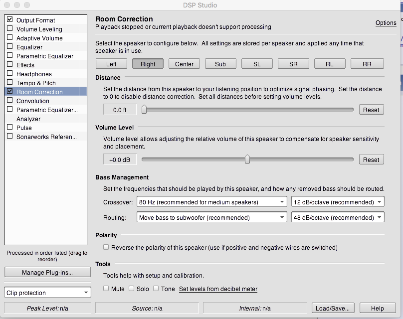

Do you mean the Room Correction settings within JRiver?
Where you put in actual distance to each speaker?
This would help to make an asymmetric speaker position sound more symmetric. However I haven't used it once.
As I've setup everything equal distance and where I couldn't I just put in delay where needed (like on ambience channels).
Well, moving the distance sliders would change the delay, but it would be guess work.
I was mentioning it mostly because of the different XO curves you can try quickly from there, plus adjust individual levels and phase between them.
To me it seems quite limited and meant for basic use. Us nutcases go well beyond that initial use. This is more inline with what a standard AVR would give you as far as options go.
With a measurement suite and the tools we use we go way further in trying to control the eventual outcome. At least I know I do 😀.

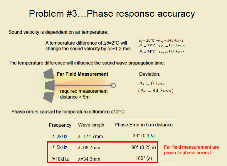

Hi BYRTT, yep...the prosound line array guys often bring this up.
Some loudspeaker management processors even have ambient temperature and humidity sensors, to help with beam steering. Check out EAW's Anya or Martin's MLA systems for some really cool tech.
Correct me if I'm wrong, but as I remember temp change as per the Kippel example causes a fixed delta t across frequency, or rather a constant change in excess delay.
So to get rid of any error, it seems all that is needed is to make a new measurement at the new temp....
And regardless of temp, I know in the case of my coax CD's sections, relative timing doesn't change with temp since the two sections radiate as a near point source.

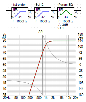

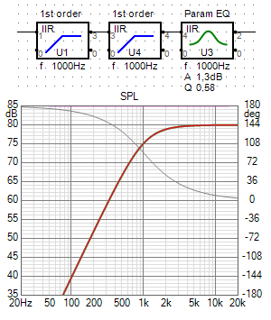

Copy below numbers on a piece of note should help set 2nd order Bessel or 3rd order Butterworth textbook slopes in Jriver, they my own hobby homebrew but should be 100% okay 🙂
Bessel 2nd order have frequency number relation of 1,27 relative to filter Bessel target setting, that is below example using 1000Hz number will be a 1,27x1000Hz=1270Hz BES2 target, and should BES2 target be 1000Hz then set below filters to 1000/1,27=787,4Hz:
823466d1583704208-towers-25-driver-range-line-array-wesayso_6-png
Butterworth 3rd order:
823467d1583704208-towers-25-driver-range-line-array-wesayso_5-png
Thx, It's really cool you can do that ! 🙂
I've played with such too, but only for education, not for implementation.
I always look for and turn to, the most straight forward method of implementation..ie a BW3 in a menu list lol

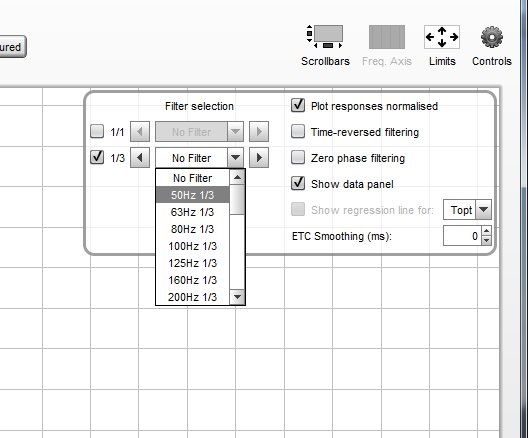

Agreed on the problem of trying to match impulses peaks and starts, and twiddling controls in separate locations, to align phase.
I guess that's why I keep using dual channel, as it overcomes that problem with real time comparison capability.
I think maybe some of the difficulty I've been having with measurements vs imported impulse responses, and this is a guess....
.....is that the imports are from very clean ideal generations (rePhase, etc) and REW nails timing on imports at either our choice of t=0 at peak, or at first sample. Precise timing on an import where peak is predetermined.
Whereas on measurements, REW must build an impulse response from available captured data, and make estimations on timings.
A little slippage perhaps, compared to cleaner imports...???

I had spent nearly three hours trying every combination/permutation of measurement settings, alignment settings I could think of in REW, looking for some simple set of them that could handle the easiest of all summations, a LR xover in nearly the middle of the linear frequency spectrum, with no success.
Your 1/3 octave bandwidth filtered impulse method at xover was the only method that worked.
I keep wanting to get truly proficient with REW as it has expanded capabilities over dual channel FFTs (such as THD, etc), and it's the language spoke here on the forums. But the sheer degree of effort to make simple timings turns maddening. 4-ways demand a simple process I've found, or things get too error prone or difficult to experiment with.
Anyway, my problem...not fair to burden others with it...
And yes, I've long been a fan of JRiver. Got 3 ID's when they first came out, to host my music and to compare different speaker/room setups.
So not so unhappy, just a dumb old dude who wants things to work easy and gets frustrated when they don't haha.
Thanks again 🙂
Your 1/3 octave bandwidth filtered impulse method, will be workable also at say 50 Hz do you think?
Think method in itself should be excelent and allign close to 100% precise those filtered IR 🙂 that said to utilize that precision REW should be set up use a loopback channel or acoustic timing as reference else a subwoofer IR would be so woolly a signature that from sweep to sweep or relative to the other full range IR there will be variances where its alligned on timeline.
