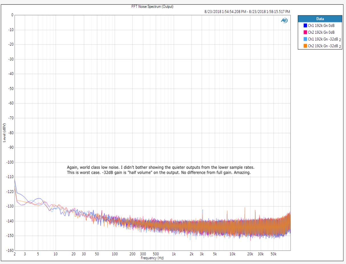

Anybody put credence in the claims that best achievable system S/N ratio is about 124dB.
And that a 24bit DAC has the capability of doing up to about 145dB SNR.....?
If all that is true, why would we ever need to jump to 32bit?
Here's a well made test from a 24 bit RME babyface pro DAC..
It shows half volume, -32dB....so i thought it's worth posting...

The Johnson/Thermal/self noise of resistors is a limiting factor in the analogue stage of audio devices. Most good ones set the signal to noise limit at around 125dB. This is one of those limits that is very hard to improve upon some designers can get a few more out. It is also possible to measure below the noise floor with precision oscillators.
That image seems misleading to me as it looks like it is measuring the noise, that is the part that does not change with attenuation but what does is the signal to noise ratio so instead of the difference being 0 to -140 it is -32 to -140.
I have attached the ESS Digital vs Analogue Presentation in zipped pdf, that is the clearest explanation with diagrams I have seen that describes what happens. You can see the noise as the baseline with the signal being the thing that changes.
32bit dacs have benefits when digital volume control is being used, without it in a normal stereo system where there is little to no processing 24bit is enough.
