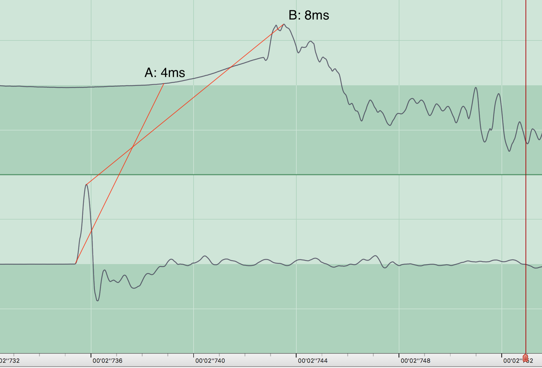

To time-align sub with main (main fixed, sub delay changeable)
Align as A or B - never got that really... on the peak or on the start?

Hard to determine, right? I remember that a certain representative from JBL used to have the answer to that over on the mobile audio forums. You had to pick a certain point on the upgoing slope of the sub peak.
However I've found at least two routes that worked better or more easy for me.
What I did in my own case is have one channel (either mains or sub) delayed vs the other. Next have them play the same frequency sweep and measure them together (both playing at once), say a sweep from 20 to 2000 Hz, as i know my sub can play that high.
That made it easy to see a sharper impulse peak from the sub. So I'd get 2 peaks, one smaller one (sub) and one clear peak and measured the distance in time between both peaks. This alignment worked for me because I do use a linear phase crossover, so I can align both waves (after first straightening the FR on them both) at the higher frequency and know that the'll align at the crossover frequency as well, because a linear crossover does not introduce delay.
I'm guessing you have a crossover in place here based on the shape of the peak of the sub. There is another option available.

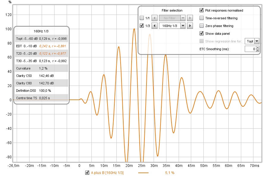

That picture of yours doesn't look like an REW measurement but maybe your package also has a way to filter these measurements. That is my second option.
If you filter the measured impulse close to the frequency you want to use as crossover point you'll see a wave shape. Both should look somewhat similar after filtering. Making it easier to relate both signals to each other instead of having one high frequency peak and one showing a low frequency lobe.
It should look somewhat like this when filtered:
This is a 1/3rd filter applied (to a Dirac pulse) at 160 Hz. Doing that kind of filtering for both measurements should make you able to see similar shapes and align them precisely. This should work for a normal crossover as well as a linear phase crossover. Real life measurements will look a bit more rough but the build up from the filtered frequency should still be clear enough to align the peaks and make sure they match. Count the wave shapes because you don't want to be off by a cycle 😉.

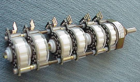

For these stepped attenuators I see the namer DACT, Goldpoint and TDK often mentioned together.
Interesting and affordable suggestion... here I was only looking at volume controls like this:
Simple, basic but expensive...
There is no way I am going back to a volume control that I have to get out of my seat to change 😉
Yes 🙂
These measurement was made playing a (1) 1khz sinc (half a sine) in both main and sub channels while a mic was placed 15 cm from the main and and another mic was placed at the sub at the same distance. This was then recorded in stereo with my DAW. This is what is in the picture.
I think I omitted a LP on the sub as well. But as I use a 40 Hz LP on my sub I'm starting to suspect that this is not so good as the LP, once introduced, will indeed introduce delay...
Tricky tricky...

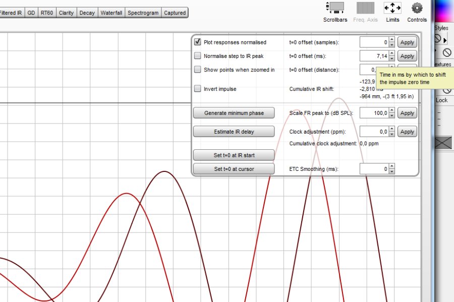

I'll try and explain my second way of aligning in pictures. It's quite easy once you get the hang of it.

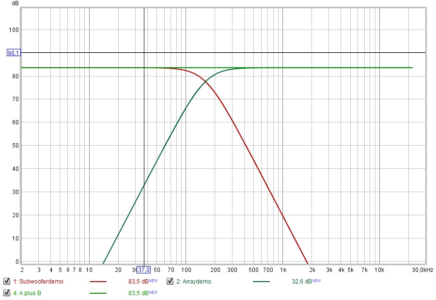

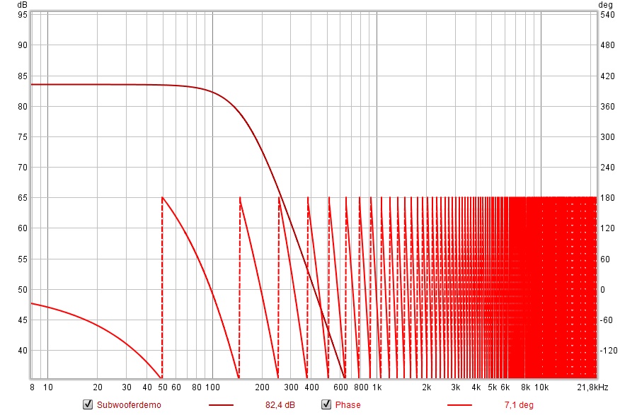

Let's say we have a sub with a LR24 at 160 Hz:
In this example I've added delay of 10 ms, this is an IIR crossover, Linkwitz Riley 24. But in a timed measurement you could have a different number of delay, it does not matter as long as it is a measured true timing. (so use the timing method of your choice)

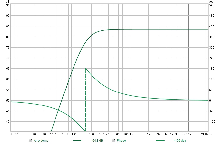

We want to align it with an array, also having a crossover at 160 Hz, to keep the example simple, it is a LR24 highpass.
If we sum these measurements, it will not sum ideally, it shouldn't because we have more delay on one vs the other, but we also added an IIR crossover with it's own delay. Anyway, lets look at what the sum looks like:
Horrible, right? Not what we want at all.

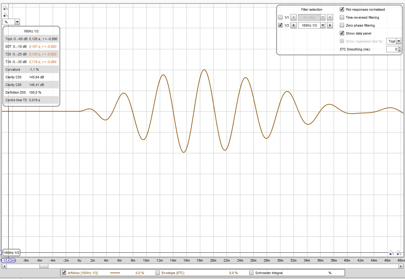

So what's next? We dive into the filters that are present in REW, and apply a 3rd octave filter at 160 Hz to the sub:
Setting the view to "%" shows us the waveshape, looks like what I've posted before, right?
Doing the same on the timed measurement of the Array we get this:
Looking at the sum with the same filter applied gives us no hint at all:

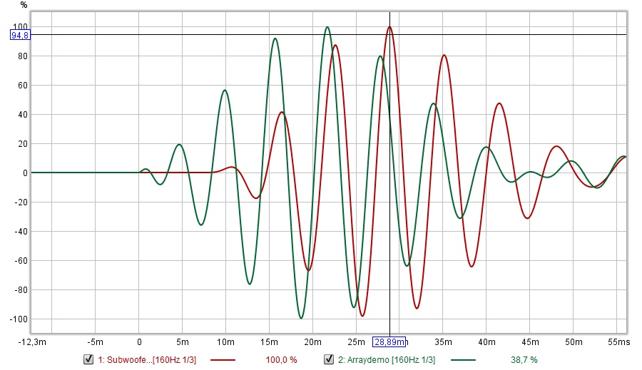

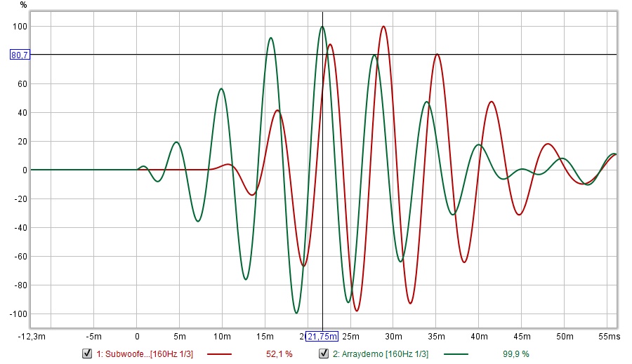

But if we look at the Overlay tab, and look at the filtered sub measurement and also make it show the filtered Array on the IR tab of the overlays:
See the shape of both the wave fronts? We need to align the largest peaks here. The crosshair is at the array peak here.

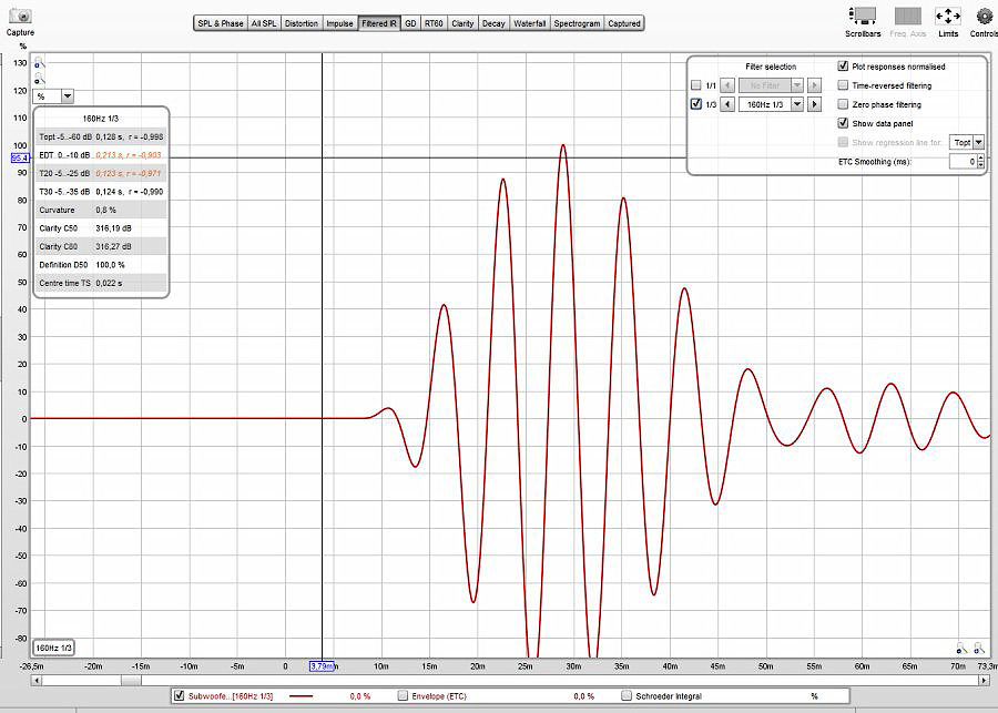

Now lets look up the largest peak of the sub's filtered wave shape:
Now all we need to do is determining the difference between both measured peaks. One is at 21.75 and the other is at 28.89 ms. So the difference here is 28.89 - 21.75 = 7.14 ms. Let's put that into our IR configuration tab. We advance the sub in this case, as I've put in 10 ms delay in the example as a start. But it really doesn't matter, we just need to align the peaks.
Here we advance the sub by the 7.14 ms difference we found in the overlays.
Another look at the Overlays, viewing the IR tab shows us the alignment:
Perfect alignment of the peaks! This should mean a sum would have to work too, but I'm on the max upload of pictures in this post 😀.

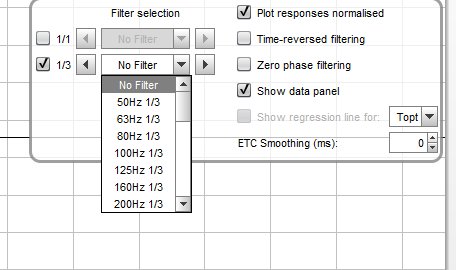

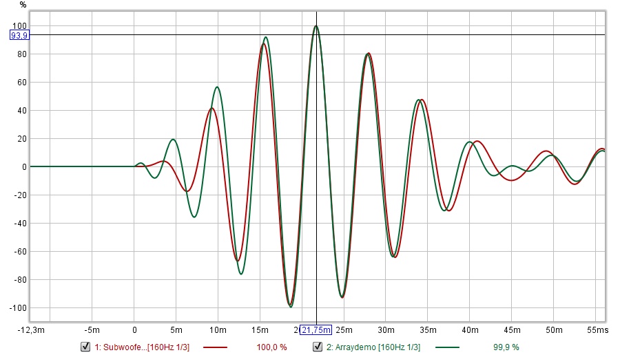

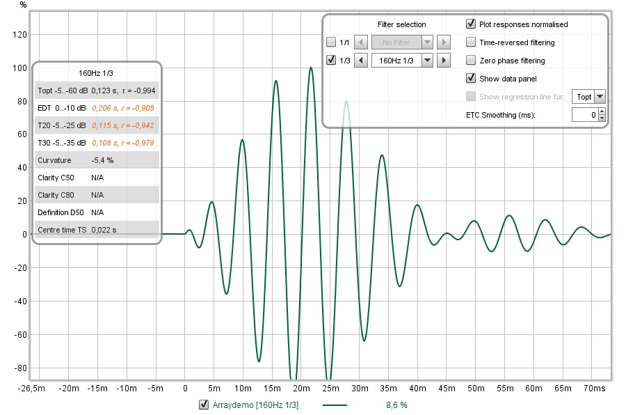

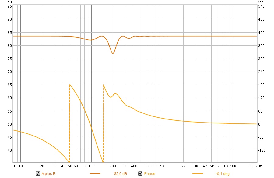

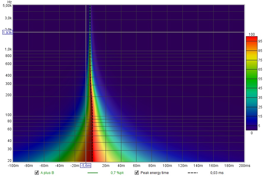

So lets look at the sum:
Nice and straight, right? Even when viewed in a Wavelet:
The slight curve we see is simply the phase rotation of a LR24 crossover.

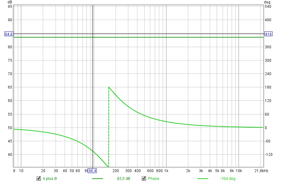

As confirmed when looking at the frequency and phase:
While this method might seem a little intimidating at first, it would ensure perfect alignment with basically all types of crossovers one could ever use, because we actually line up the actual waves with looking at it filtered right at the crossover. One caveat is that the Filtered IR frequencies limit us on where we can look at these wave shapes.
