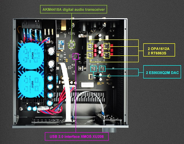

I'm not saying it doesn't make sense, but that Octo DAC would leave me with two questions.
- Feeding it an input signal through USB, I have had problems with PC noise with 2 generations PC's ago and using a different amplifier than I have now.
- I don't know what it sounds like, and I do know I can be happy with the M1 (for now) as that has been tested and tried...
Shure, that said they in second or third generation of UAC2 chip now so much have happen including jitter is almost nader nowadys seen over at ASR site, only point for Okto myself is unhappy is miniDSP pulled their 10 channel Xmos card probaly because of competion so newer units than the tested one at ASR site has not the German Thesycon driver package for Xmos UAC2 chip which had nice adjustable ASIO driver, nowadays it live on WASAPI via Win10 native UAC2 driver or ASIO4all which should be good enough in think it wrap via Kernel streaming but would prefer a dedicated ASIO driver.
...Unless I would get an Okto in the mail to try/see if I like it, it simply is too big of a gamble for me despite it's crazy good numbers. That DAC8 Stereo Okto is out of this world crazy 😀.

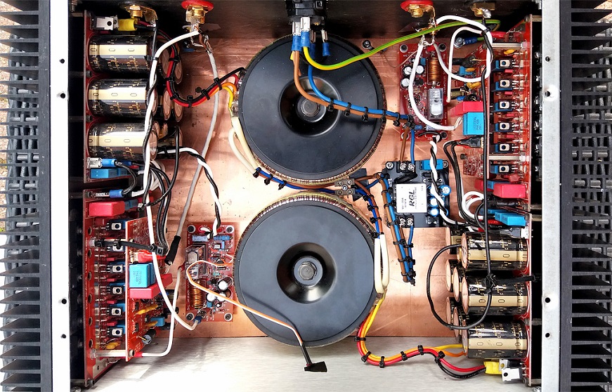

...I still see that Goldmund as a pretty crazy amp, powerful in its simplicity and philosophy...
Its not crazy but fantastic amp 🙂

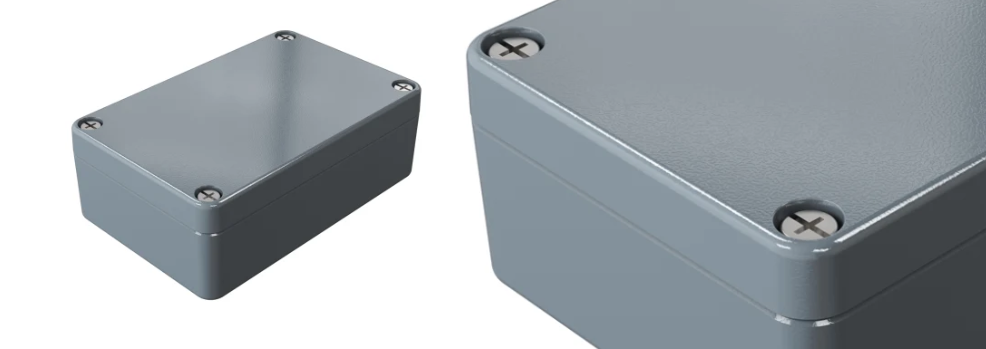

If (or when) I decide to go that route I will mount the Universal Buffer within its own case high above those toroids. Which is best, I do have some small cases that should fit the buffer. Is Aluminium good enough? The in and output would be from the sides of that case free and far removed from the toroids straight to the back.
Sounds good high above : ) with a case but think cheap even some scrap steel thick as possible or is it copper that is better if magnetic fields is the interference, maybe below alu box RS components number 506-918 could be mounted outside on back of amp in its only 34mm deep and 98x64mm for rest, buffer is 60x65mm so with a little luck PCB and 2x XLR or 2x TRS jack inputs can be squized into it, buffer output channels via a short wire and plugged into existing RCA plugs and PSU for buffer inside big existing big power amp box.
Thanks fluid,
I have to read up on what Mu metal is but admit seen some members here and there mention that word, myself is hot on the look of copper here and there used for audio gear as wesayso posted few pages back
