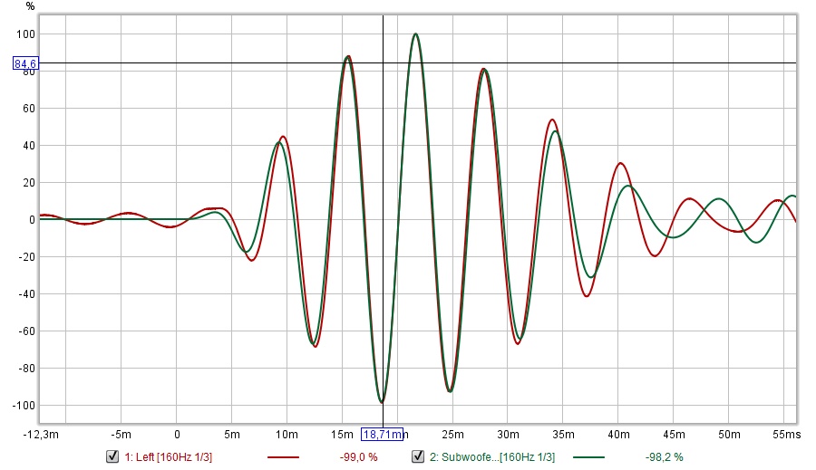

I hope it will get you some idea how to go about it.
To prove it can work with measured impulses I've used the theoretical sub and an actual measurement of the line array in an Overlay view of their filtered IR, where I've adjusted the timing of the array to fit the subwoofer:
See how it's still easy to align the shapes (identify them), even with an actual measured result at the listening spot? The slight wavy shape in front of the array measurement actually is pre-ringing of my phase correction, still the wave shape comes through undisturbed and is easily recognised and used for alignment without getting the timing wrong.
I know of no other way that could give you this kind of visual confirmation. It basically takes the guess work out of the equation.

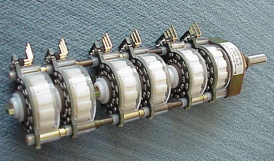

I have not tried the DACT, but several other high quality stepped volumen controls and even though they are sounding good they never filled the bill for me , as the discrete steps were too coarse. Brunos preamp and the lightspeed attenuator are sounding a bit better, but no by a wide margin.Koldby, did you try something like the DACT as well? I really want something I can trust to keep the balance right between the channels. The claims from the DATC are high.
I don't mind to get out of my chair, because I don't use the volume control that often during listening sessions, and I would not mind changing the digital volume in small steps. It's just when I use more attenuation, for instance a movie gets played less loud that music, due to the JRiver Volume Leveling not kicking in, I want an option to keep as many bits as I can.
Or if I want to play back at background levels I want to be able to attenuate without losing detail in the music.
I've noticed a big difference there, where the Goldmund sounded beautiful at lower levels, something I never experienced with the Pioneer. But the Pioneer already had the internal volume dialed back just like I plan to do with adding a pré-amp to make up that gain.
If the DACT is as good as they claim it is, I would be willing to fork out that price for admission.
I liked the basic thought of the simplicity of that devise. A DACT is claimed to have quite some precision:

When you sa " it can work with measured impulses" , do you mean a calculated impulse from a sweep? Is there a possibility for actual output of an impulse from REW?

To time-align sub with main (main fixed, sub delay changeable)
Align as A or B - never got that really... on the peak or on the start?
Super question imo 🙂
Get's at the root of understanding phase and timing....a question Wesayso helped me solve/understand several years back.
The simple answer.
Correct time alignment is when starts are aligned.
Not peaks.
The well noted problem is that our measurement programs key off impulse peaks.
And peaks get less and less defined, as high frequency response is taken away. Which makes defining impulse starts even more difficult than tagging peaks.
Ime, impulse responses are the wrong tool to use for fine time alignment.
They are useful as a quick start to get into the correct time alignment ballpark, by helping to remove excess delay.
But once that excess delay is removed, phase traces are an easier/better way to achieve impulse start alignments, than trying to continue to analyze impulse (or step, or group delay, etc).
When phase traces lay on top of each other as closely as possible through the xover region, impulse start alignment has been accomplished as well as can.
Aligning phase traces is a task that dual channel FFT's handle much better than sine sweeps, again ime...
They make better phase traces down low, since dual FFT allows continuous real time transfer functions. Temporal averaging of the continuous measurement can be used for very good stability and repeat-ability.
Even better, real time phase traces allow you align phase by having one section's (say sub) captured trace up on screen, while measuring the other's (main) trace in real time, and simply dialing processor delay on the leading section until the phase traces overlay.
After using the match phase trace method, I've used REW to confirm and peer into bandwidth filtered impulses like in Wesayo's good explanation.
All jives together fine. Both methods work.
But wow, is dual FFT easier. just another fwiw 🙂
Interesting and affordable suggestion... here I was only looking at volume controls like this:
Simple, basic but expensive...
Wow ! and yikes ! I couldn't imagine doing something like that.

I guess i was going yikes about the multi-pot, because I've had more trouble with pots going crusty over time, than any other problem with high-end home gear. Conrad-Johnson, even Manley. (I don't live in a corrosive environment)
But sorry if i yiked out of place 😱
