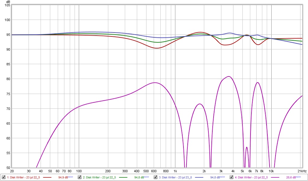

As this thread is worthless without pic's (or more data points) here's a graph of the preliminary mid-side EQ:
click to see the bigger version
The red line is the mid part of the EQ.
The blue line is the actual side EQ applied.
The green line is what the left ear gets from a side panned signal.
The purple line is what the right ear gets with a side panned signal.
See how this stuff isn't and will never be totally transparent? All EQ shown here is of the linear phase kind. The purple part needs even more explaining. We see a number of peaks, but they are not all of the same polarity. The bumps at ~600 Hz, 3700 Hz and 7200 Hz are inverse signals. Remember how I liked the JRiver Surround Field Medium Enhancement? Lets see what that signal looks like:
Now it may make more sense. This is the side panned sound only. The Stereo mid sum looks exactly like the red line here, but here in this graph it is representing the result at the left ear from the Surround Field enhancement.
The opposed channel (or ear) gets the green line. An inverse copy of the left channel.
So what I did with the mid-side EQ is copy the good parts of the Surround Field effect at the frequencies where the cross talk bleed sums favorably.
This makes the virtual sound source "seem" to come from the left, instead of the actual speaker location on hard left panned sounds. Mimicking a sound as one would hear it coming from the left.
The Surround Field effect by itself is fun by itself, but the combination of the mid and side EQ as shown here is a more subtle and tonally correct version of it.
By no means do I declare this work in progress as finished, but I figured to show what it is I'm doing, so some may try to copy it for themselves. This is merely an in-between plot. It shows me there's room for improvement.
Should I write more? For instance how to make/check these graphs? Is there any interest in what this is all about? Just let me know...
It is remarkable how this all sums at our ear(s)... if we apply the cross talk with head shading etc...
The side EQ isn't really applying a boost or a cut, it is merely shifting energy from one channel to the other. However the sum at the ears does not change all that much, but how it is interpreted in our brain does!
Enough riddles for one night.... 🙂

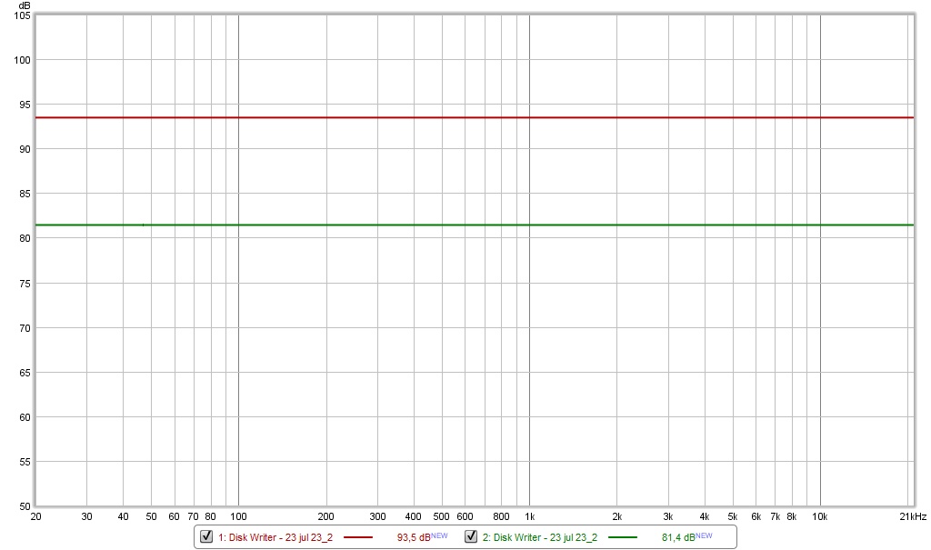

** disclaimer ** The level tweak of the upper mid/side EQ plot is a general +2.5 dB boost in my mid-side EQ plugin... it has nothing to do with the actual level differences between the left, right or phantom parts when compared to the surround field (just add a bit of boost to both lines in the bottom chart to adjust for this difference). Searching this thread on 'Surround Field' should present my earlier reverse engineering attempts of what is happening there.

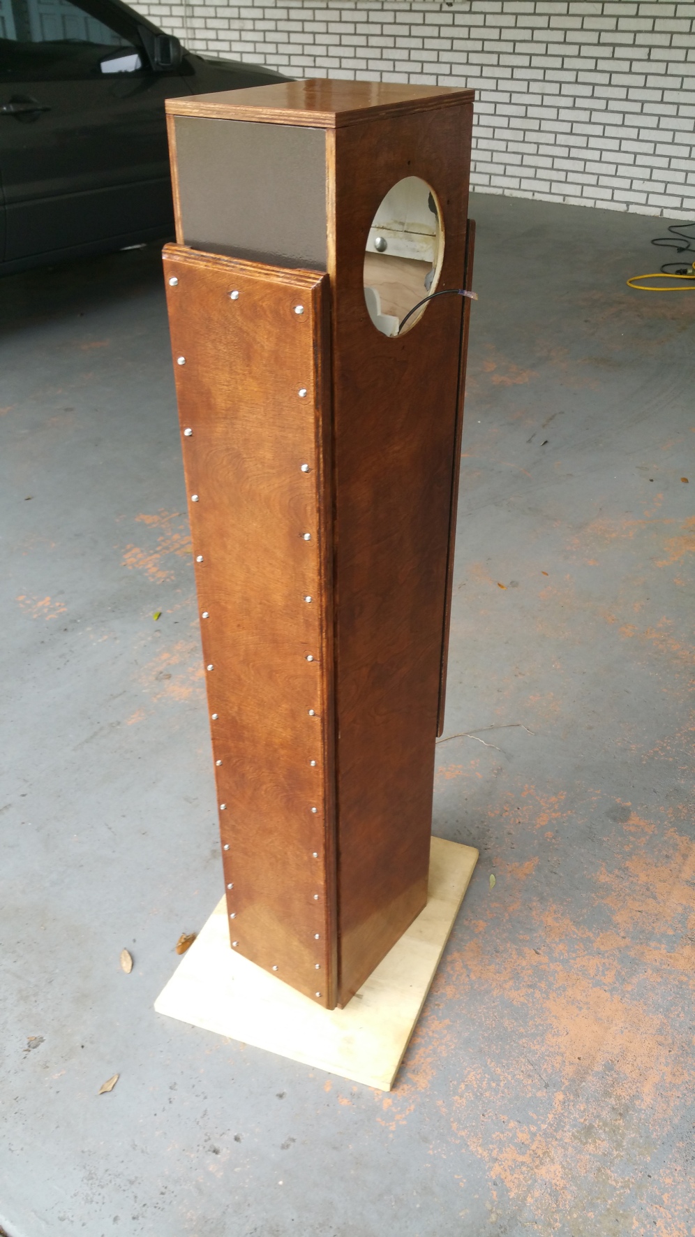

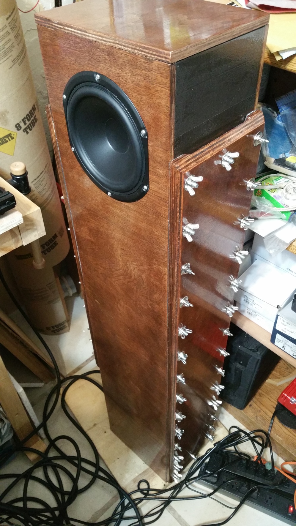

btw have my New force oppossing MLTL prototype built. It has removable side panels for interal access held on with 52 Hurricane wingnuts. Need to run some tests, but as is appears to defy current TL theory, thus why its built as is. Its an experiment that requires ample headscratching
Doing some upgrades atm. Juzt replace my laptops 1tb hd for an 860 EVO 2tb ssd that runs aside an 970 EVO M.2 ssd used as boot.
More upgrades to my CR-10 S4 3D printer. New E3D V6 hot end, auto bed leveling, new PS/ Display and latest dual extrusion motherboard. New magnetic bed build from Wham Bam System, I was on their Kickstarter. More items coming, Hoping to have done in a week. Have some waveguides to make
EJL TL

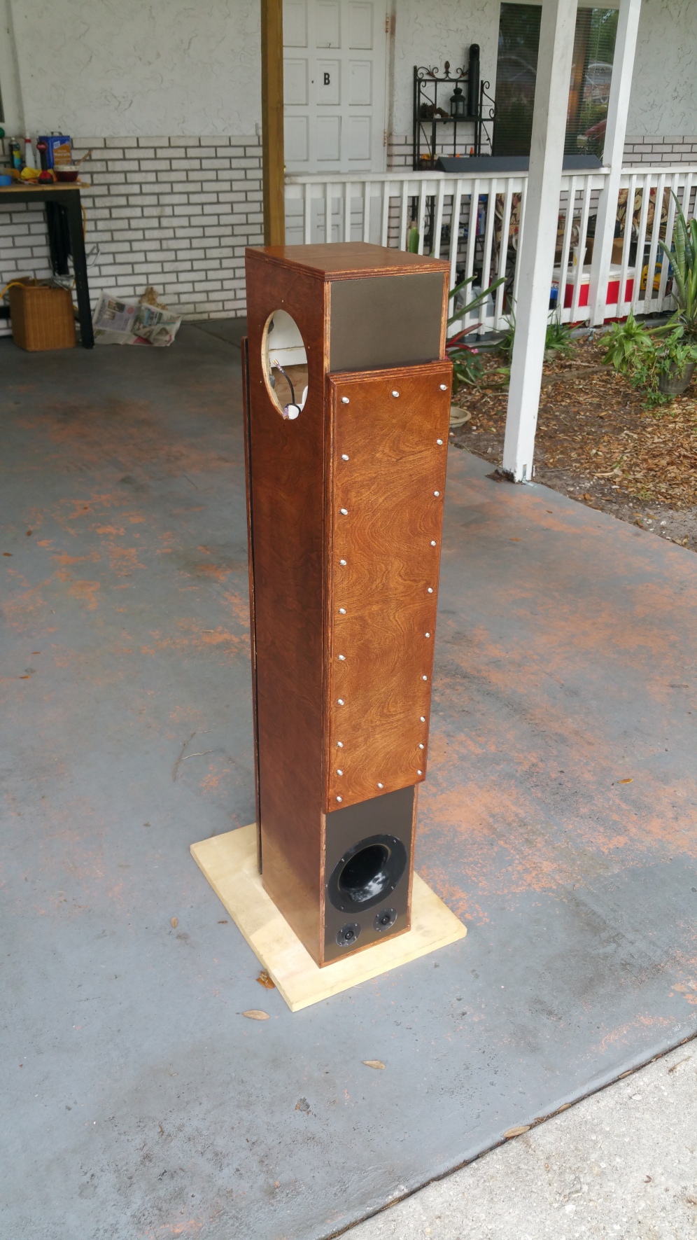

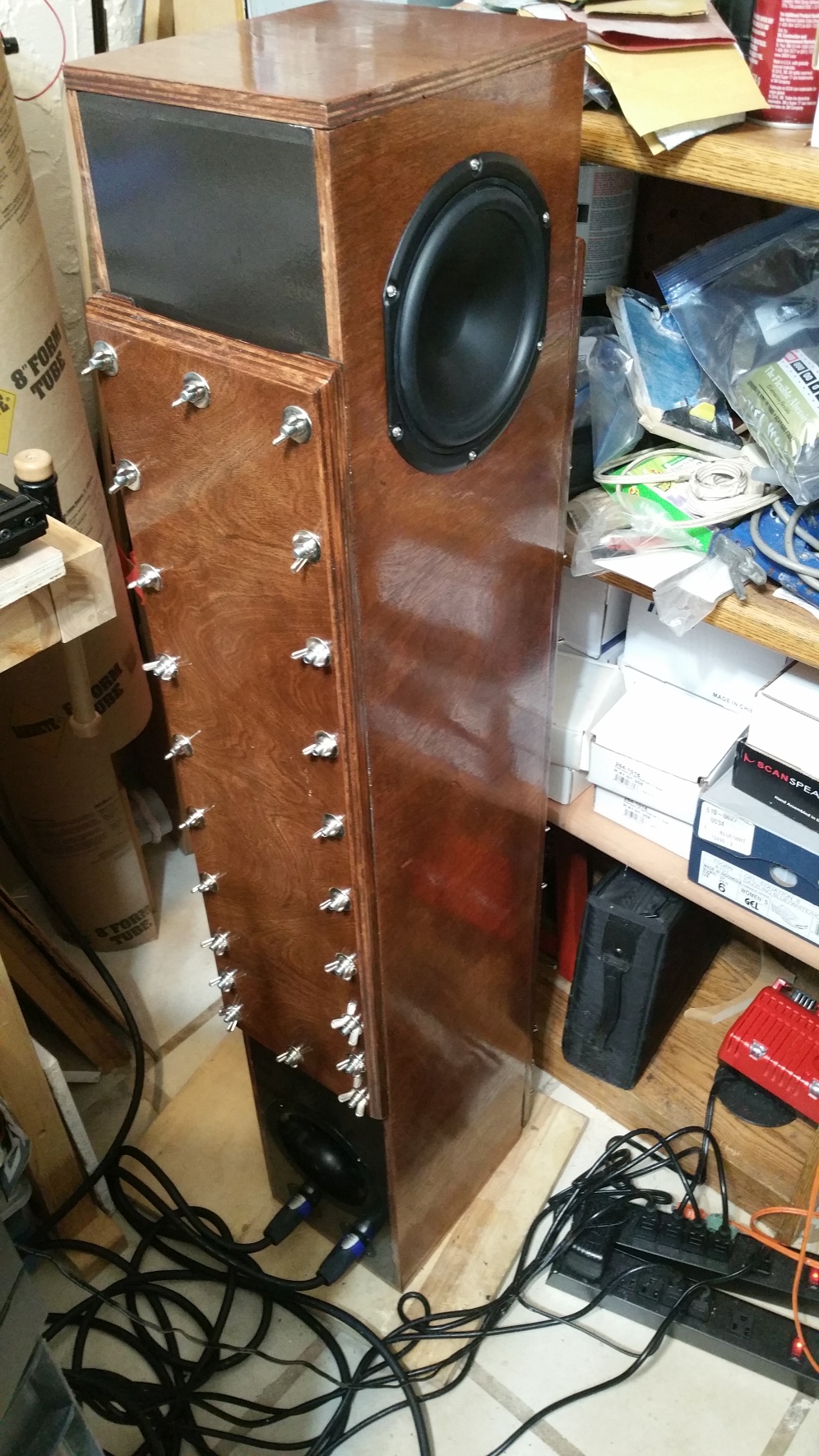

Couple of pics. Still yet to cut the plexiglass windows into the removable panels. Works well to 26Hz
If this pans out (and I think it will nicely) would not require wingnuts or windows, but would require 4 of these. Configuration of either flanking or stackable so two is like ~7'6".
