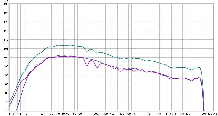

...From time to time I've had a little help(er)...
All Along The Watchtower ...

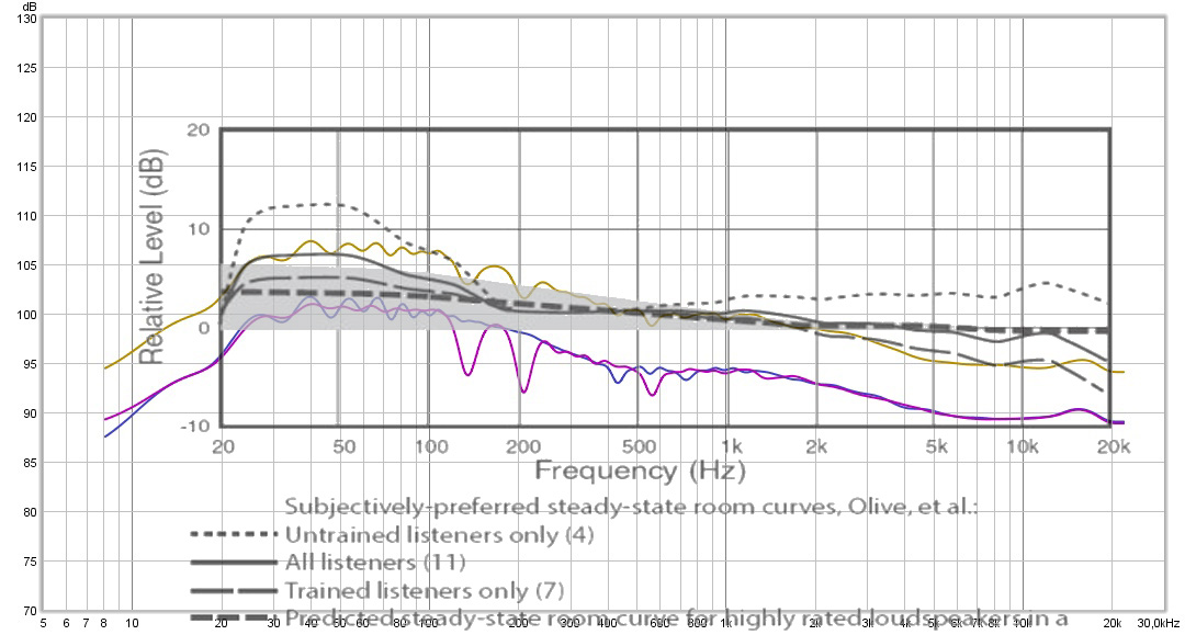

While there are slight differences, I'm still quite close to the JBL curves (I guess I like a little more bass)
Plots of left, right and their sum, gate set at 25 ms and smoothed with Var smoothing.
The left and right timing in charts:

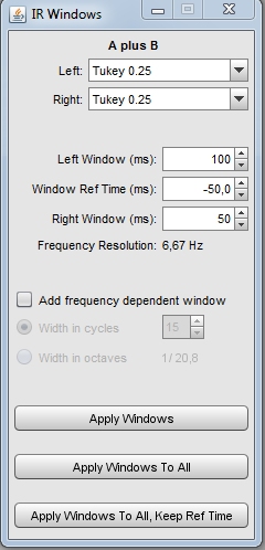

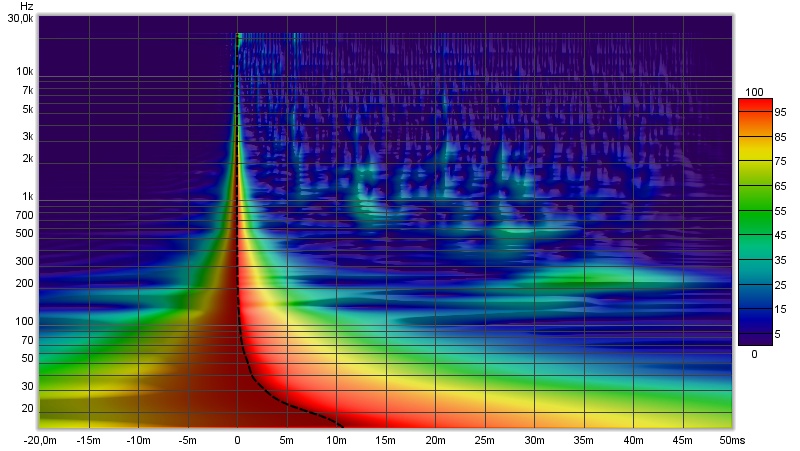

And here is a 6-cycle window in REW:
Which makes it more obvious that I use the longer (gated) window to adjust left/right (tonal) balance and use DRC primarily to get the best early wave front I can get. Without going overboard trying to fix nulls (which should be fixed in the room). Easy to spot the right side still has some room effects that mess with it, sadly no more damping panels for me or I'd get in deep trouble. Hopefully the subs let me fix some of that.

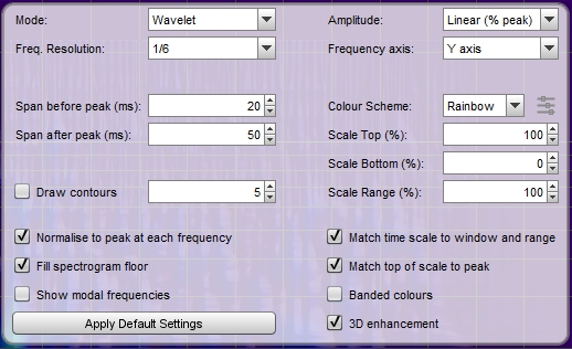

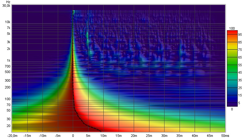

are those REW spectrograms back in post 5008? If so, what were the controls?
My spectrogram is nothing like those, although it looks better with shorter windows. I've got echos coming full spectrum for 300ms and past the 1sec window REW looks over down low. (I think you already pointed that out)

Yes they are. These are plots that resemble the way APL_TDA shows it's plots. I've nagged John about it for a long time and at a certain point he caved in and just included it (*). I find them handy to view the timing. I'll show the parameters I've used:
As said, primary use is timing, nothing more, nothing less but it does show pré ringing and the room as well, be it that the focus lies on the peak.
Very comparable to/compattable with APL_TDA's way of showing the timing.
The plot a few pages back with a comparison between a Danley horn and the array were not done with these numbers! No normalising was used for that one and it showed SPL in dB, not in percentage. So that's using these wavelets for quite a different goal.
(*) In all honesty I can't even say if I played any role in his choice to add this feature but I did ask and discuss this feature with him a couple of times.
In this thread he showed early results which developed into that neat feature.

For anyone interested on what they get pré peak or in other words: pré-ringing: Use REW's IR windows with these values:
If you don't use any smoothing, it will show what happens before that first peak. Sort of a sanity check for those manipulating phase.
